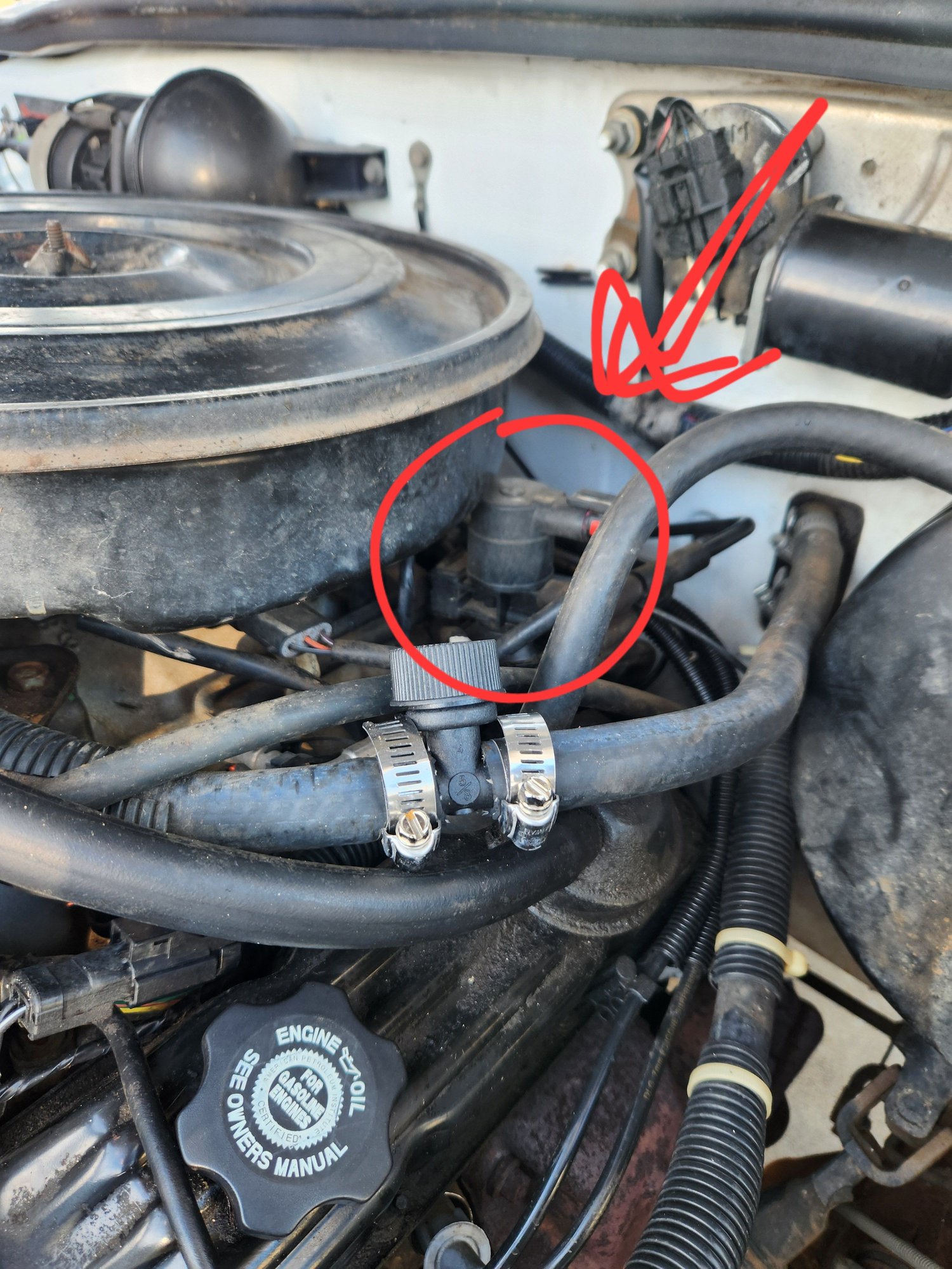

All connections are good on the back.....I'm going to try and find a cluster to swap and see.....also, what is this.....is making a noise, like surging/thumping sound.....thanks
Old Jan 22, 2024 | 02:09 PM
Posts: 87,400
Likes: 4,214
Don't know on that, should show up on the vacuum diagram though??

That thing looks like the vapor canister purge valve.

That's what it is.....I've read the "clicking " sound I'm hearing is normal, and I've read its not.....don't know which, lol
It's a 'duty cycle' solenoid. So, the clicking is indeed normal.
Charcoal canister purge valve.
