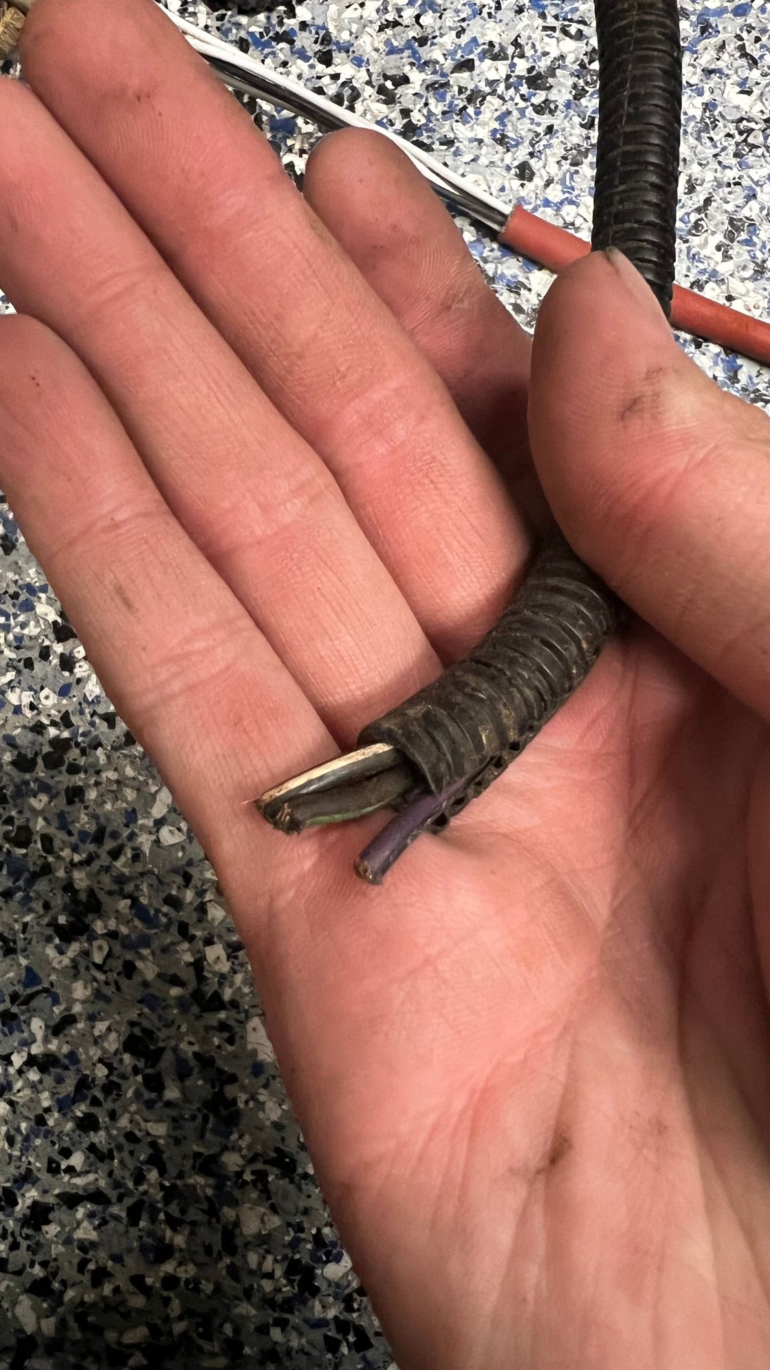

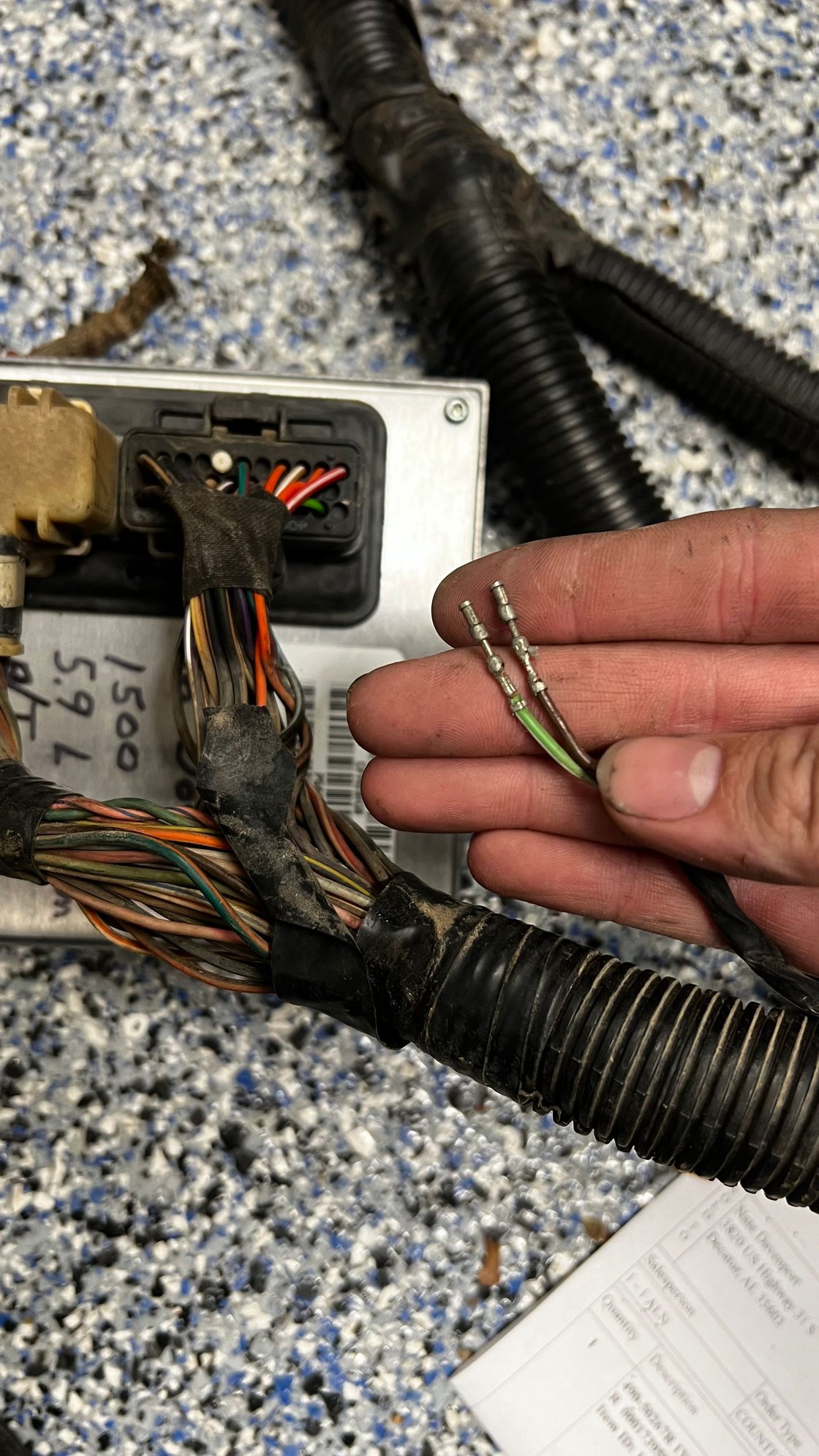

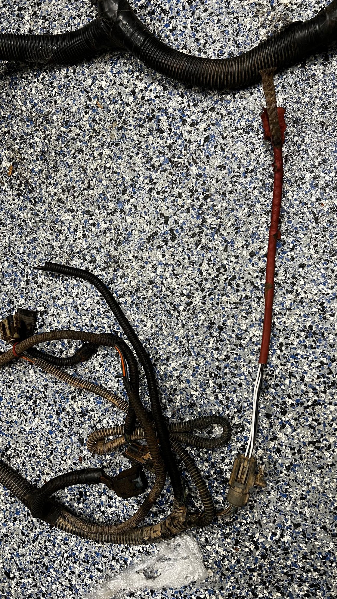

Alright gents, finals are over and I’m back home for the summer and got to look at some parts that have trickled in, mainly looking at the ECM and harness I bought. I bought a 96 ECM, and a 97 harness, both from a full size AT. The harness has some connectors missing, which was noted on the listing but no idea what these connectors were. Hoping some pictures would help someone with more knowledge of these harnesses help me figure it out. I’m colorblind, so using a diagram plus having faded wires would be my last option lol.
Here’s a Birds Eye of two connectors that are missing. The one off to the right and there’s one with 4 wires to the left. Closer picture of those cut wires below.
4 wire connector here
This is right next to the PCM, not sure what this would go to.
There is also a cluster of big connectors, I’m assuming those go to the trans? There are 3, square, rather large. I neglected to take pictures but the trans is my best guess. Given I’m keeping the 5 speed, is there any pins I can jump to keep the CEL off for the trans?

Oh, that's gonna be fun....... You may end up having to actually install the harness, see the missing connectors are close to, that doesn't have it's electrical connection.... There are diagrams in the service manual that show connector locations. Might be able to figure it out just by proximity to other connectors. It *look* like they are all the same branch of the harness as the O2 sensors? Maybe??
The large square connectors are bulkhead connectors, for the stuff in the cab.
You will have to have the PCM re-flashed with a manual trans tune to keep the CEL off. Can't fade what some of the sensors would be doing.

Gonna need to look at pinouts for both sides of the bulkhead connector, and see what goes where, and make sure they match. For the diagnostic connector, probably need to grab that section of the harness from a donor.
