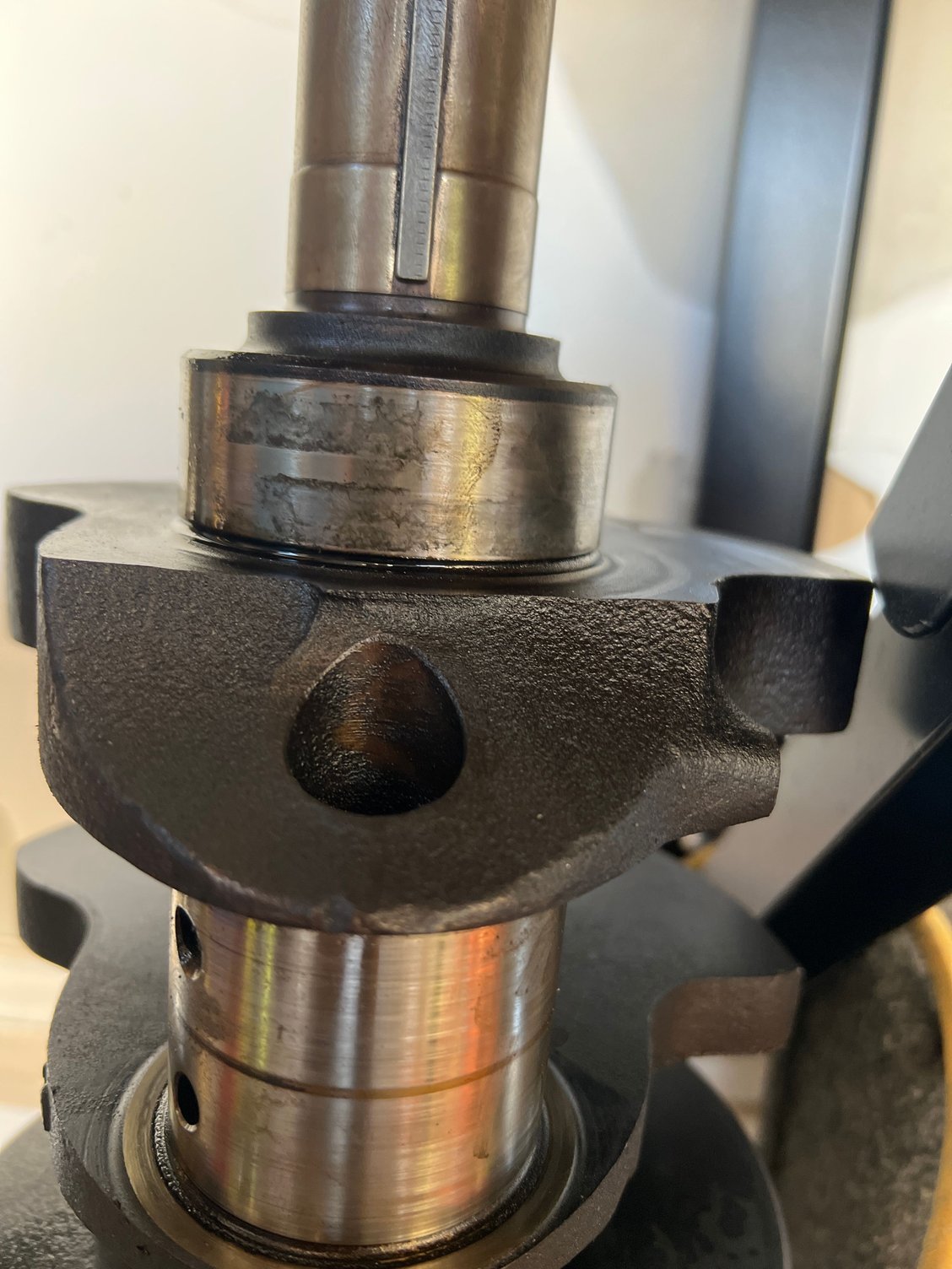

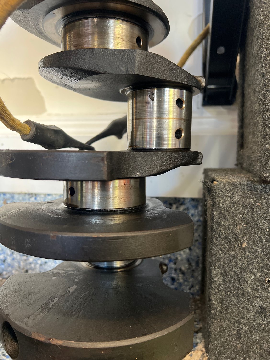

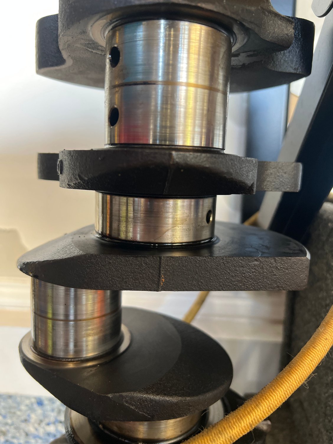

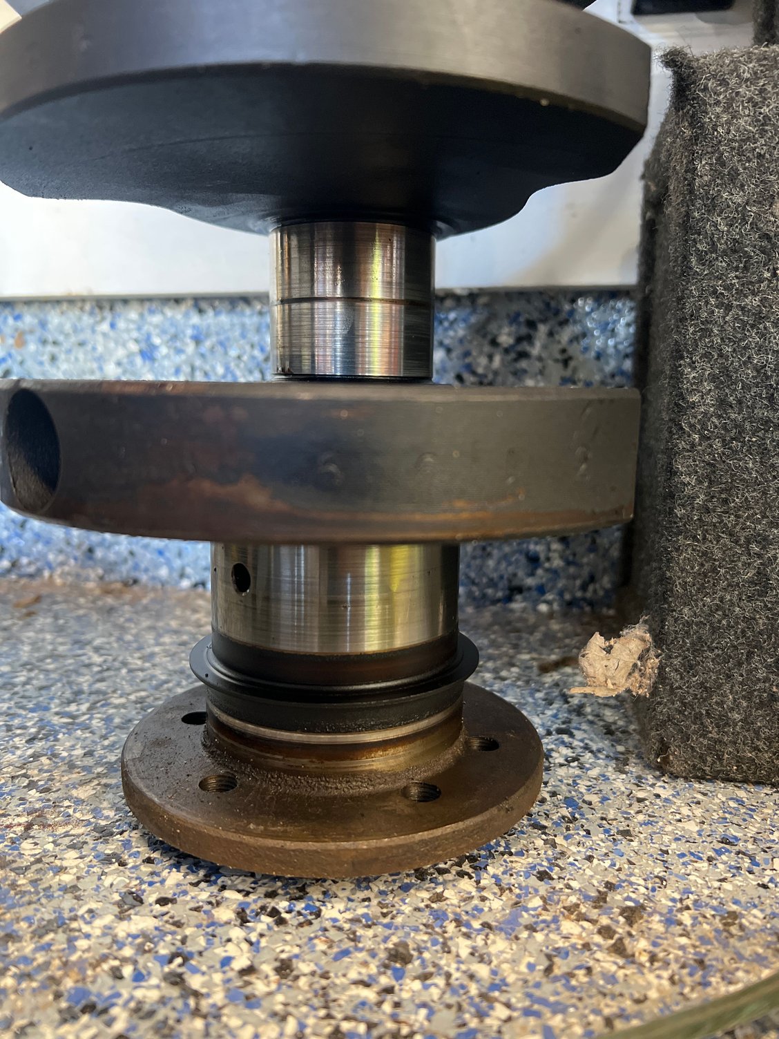

Do you think I can get away with a DIY polish on this crank and save myself $400? Doesn’t feel rough via the finger test

Use some REALLY fine grit emery cloth on 'em, clean 'em up a bit, install it. I have put bearings on worse looking cranks. Wouldn't hurt to mic 'em out, if you have the mic...
Sounds like a plan, would save me $390 for a new crank, or $360 to turn it. I may or may not go buy a mic, but given the mileage, and the fact that there is no obvious signs of abuse or spinning, I think I should be fine to run it.
