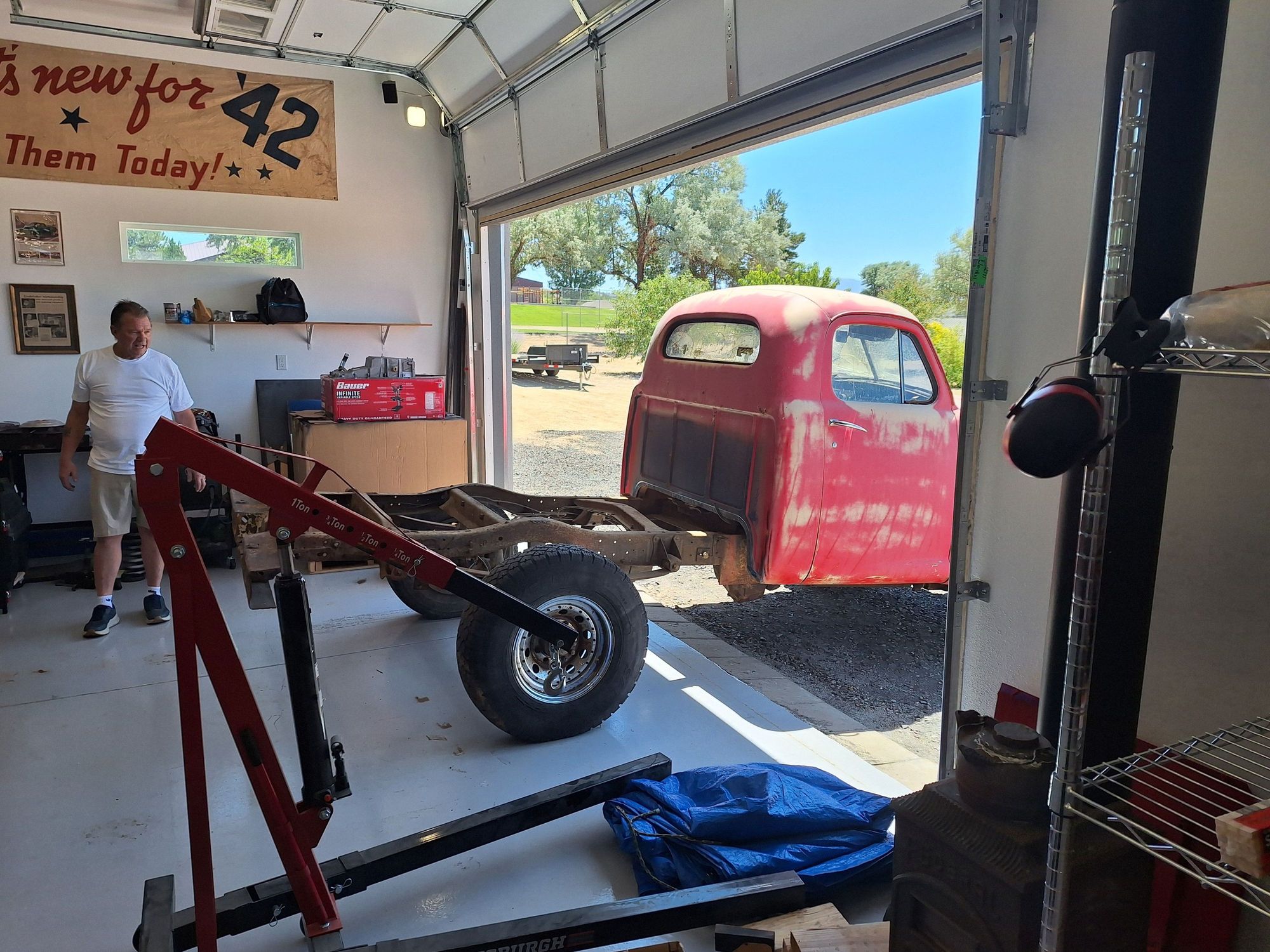

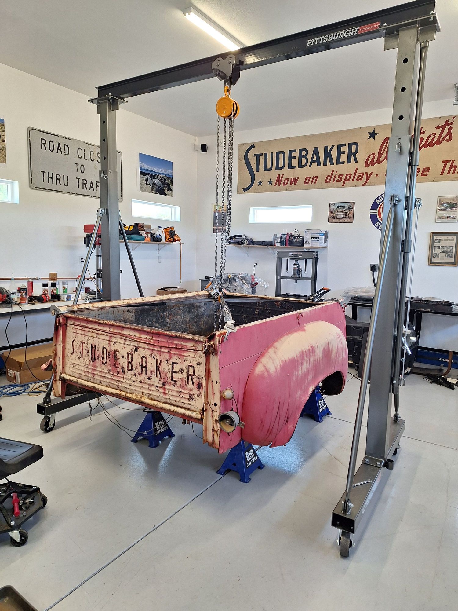

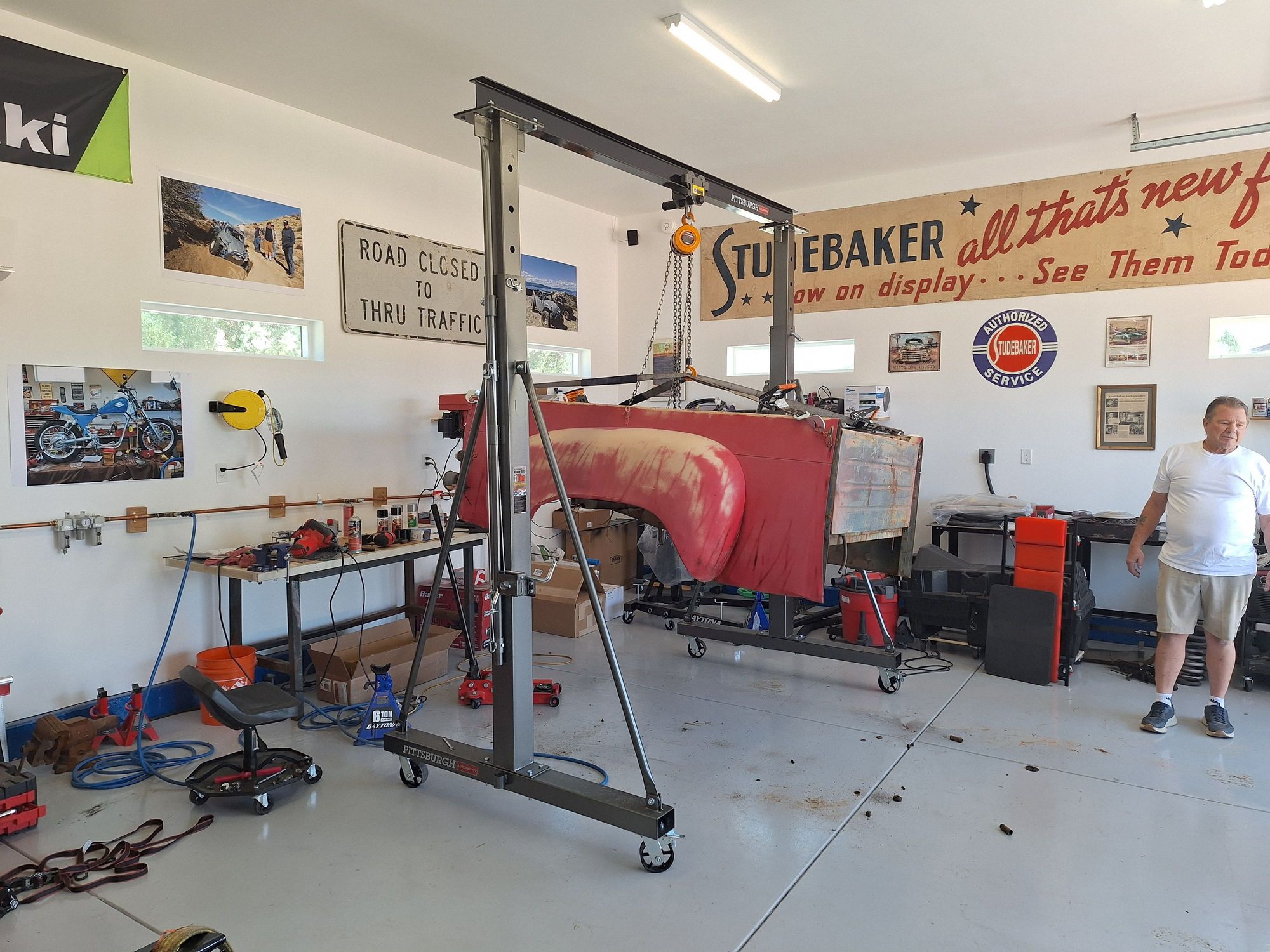

A wild hair was discovered this morning, and I put it to good use! I had a neighbor help me out. We got the bed removed, and did a quick test fit to see what could be in the way. The upper shock mount cross member will need to come out. It is definitely time to start doing the rear half of the chassis. Boxing the frame rails, making the fuel tank mount, putting the 4 link rear suspension together, and fabbing the bed mounts. With the temps in the mid to upper 90's for the next couple months, all grinding and welding will happen in the early mornings. Outside on the shop's driveway.

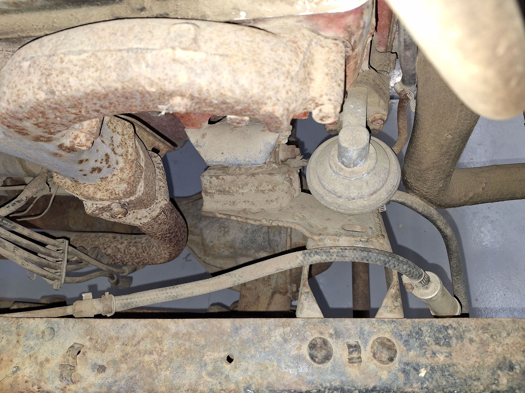

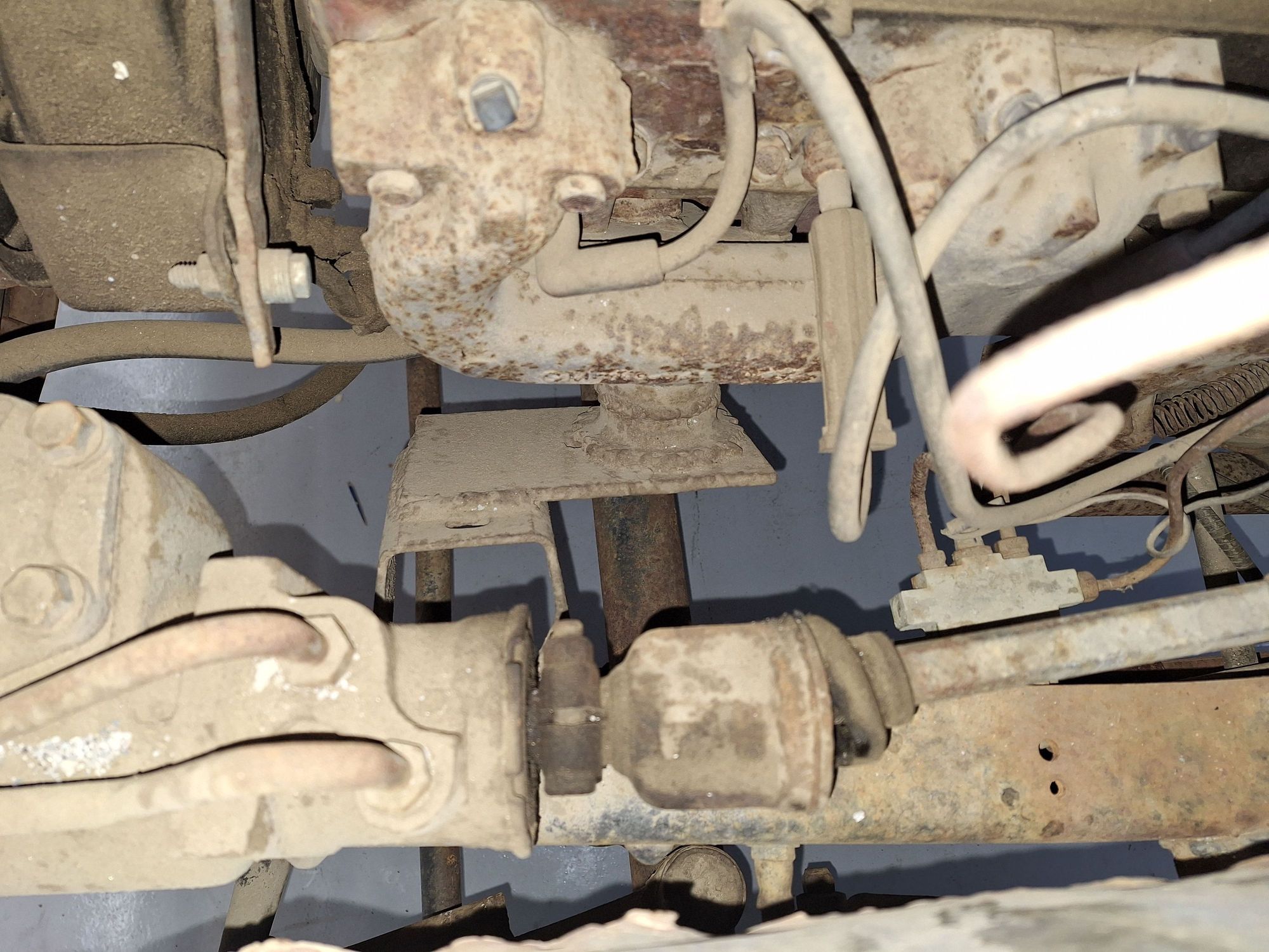

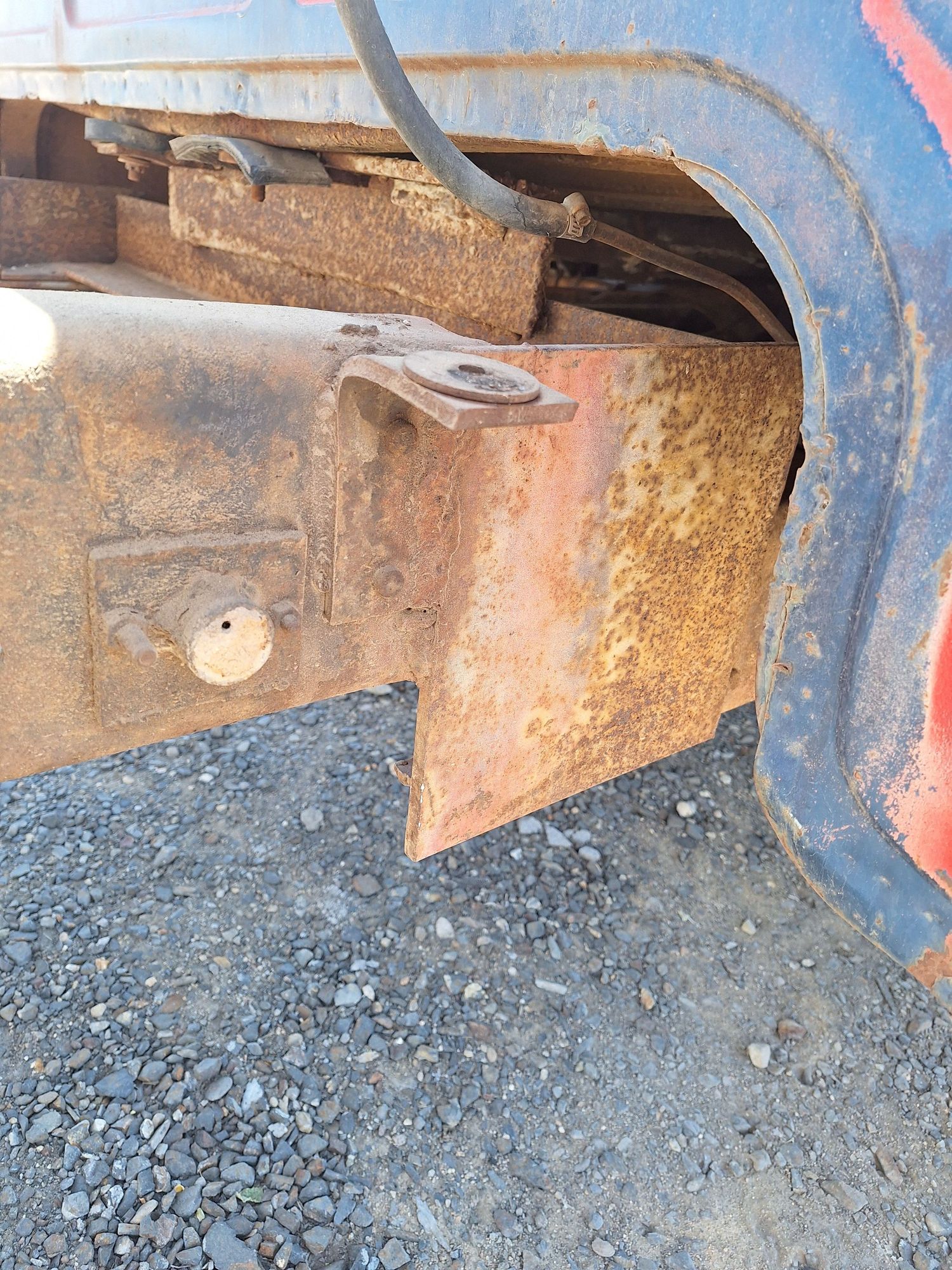

I mentioned earlier in this thread that the truck came from a farmer in Idaho. The closer you look, the worse it gets! From the chassis shortening (hacking!), to the custom motor mounts. This 3/4 ton 4wd chassis needs to be scrapped. I was hoping to sell it as a roller, but the only things I could sell in good faith would be the front and rear axle assemblies, the trans, and transfer case. I have a hard time thinking anyone would think these mods would be road worthy! Some people should not have access to a plasma cutter, or a MIG welder!

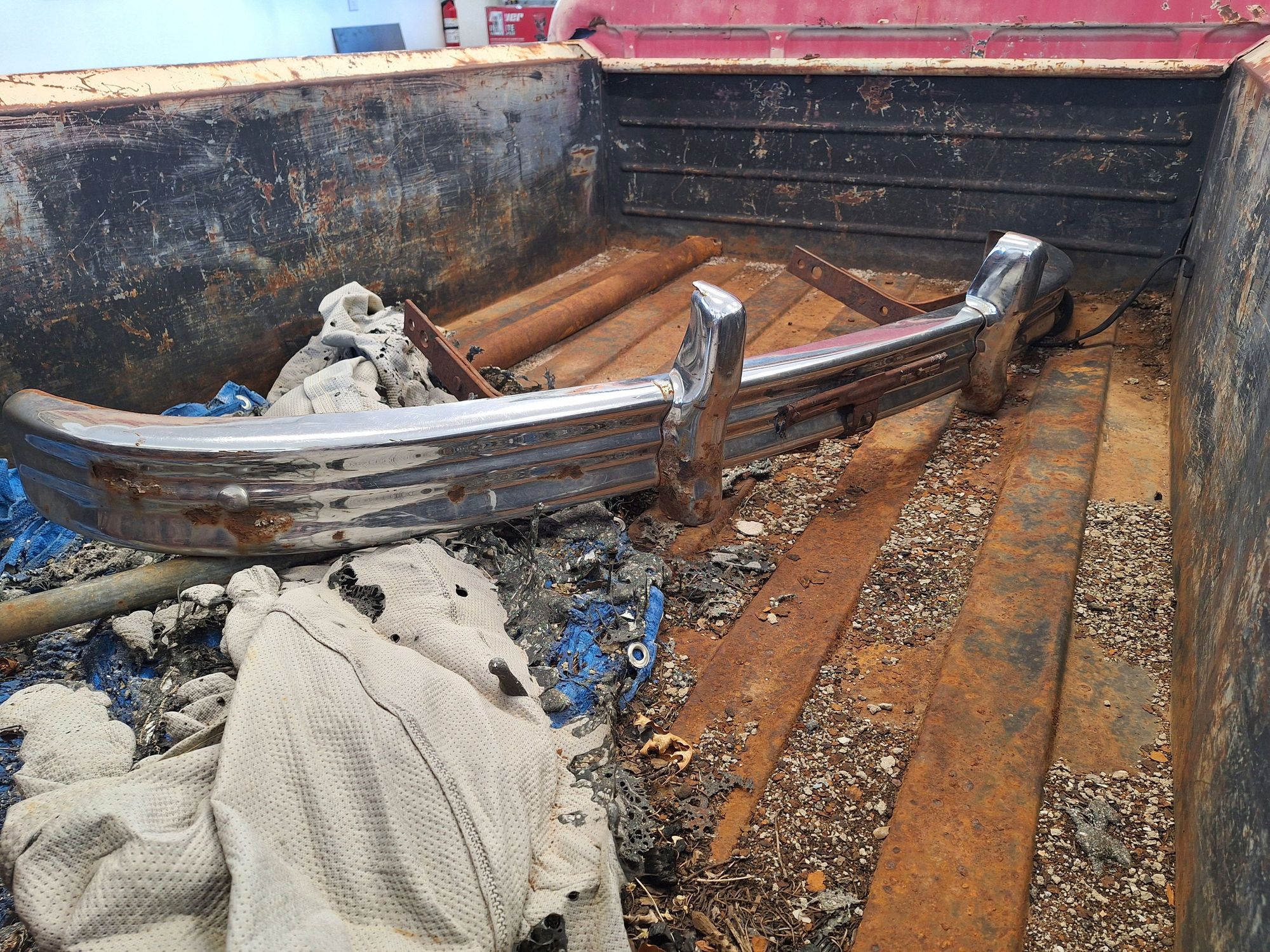

When I brought this truck home (from under a tree in southern Washington) it had a front bumper sitting in the bed. I knew right away it didn't belong to the Studebaker. So I took a picture of it, and over several cups of coffee, I started my internet search to determine what model car it came off of. It took several hours before I finally found it. I plan on adapting it to the front of the Dakota chassis. Anyone care to guess what car it is?
