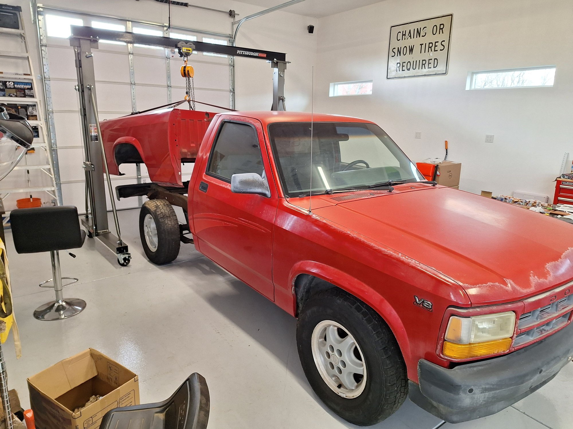

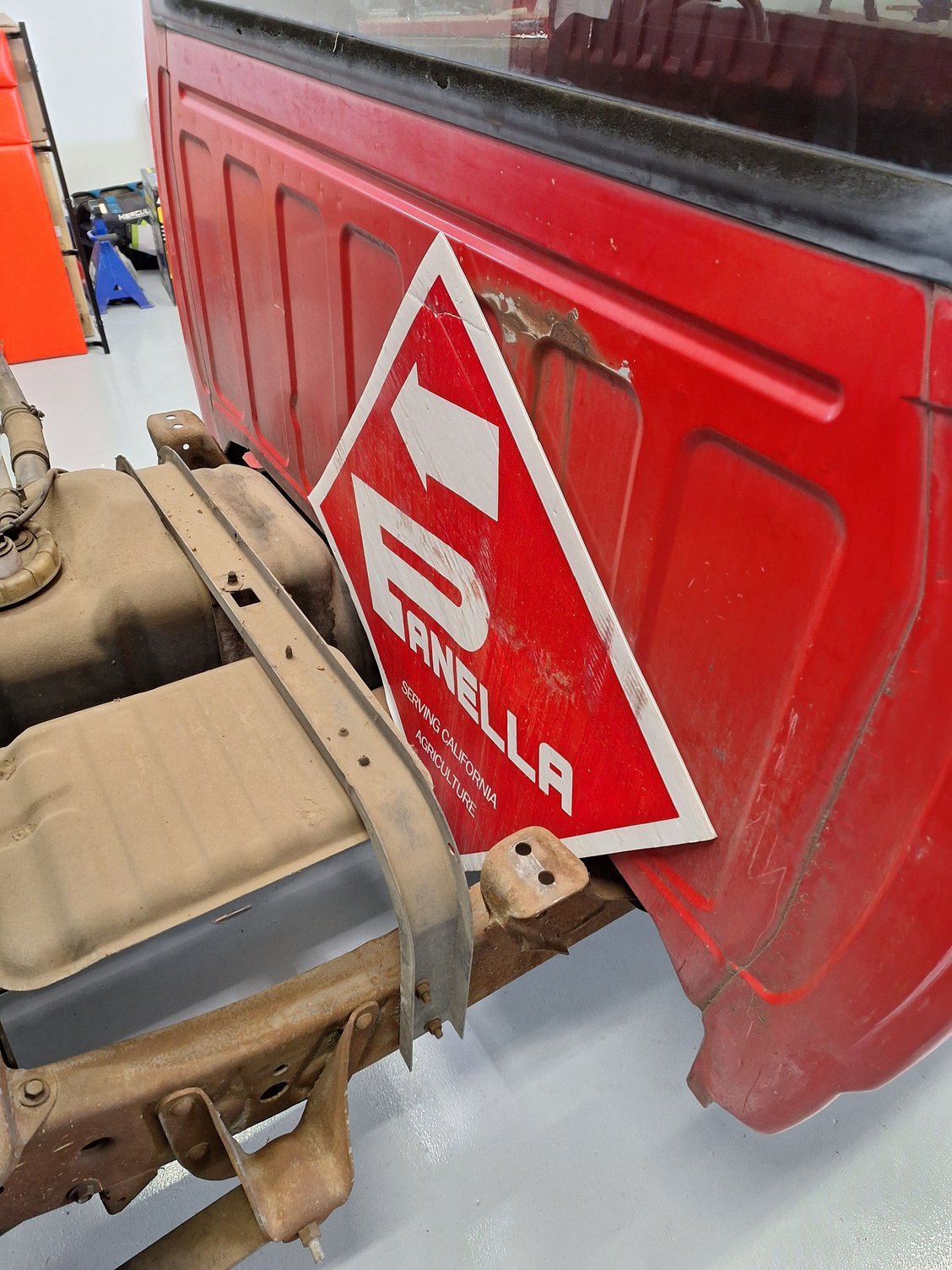

And so, it begins... (again) The bed is off. I found a little surprise lurking between the bed and cab. Too bad it's not a metal sign, just a foam board one. I have to admit, I am a little compelled to hang it up in the shop.

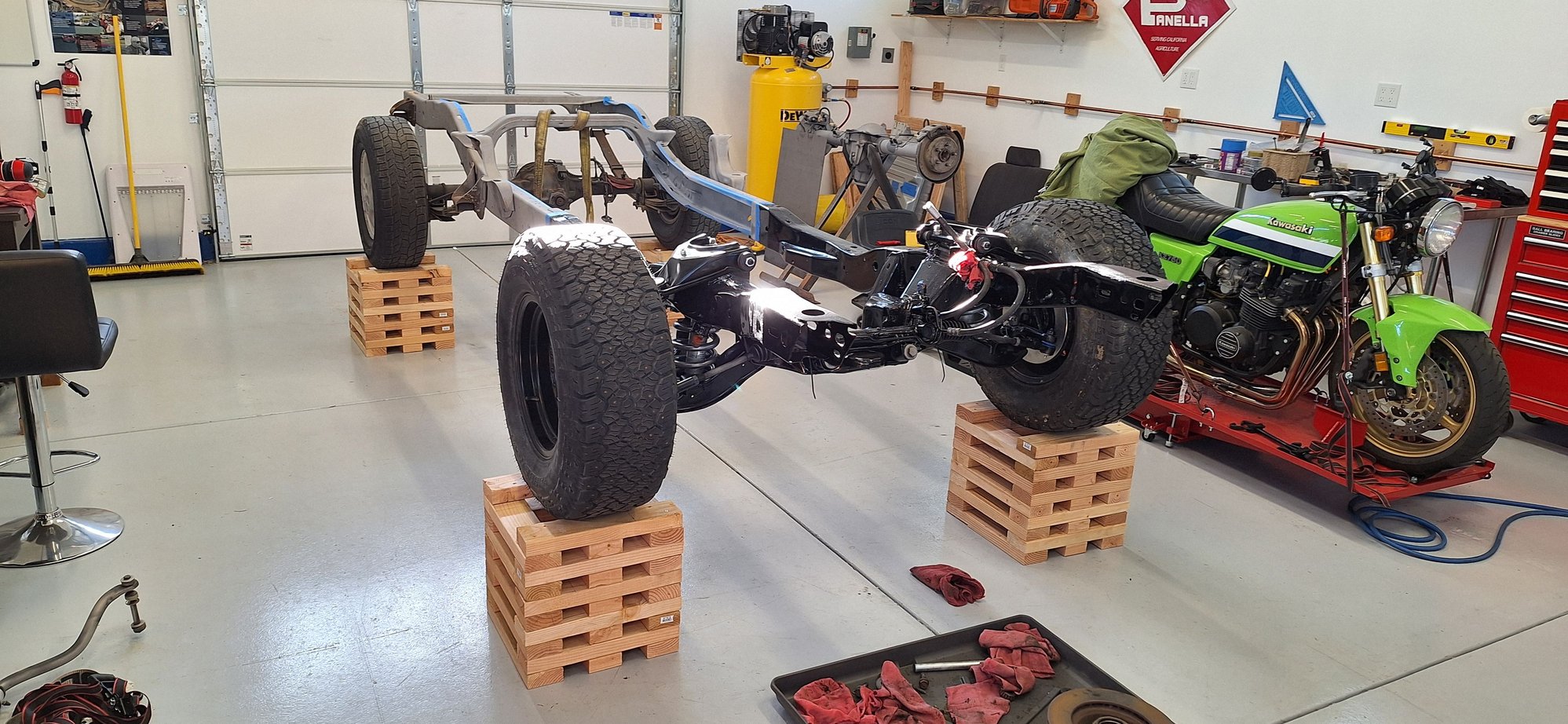

I have finished putting primer/sealer on the inside of the frame rails. I also started to make some wheel cribs. Around $100 in materials, but very labor intensive. 120 cuts of 2x4, and 100 screws per crib. These will lift the chassis almost 16" off the floor, while keeping the suspension under load. Much easier to access all the welding for boxing the chassis rails, and less bending over (important for us old guys!). It will also keep the chassis straighter during welding.

I finished the wheel cribs today. 15.75" lift.

That's gonna make working on it SOOOO much more comfortable.

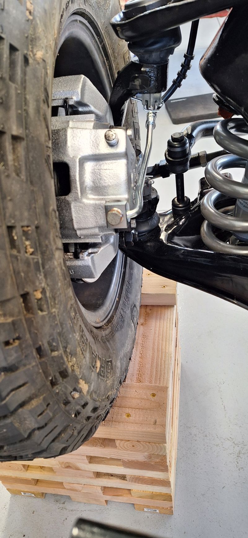

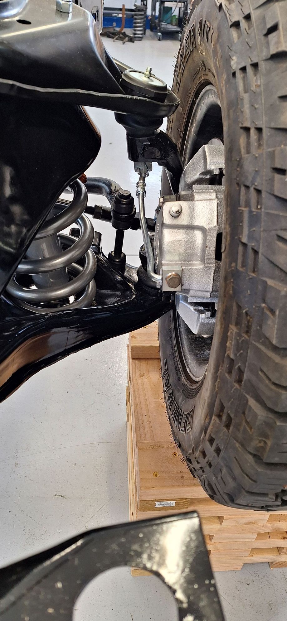

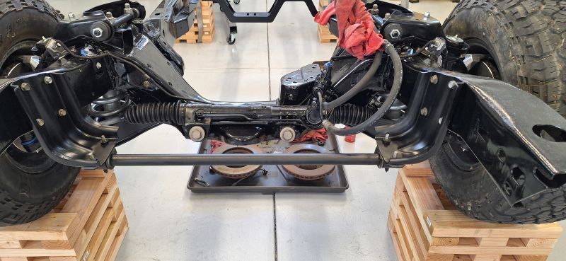

I finally completed the front suspension today. I got the sway bar, and all it's mounting brackets painted and installed. I also got all of the front brake lines installed as well. I also put in the Hooker Blackheart cross member. I am ready to test fit the engine and trans, so I can finish making the motor mount adapter plate for the driver's side (passenger side is already done). I like the way this cross member is designed to help tuck the exhaust up instead of hanging down.

Lookin' good.
