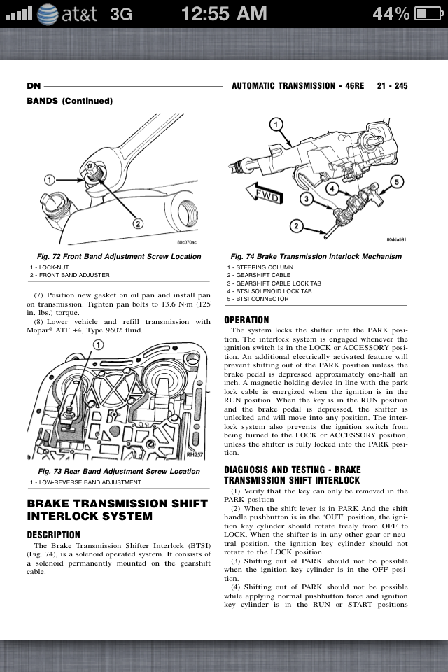

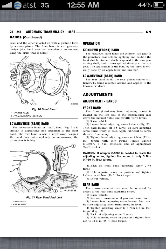

Any write ups on how to check and or adjust the bands?
Old Feb 15, 2011 | 12:30 AM
WhiteWidow00's Avatar
WhiteWidow00
Joined: Jun 2010
Posts: 1,743
From: St. Petersburg, Florida
Why yes there is! But first which engine do you have because there's 2 transmissions...
If you have a 5.2L:
https://dodgeforum.com/forum/1st-gen...ment-44re.html
If you have a 5.9L:
Size:  252.0 KBName:  photo-39.png
