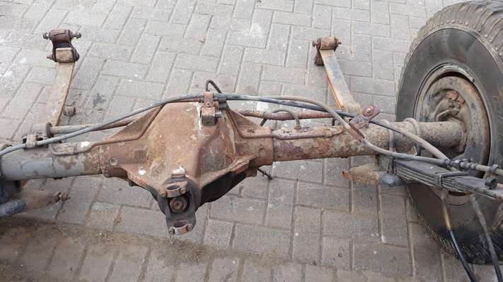

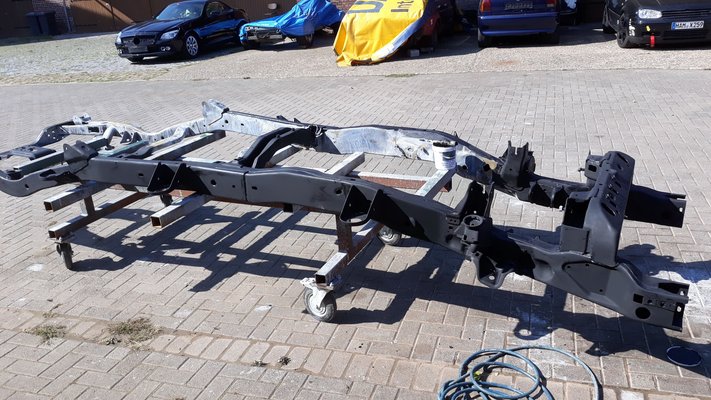

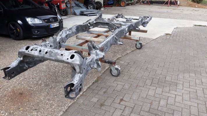

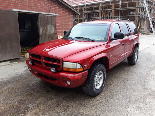

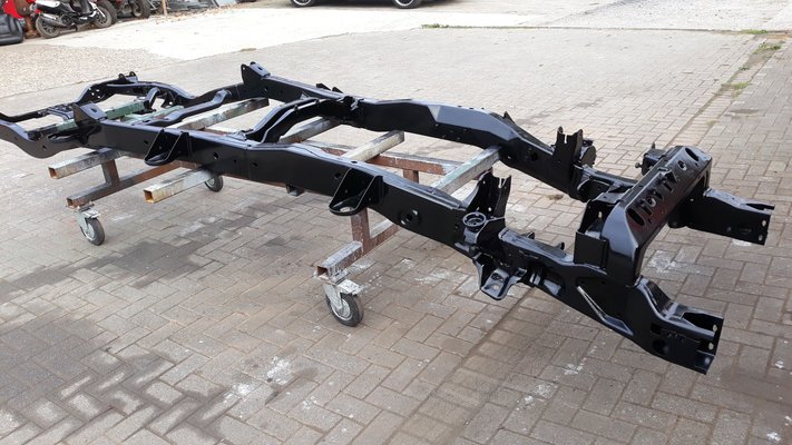

My name is Jürgen, I'm from Germany. sorry if i write bad english, but i think you can understand it.
I bought a Dodge Durango 1998 5.9L Magnum to restore.
He was already pretty rusty, but now he is like (better) than new again. Here are a few pictures of my Dodge.
I break the Doge down to the last screw. many pictures show the condition before and then afterwards.
I think the engine technology is great because it's so simple
All parts were cleaned and wear parts replaced
