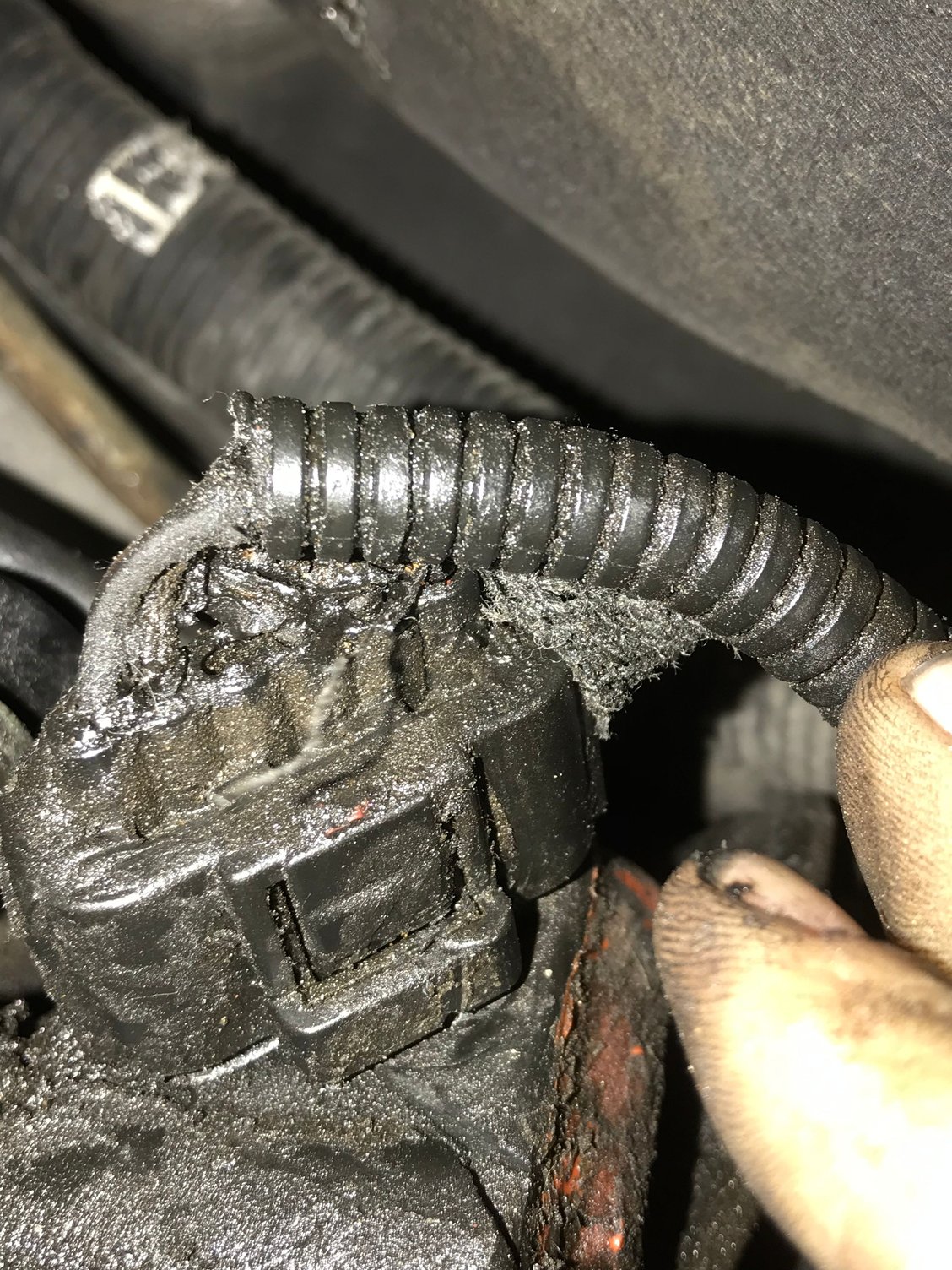

so I finally had a chance to try this out. Do I keep the truck running while doing this? Because I disconnected it and the truck wouldn’t even try to start. No click or nothing. And it was 8 pin. It was a 6 pin connector but only a total of 5 wires. I took a picture.

The 01+ trannies have different wiring than mine, but sounds like you unplugged the range sensor for the dash indicator. Probably wouldn't start since it didn't know if it was in park or neutral.
