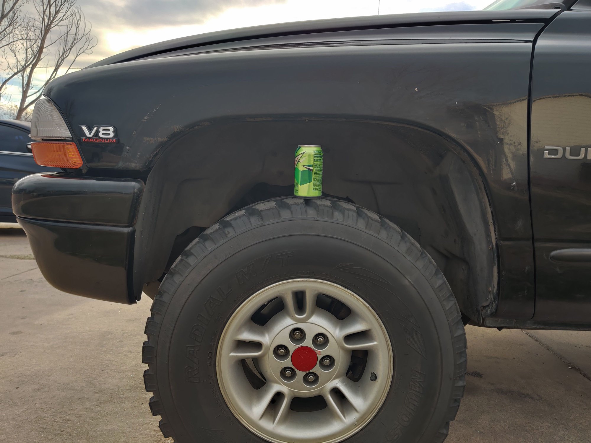

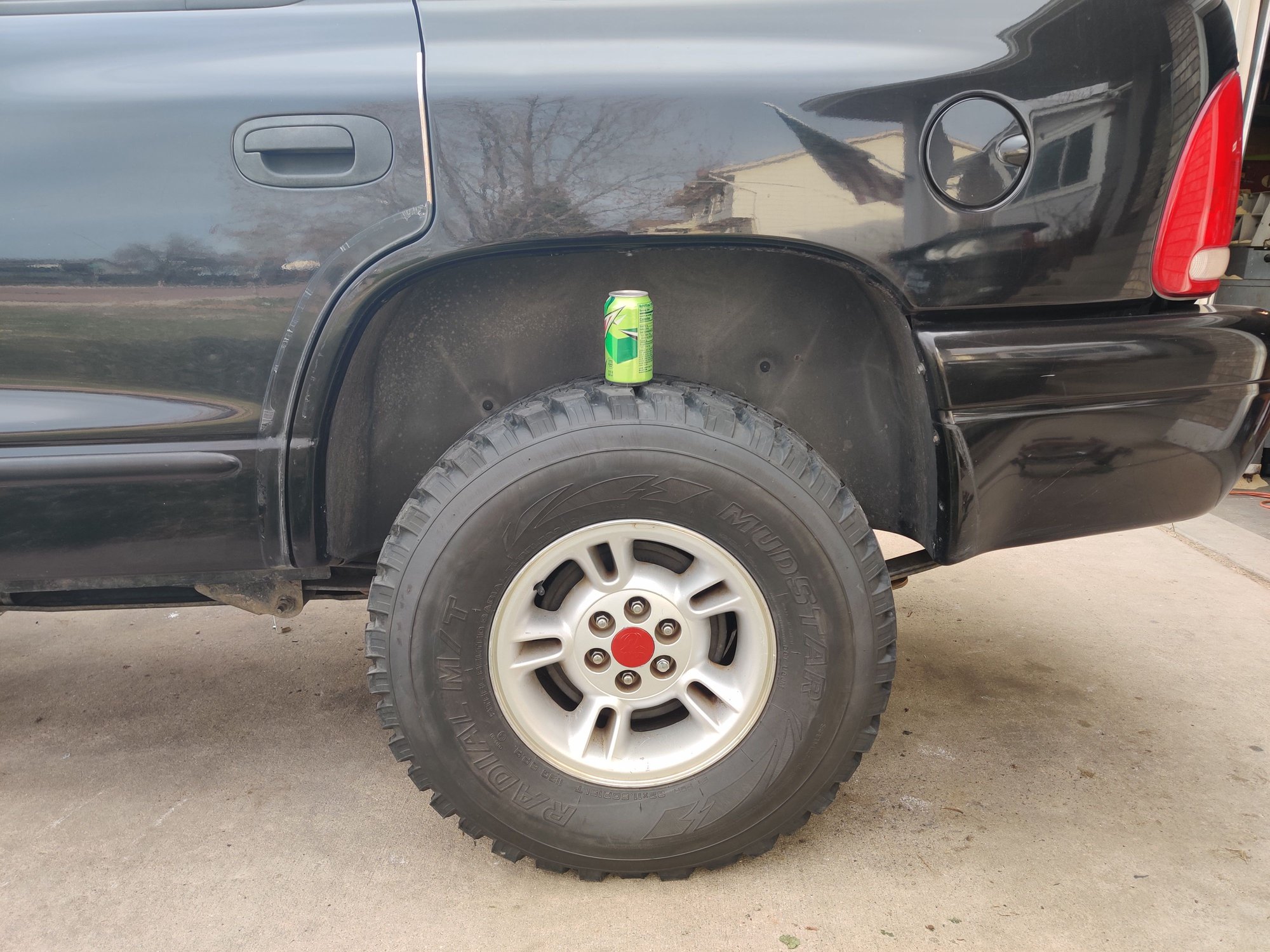

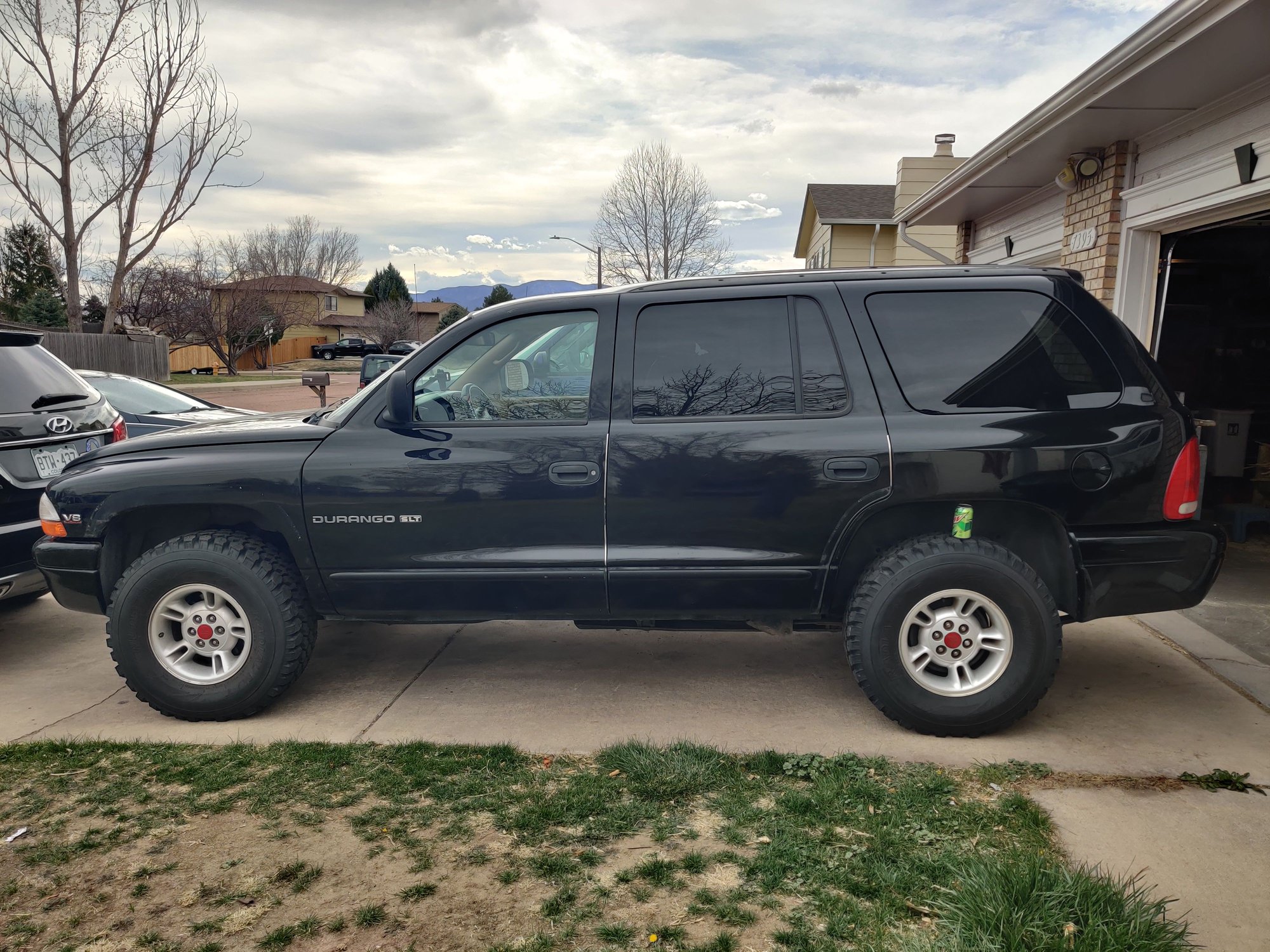

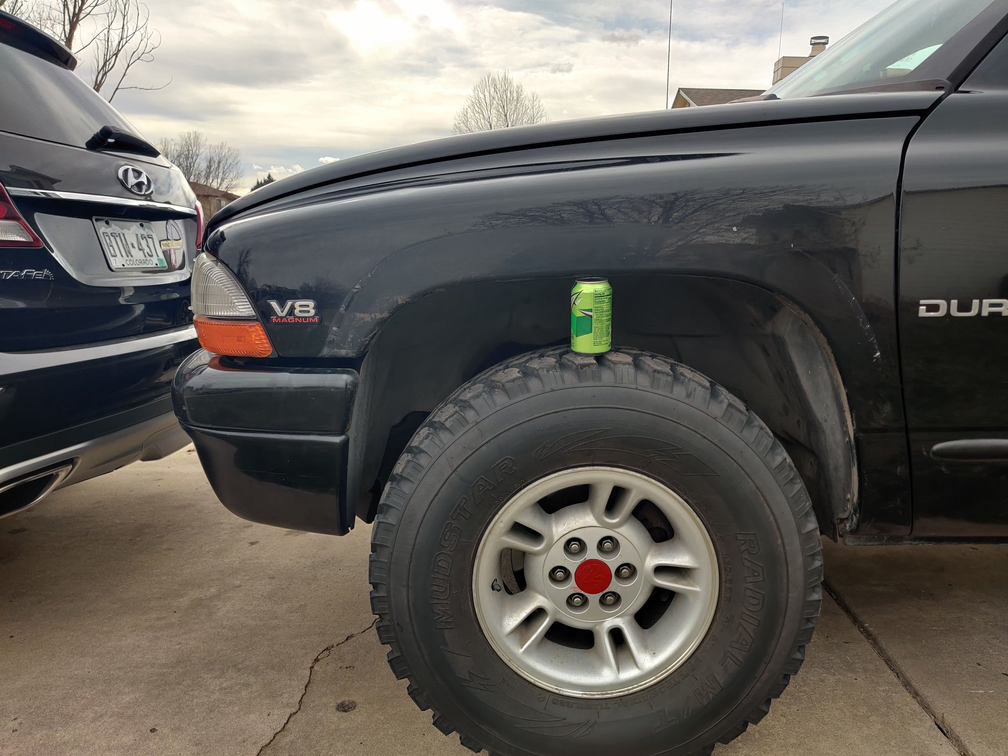

Since sitting right had time to lift her. I did an add a leaf in the rear and cranked up on the torsion bars. I think she looks great. Ride is stiffer but does not bother me at all. I like how she looks and now wanting more lift 😁
here are some before and after pics.

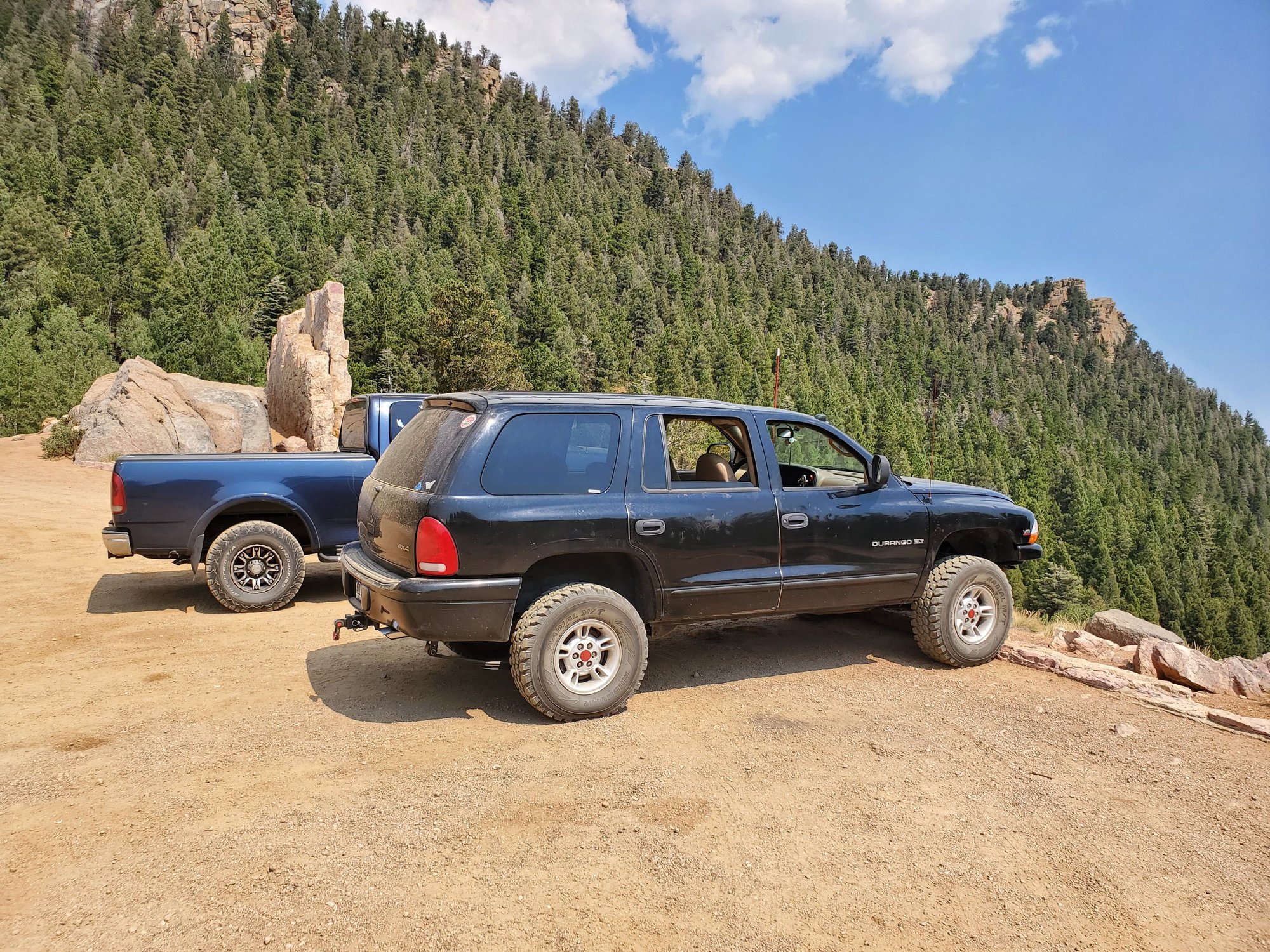

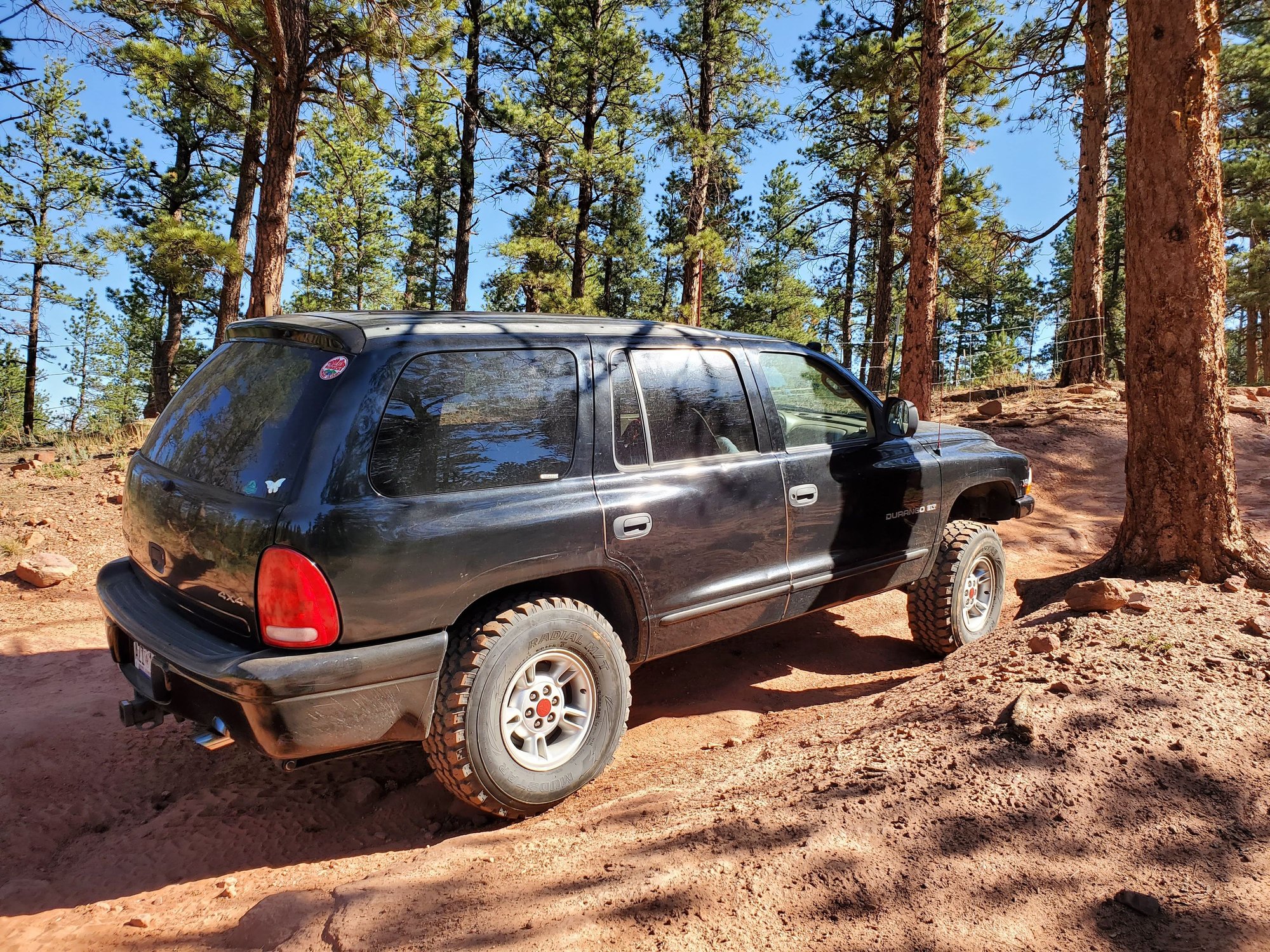

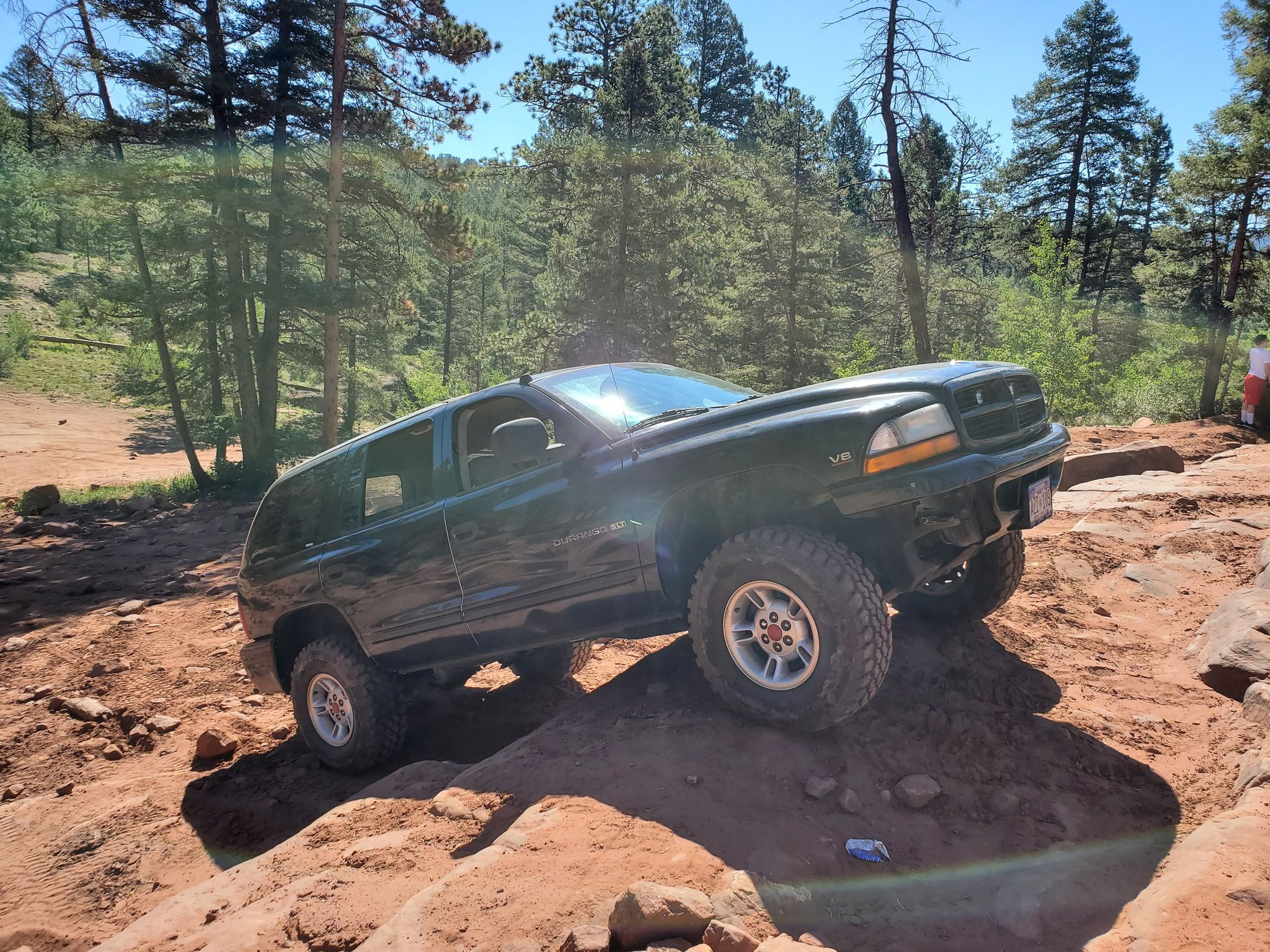

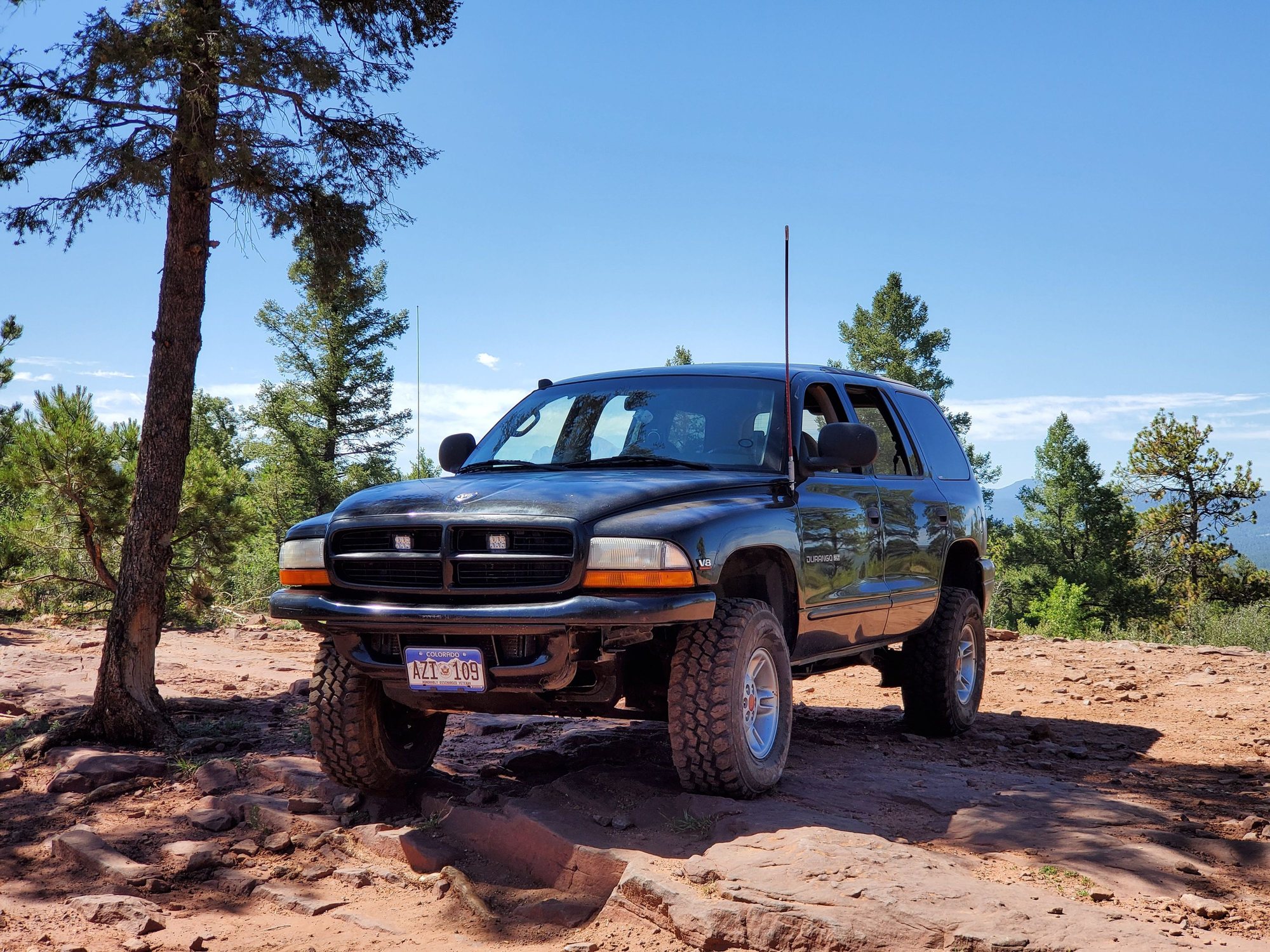

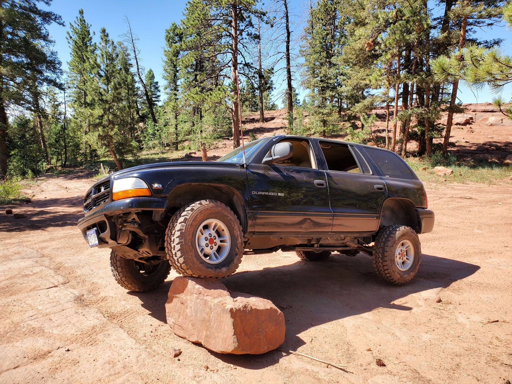

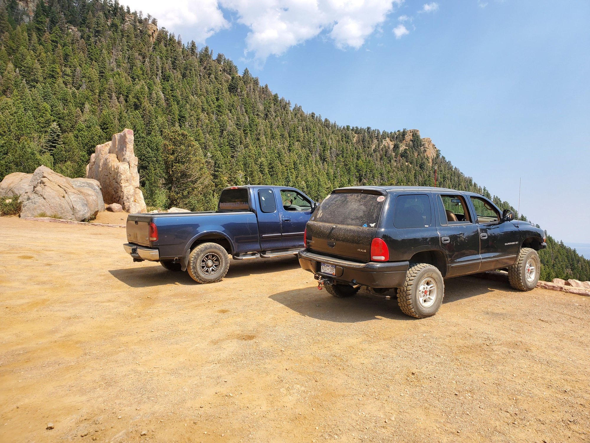

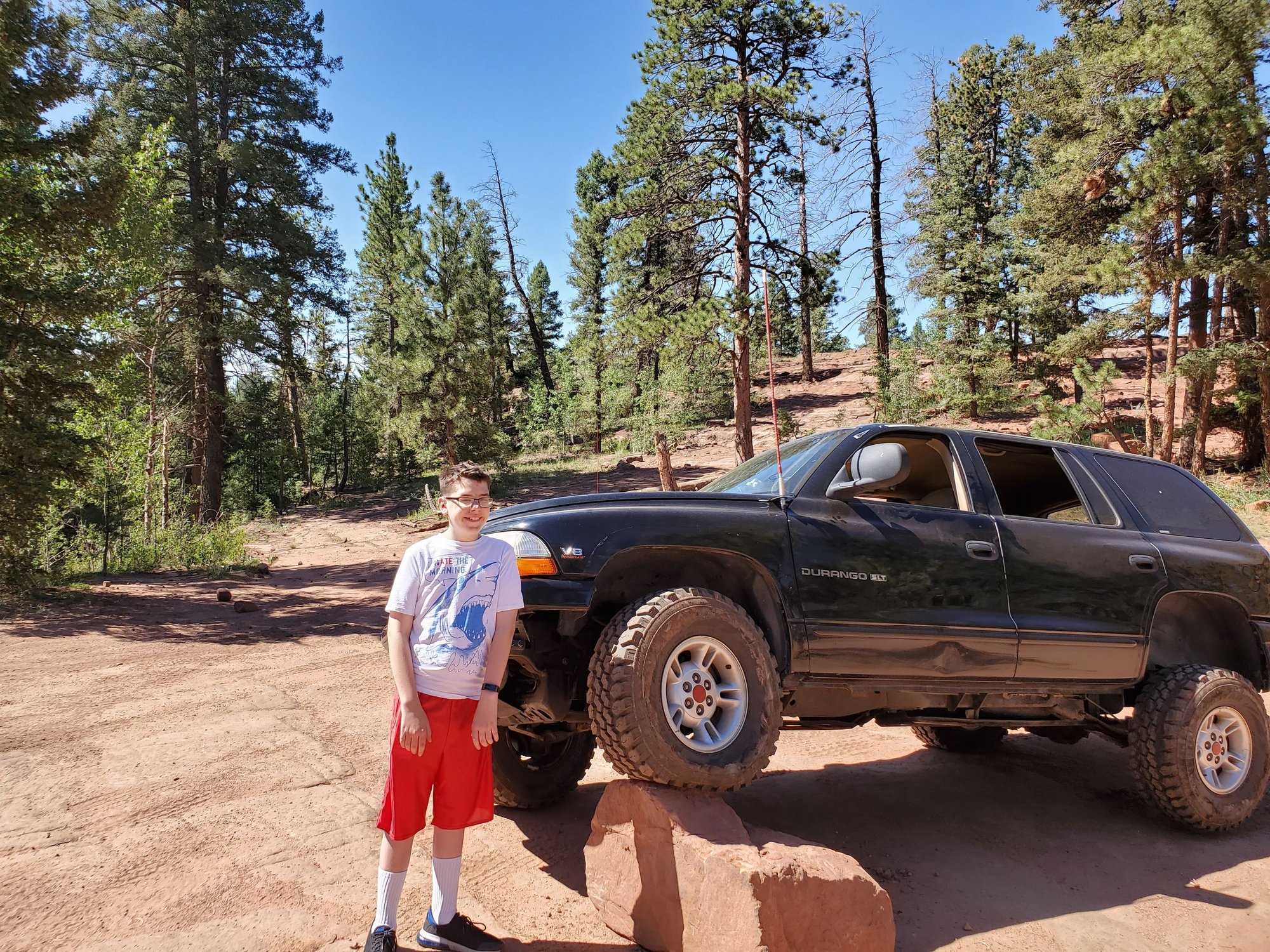

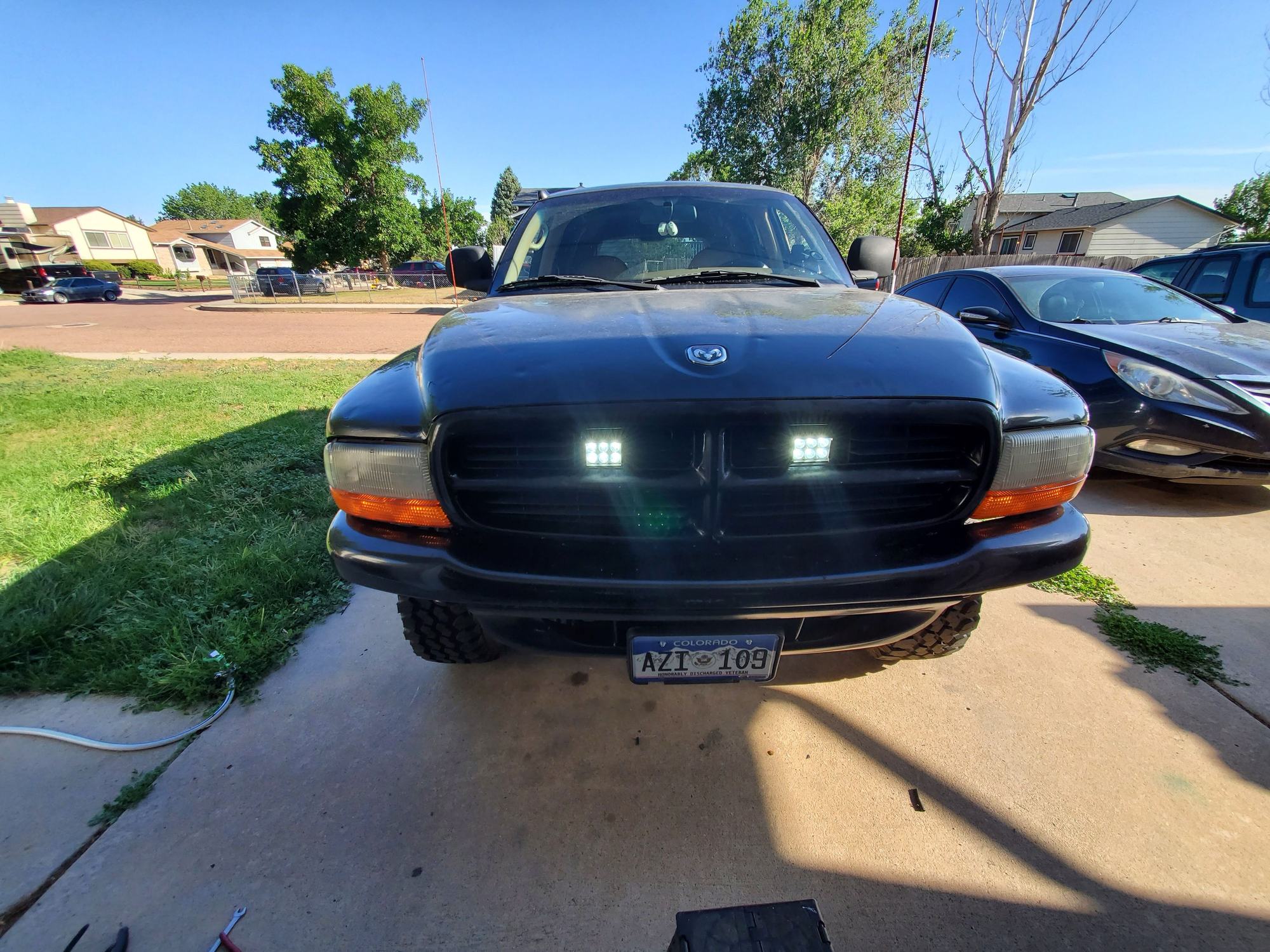

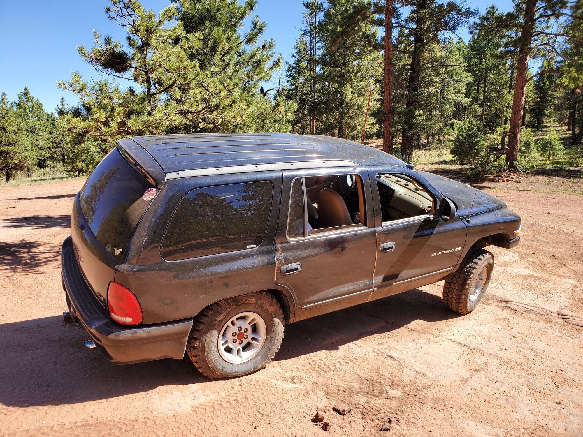

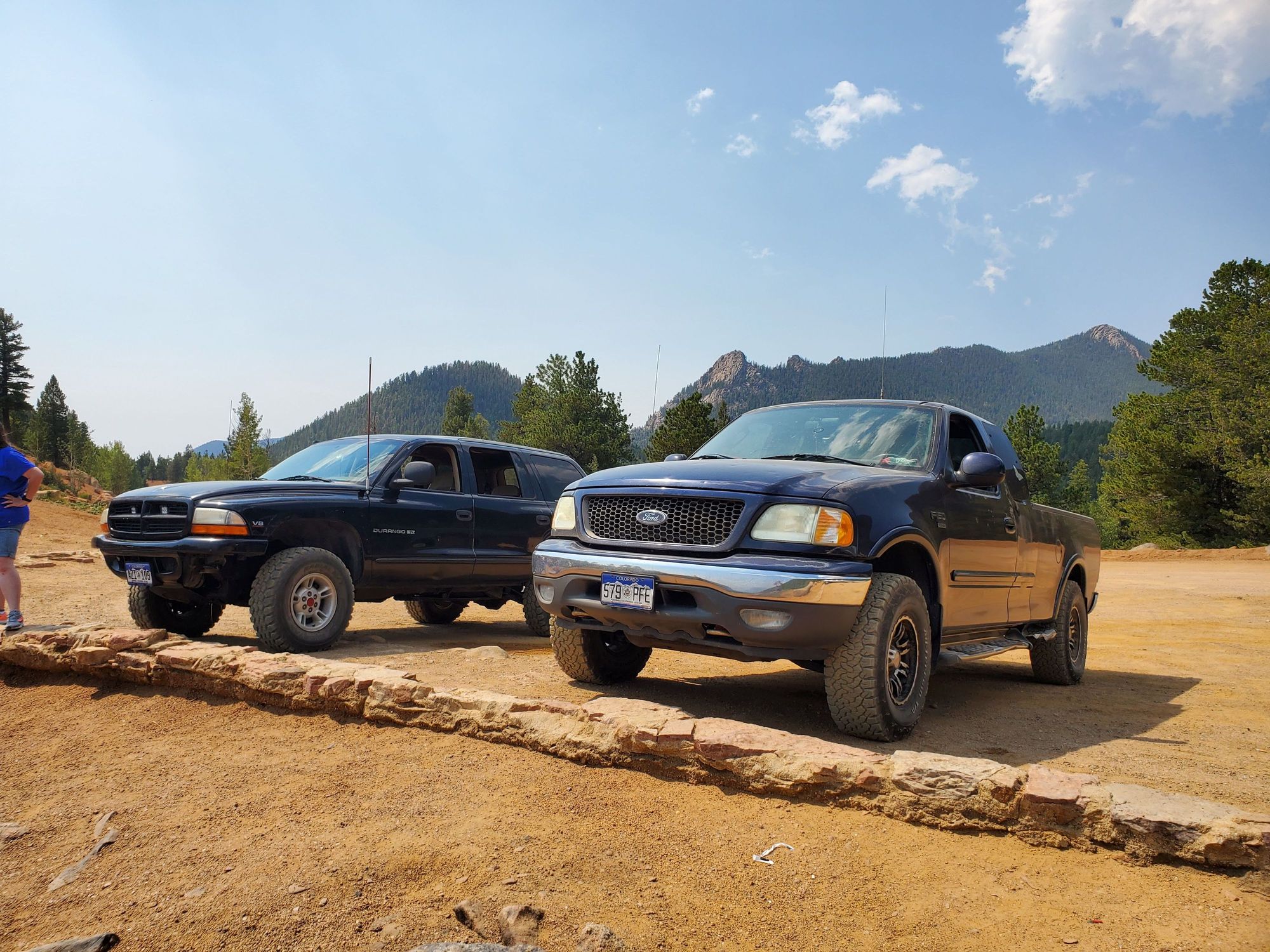

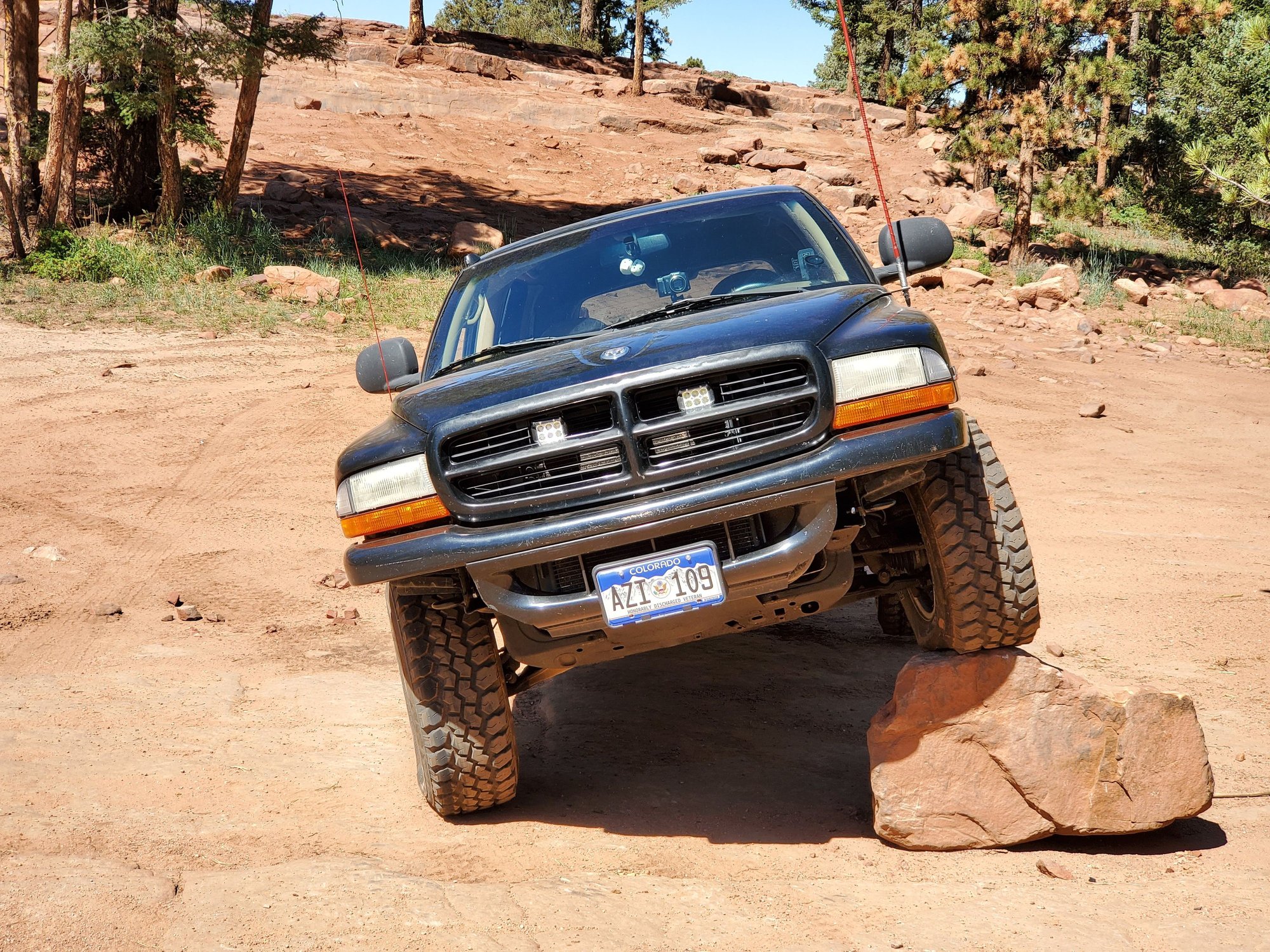

Well it has been a few days that I have posted here. So far I have been super happy with my Durango. A little update about it. Replaced Upper A arms CVC Axles, rear springs, lift shackles and 3" keys. I am very happy with how she rides. I have taken her several times out on the trails and she has been great. Up coming some weekend I will have to tackle the heater core. I flushed it and still no heat at ALL. Already ordered one from Rock Auto and will replace it in a bit. Soon I will be getting new tires. I want to have 33" tires. Still debating on getting the 16 inch rims or keeping my 15 inch rims. Leaning more towards keeping my 15 inch rims. Yes I know they will run my Frame I will deal with that when it comes to it. So enough talking here is some updated Pictures.
