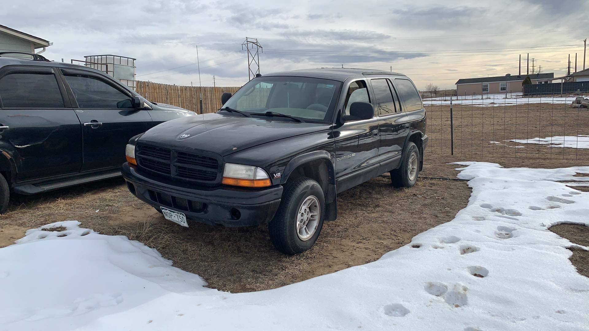

Here is her Before picture.
I will keep the thread updated as the Changes happen.

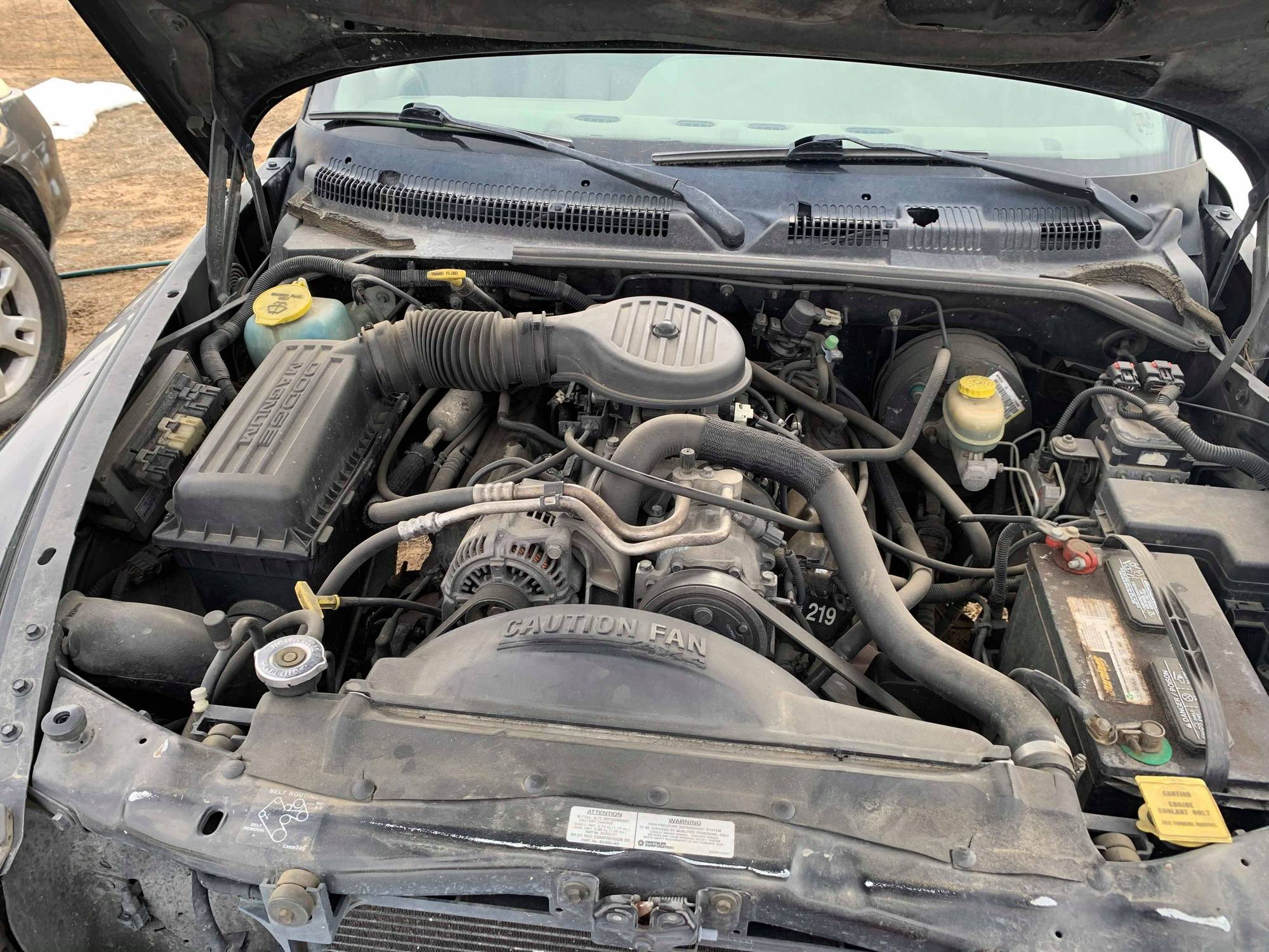

Here is the Engine.

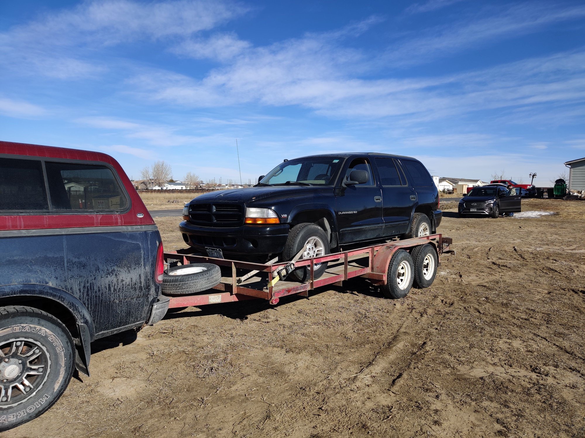

Well here she is all loaded up and ready to head home.
As I was goofing with her before getting her loaded on to the trailer found out she does not have the 3rd row seating. Its all good. A lot of storage for things that I will need on the trail.

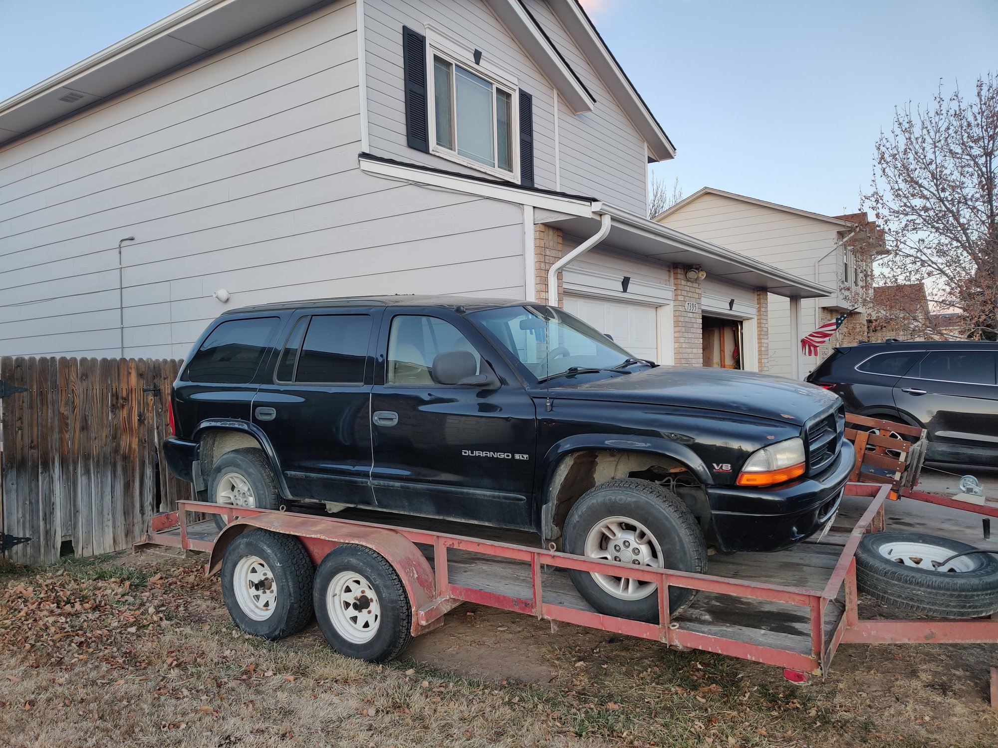

Here she is at home.

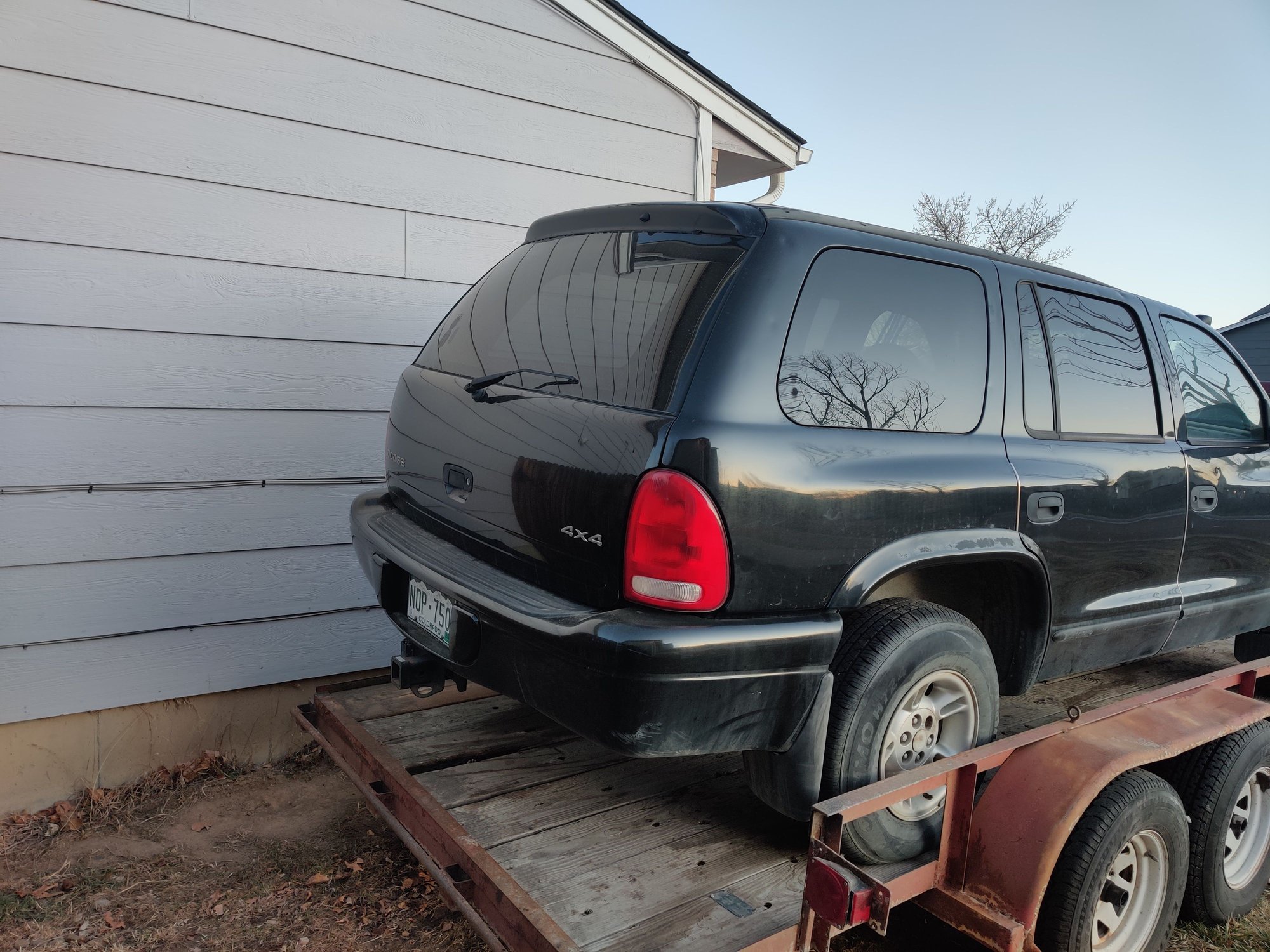

And here is her issue. Will be fixed soon.

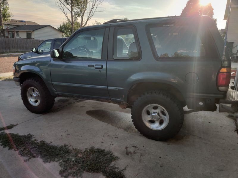

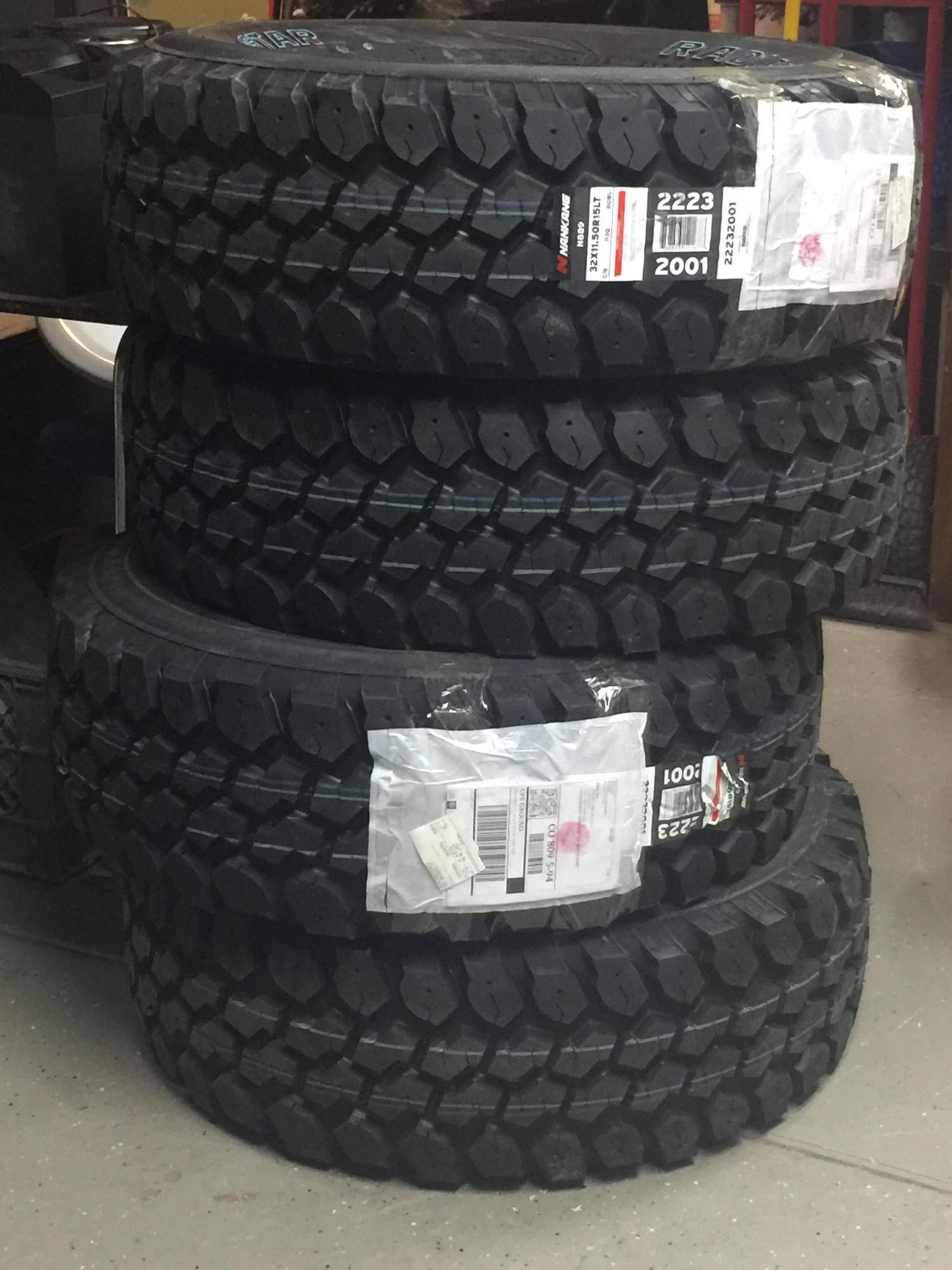

I already have a rear axle to replace this one. I was told they were driving down the road at about 45 mph and then all the brakes locked up on her or that is what it felt like to her. So I will be looking at the brakes. Also saw that the wrong size tires are on her. She has 235/75R15's on her. I will how ever be putting some 32's on her that I have on my other rig. Just got to get them changed out. Here is what they look like.
This is them mounted on a 97 Explorer Sport
Once I have them unmounted from the Ford and mounted on the D I will show you all.

Quite likely what they though was brakes locking up, was the result of the diff grenading, not the cause. Brakes are likely fine, but, since you are changing the rear end anyway, new brakes all around wouldn't really be such a bad idea.

Yeah that is what I am planning to do. Get new brakes and make sure my new to me axle is good to go. Any idea what would have caused the Driver line to do that?

Failed bearing, lack of lubrication, someone did an improper repair previously, bad luck, wrong phase of the moon..... Etc.
If taken care of, rear ends very seldom fail.

You might get some rubbing with 32s. Even with the factory 31s I got some rubbing on the frame at full lock. 235/75r15 was a factory size as well, but is too narrow of a tire for something this big in my opinion.
Old Jan 14, 2020 | 09:33 PM
WormsDurango's Avatar
WormsDurango
Joined: Dec 2019
Posts: 43
Likes: 14
From: Colorado
On my build sheet it said my tires were suppose to be 31s. I totally agree that this size is to narrow for the D. I plan to lift it with a TT and a AAL. Once that is done will check the 32s and see what kind of rubbing I get. Thank you sir.
