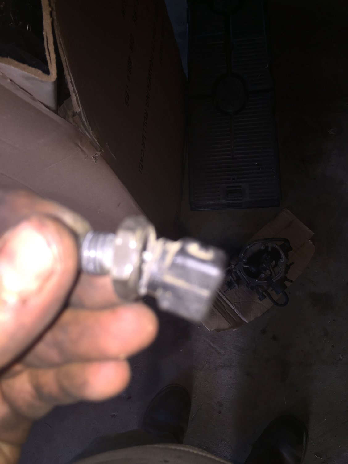

Likes: 72
From: orangeville ontario
looks like a overdrive connector to me. being a 89 it may or may not have overdrive.does it have a overdrive button on the dash?

Old Sep 4, 2018 | 02:59 PM
  #34
Ahaarman-89_d100's Avatar
Ahaarman-89_d100
Joined: Aug 2018
Posts: 69
See I thought I read that that’s what it was and yeah mine had overdrive button over to the right and above radio
Old Sep 4, 2018 | 09:46 PM
  #35
crazzywolfie's Avatar
crazzywolfie
Posts: 8,025
Likes: 72
does your truck actually have an overdrive transmission in it tho? i would almost wonder if someone swapped the transmission if that connector is unplugged but you have the switches and wiring for overdrive especially since 89 was the first year for overdrive. they were a weaker transmission so it might have died.
