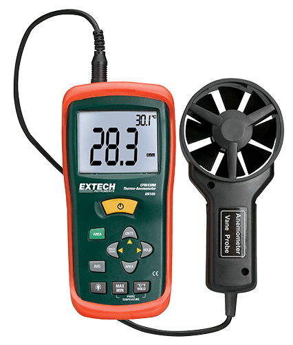

Yeah the volvo fan is stand alone, no clutch fan behind it. It was because of the lack of info I decided to build the chamber. I had a guy ping me about a year after that project, the guy built fan installations for some application and mentioned the only thing he would have done differently was to create a grid across the box to measure the flow. I told him the probe I had on the anemometer would have disrupted the flow too much and it did not make sense to go that route. He did mention the data collected across the various fans was a good comparison for what I was after. It showed me the Taurus fan drew the most CFM followed by the straight blade Volvo then the s-blade Volvo.
Since data collection is my profession (electronics test engineer), repeatability was key across each fan. Real world performance is also key for me and those volvo's have not disappointed. I have 2 spares (one has a noisy bearing) in the shed, one of those will find its way into the Dak. But, I can set up a test of both fans on my test box and compare them before the install.
http://www.extech.com/products/AN100
