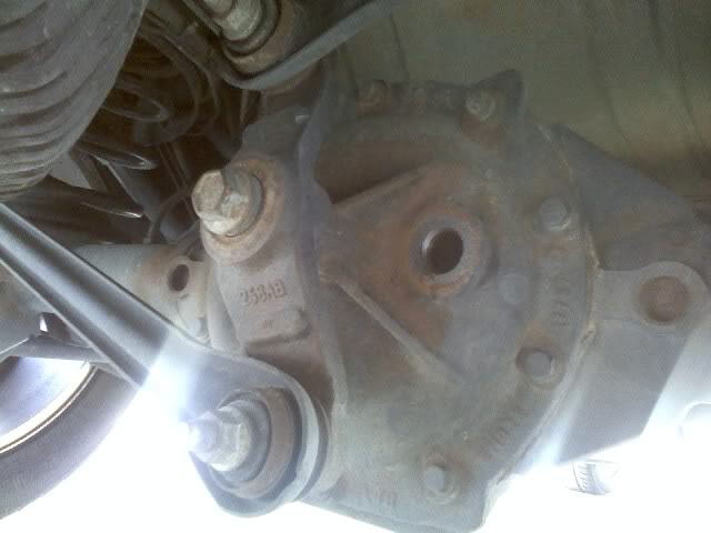

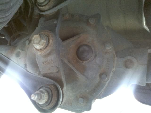

Can anyone tell me the exact location? Pic would help lol.

Can you post a picture of rear diff assy,that way i can tell you were the fill hole is at? Also would help if you posted the year and engine size too.Because the 2004 thru 2006 use a 8 1/4 and 9 1/4 rear diff. 2007 and up have the 9 1/4. All rear and front diff have fill hole. They may not have drain holes. Thats when you would one remove the cover or covers or two suck the fluid out.

Its an 06 4.7/AT/2wd with the 9.25 with 3.55s

I only ask if you can post a picture of the rear diff cover on your 2006 4.7L 45RFE/545RFE automatic transmission 4x2 with a 9 1/4 rear diff?

Here are a few pics of a 2007 Durango with a 9 1/4 rear end. One with the plug out, the plug and plug in. It's pretty obvious, shouldn't be an issue finding it.
