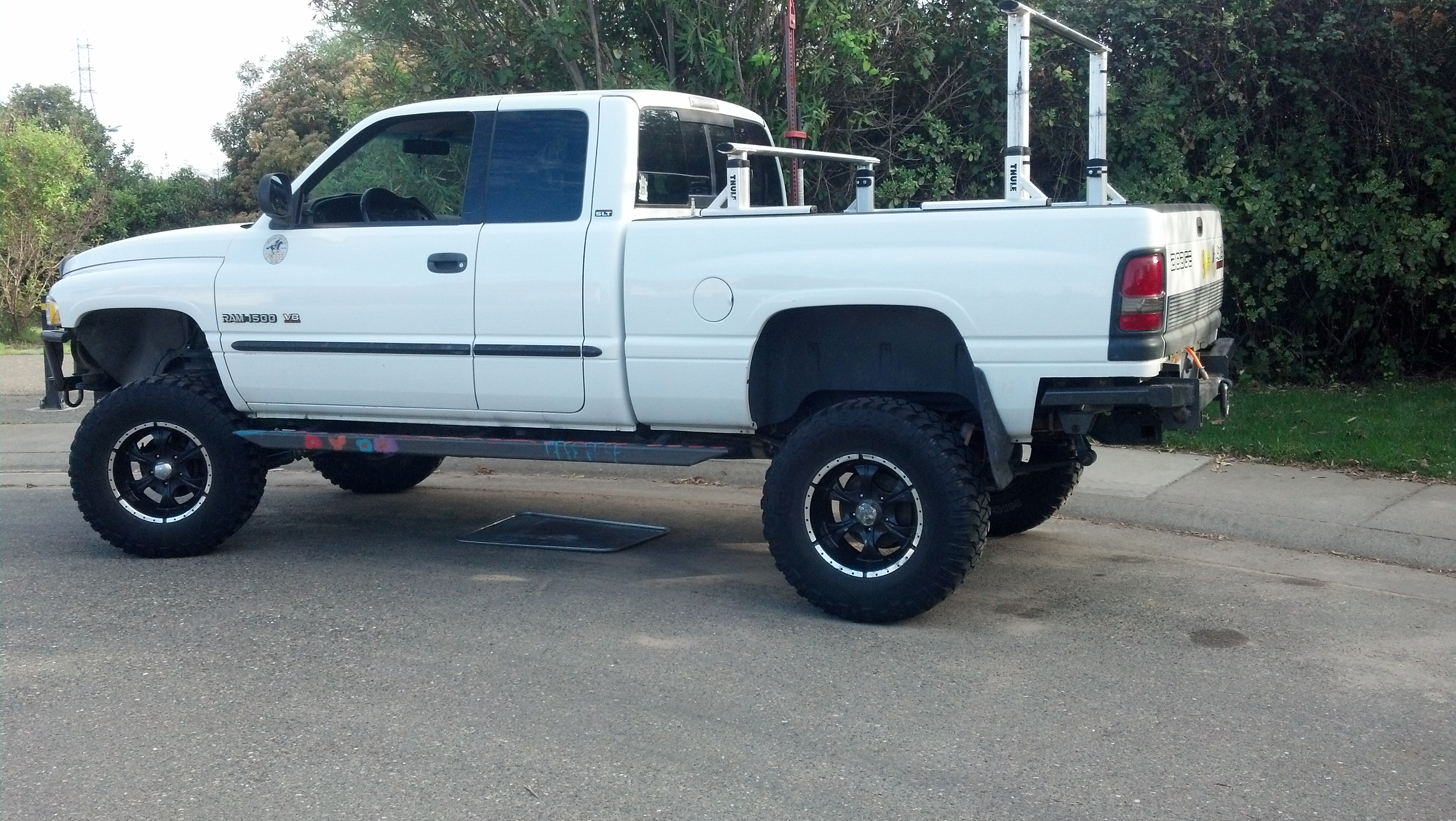

Got this done today.
Stock ORE Lift

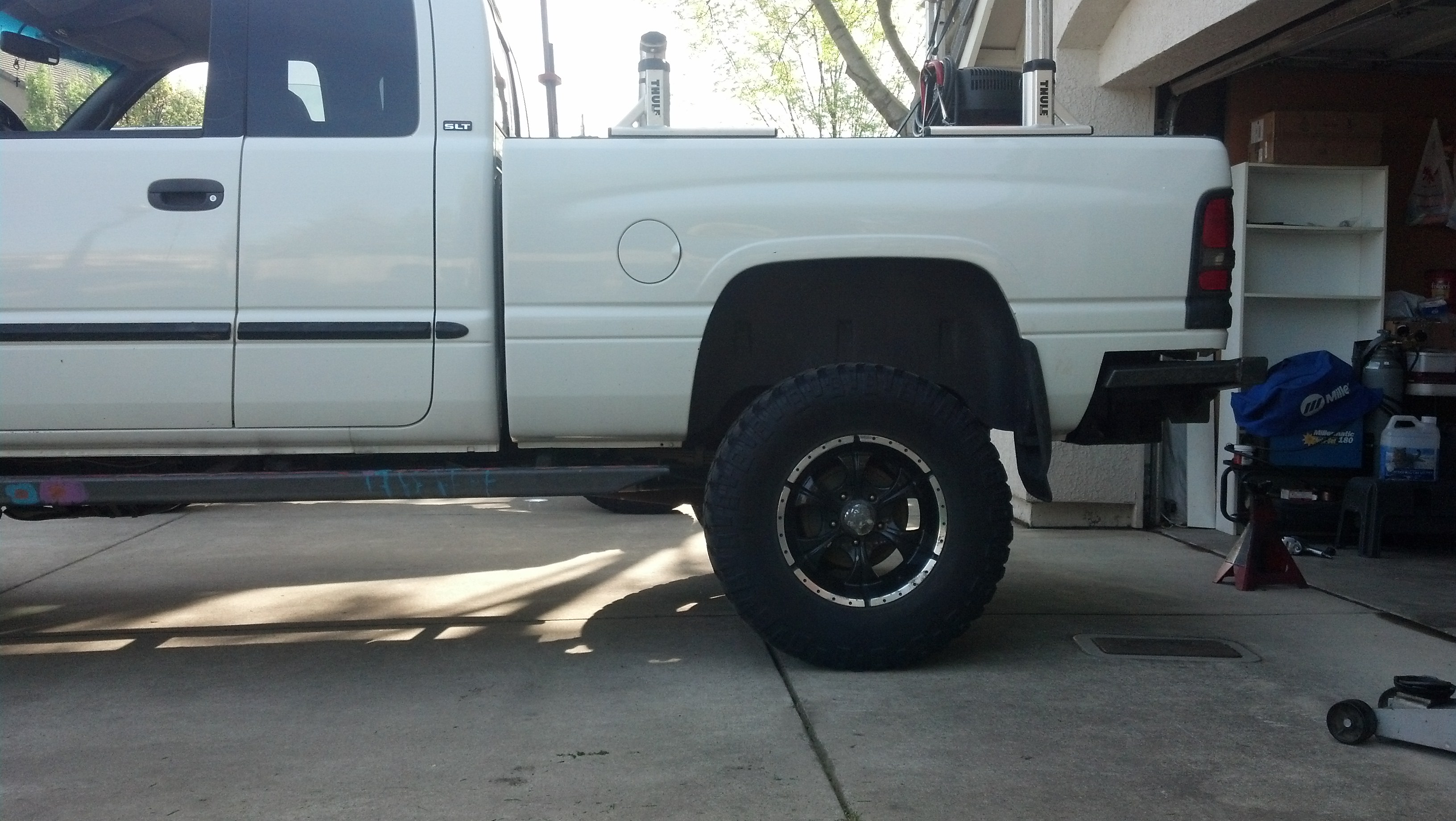

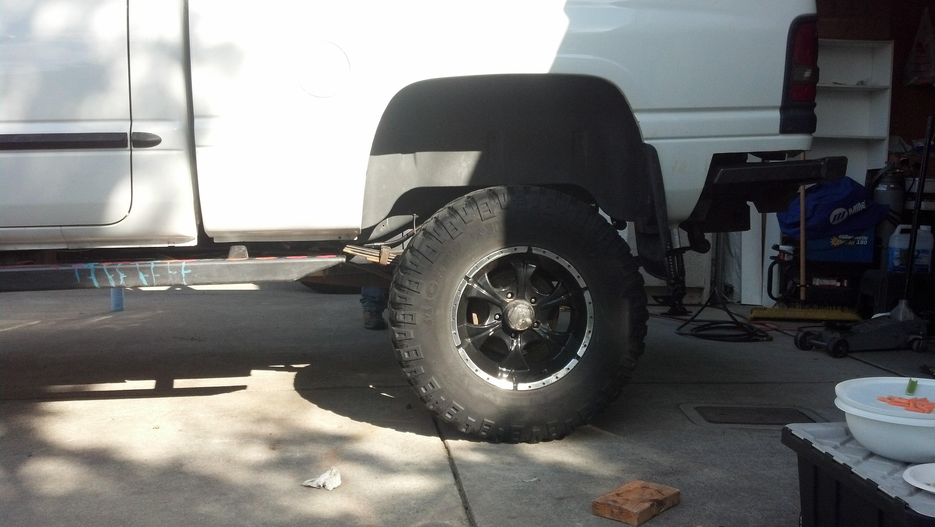

Shackle Flip Lift - removed factory block, netted about 1" more
Parts --
BDS Shackle Flip Brackets
Zero Rate Blocks
New Ubolts and plate - Ubolts flipped!
New Leaf Spring Bushings -- Don't buy the kit from Summit! They are wrong size!
1/2"x1.5" long G8 bolts, washers, lock washers, nuts
Reused leaf spring bolts

^^^^ I like it lot's!!! Better pix of the frame end of this would be kool. What's with the drip pan? Shiny wtf is that about lol.
Old Mar 29, 2013 | 11:52 PM
  #10613
Wh1t3NuKle's Avatar
Wh1t3NuKle
Joined: Sep 2011
Posts: 3,891
Likes: 8
From: NorCal
Had some case fluid drip out as a result of extending sliding yoke. Pan was just to catch anymore. Left spot at my buddies driveway. Haha
I'll get more pics.
