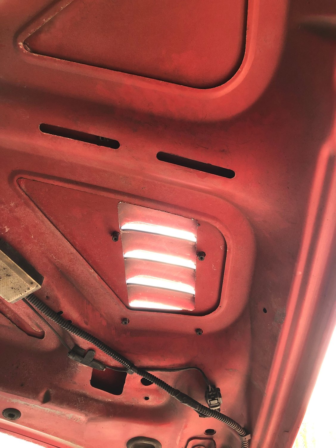

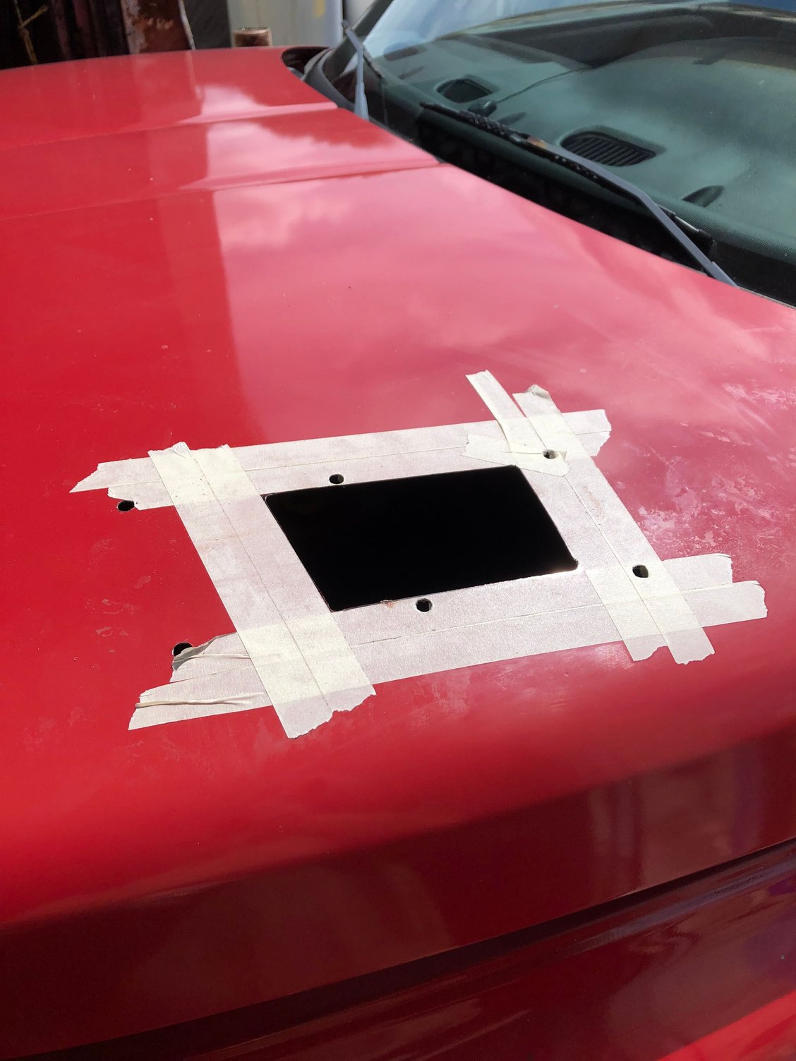

Today I put openings in my hood for some louver vents (AKA 5.9 ZJ).
They're at a bit more of an angle than I would have liked, but that was governed by the slots in the hood frame.
I cut a plastic template for the mount holes and the cutout... flipped it for left/right side.
Drilled the first two holes from the underside through the slots, then line the template up on those holes an do the rest from the top.
When done and deburred, I shot the edges with some primer to keep rust at bay until the cabs repainted.

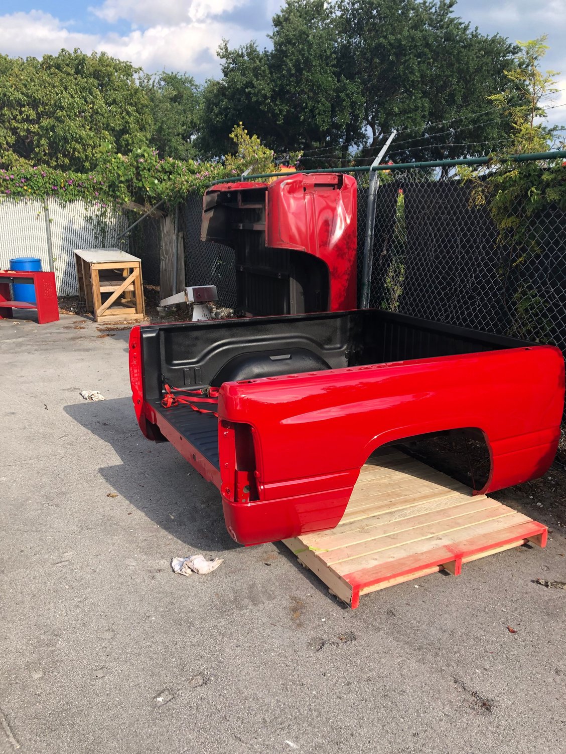

Got the replacement bed painted...
Working on the cab next.
