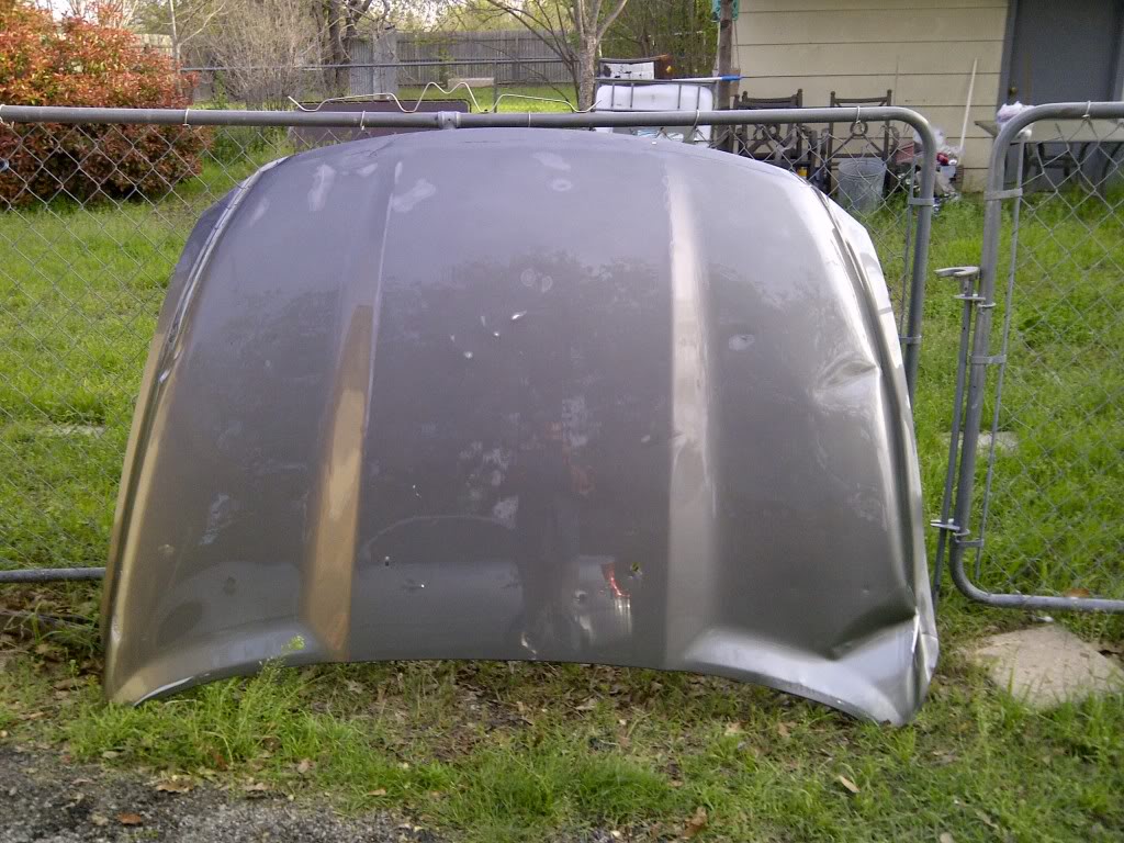

I picked up scarap hood from local body shop for free from his scrap pile. Sanded it down into base. Used this to set spary gun. Only had heavy spray at first (round spot with runs). Set gun and sprayed part of hood and no orange peel and no runs except first shot.

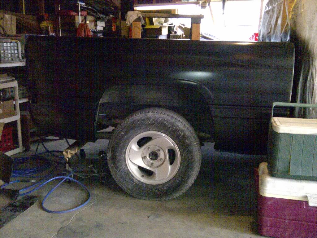

So I slipped off work a couple hours early today (being the boss has its perks) and went home to work on Ram. Here it is after spraying base on last night. (little grainy - not enough light for crackberry camera)

I shot one coat of clear on it this afternoon and only had one sag on right rear fender. My question - do I shoot another coat or let this set and sand it off before applying another coat?

If it hasnt been too long, keep going with the clear. If you sand it now, you risk the chance of sanding through the clear. If you do that, youll have to start over with base or itll be seen.
