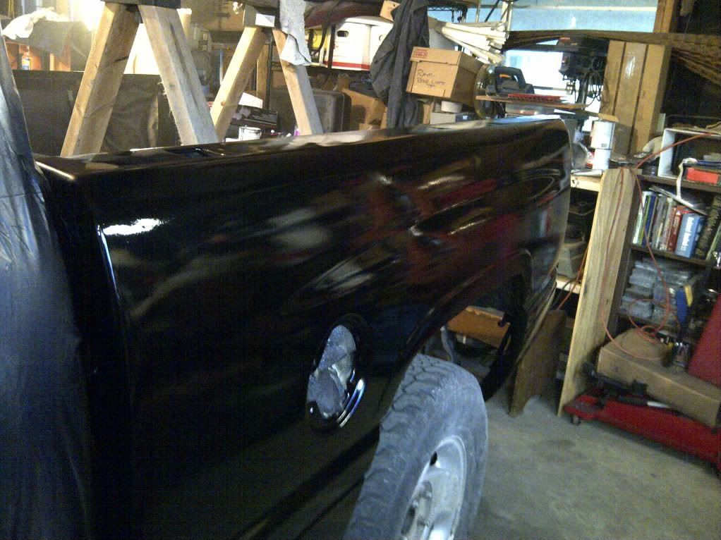

Was able to shoot clear on bed today.

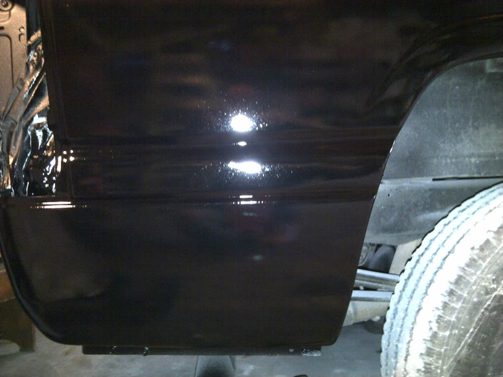

This is one of the rear panels that I had to cut out and weld in replacement.

Lookin good!!

It did look better after clear. The blask was not as glossy as I thought it would be. And the metallic did not really show until I hit it with clear. I was getting frustrated since I was thinking it would not match the Yota, but I knoew the Yota has factory paint as it has never been repainted. But with the clear it looks like a match!
