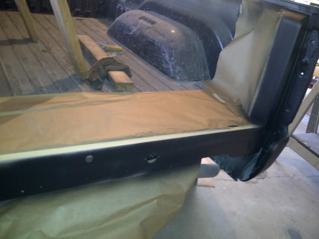

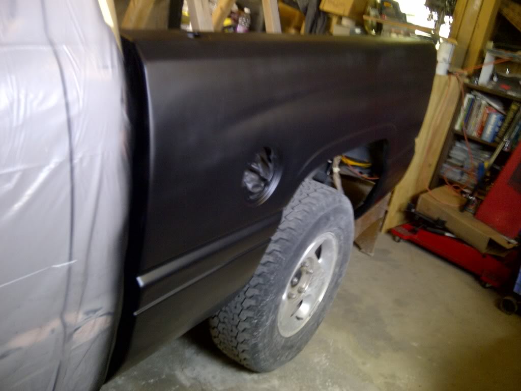

I was able to get to do some painting today. Basically bagged the front end of truck to keep overspray off instead of standard masking. When I get the rear completed I will bag the back and start working the cab to get inside the edge of doors and rockers. Pulled interior time and door seals today to prep.
Got the last prime on bed and will shoot base this afternoon.
I will not be painting the inside of the bed, but will spray bedliner after truck is painted.
