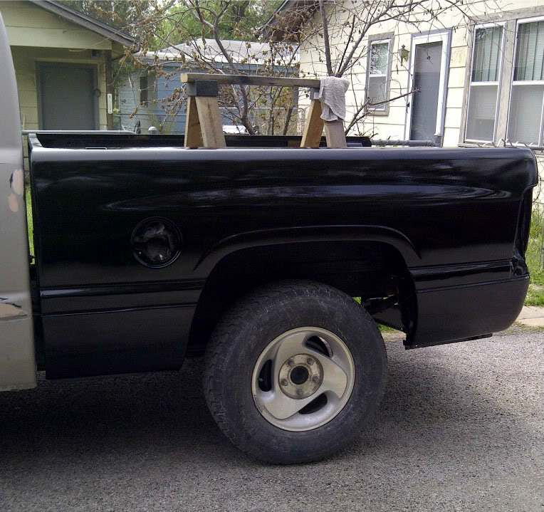

When I pulled the Ram out of the garage to turn around to paint on the cab, I decided to take a shot. It does look better in daylight.

Old Mar 28, 2012 | 10:35 PM

Nice work! Good luck with the rest of your job!

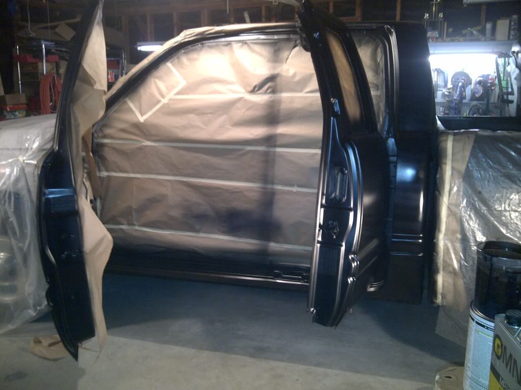

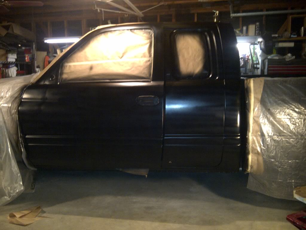

OK. Now after 2 coats of base......will clear tomorrow. Still waiting on nozzle for Iwata gun with side swivel cup to allow me to shoot roof and hood perpendicular to the surface. Will work on pass side tommorrow as well. masking takes some time to cover the whole opening, but I did nto want to be able to see a differnce in the paint when the doors are open. Cleaning the crud around the hinges (which have probably not been clean since 1999) took some doing.

looks great. one thing i would do is wet the floor to keep the dust down. by the way your jag what model is it ? a v12 ?
