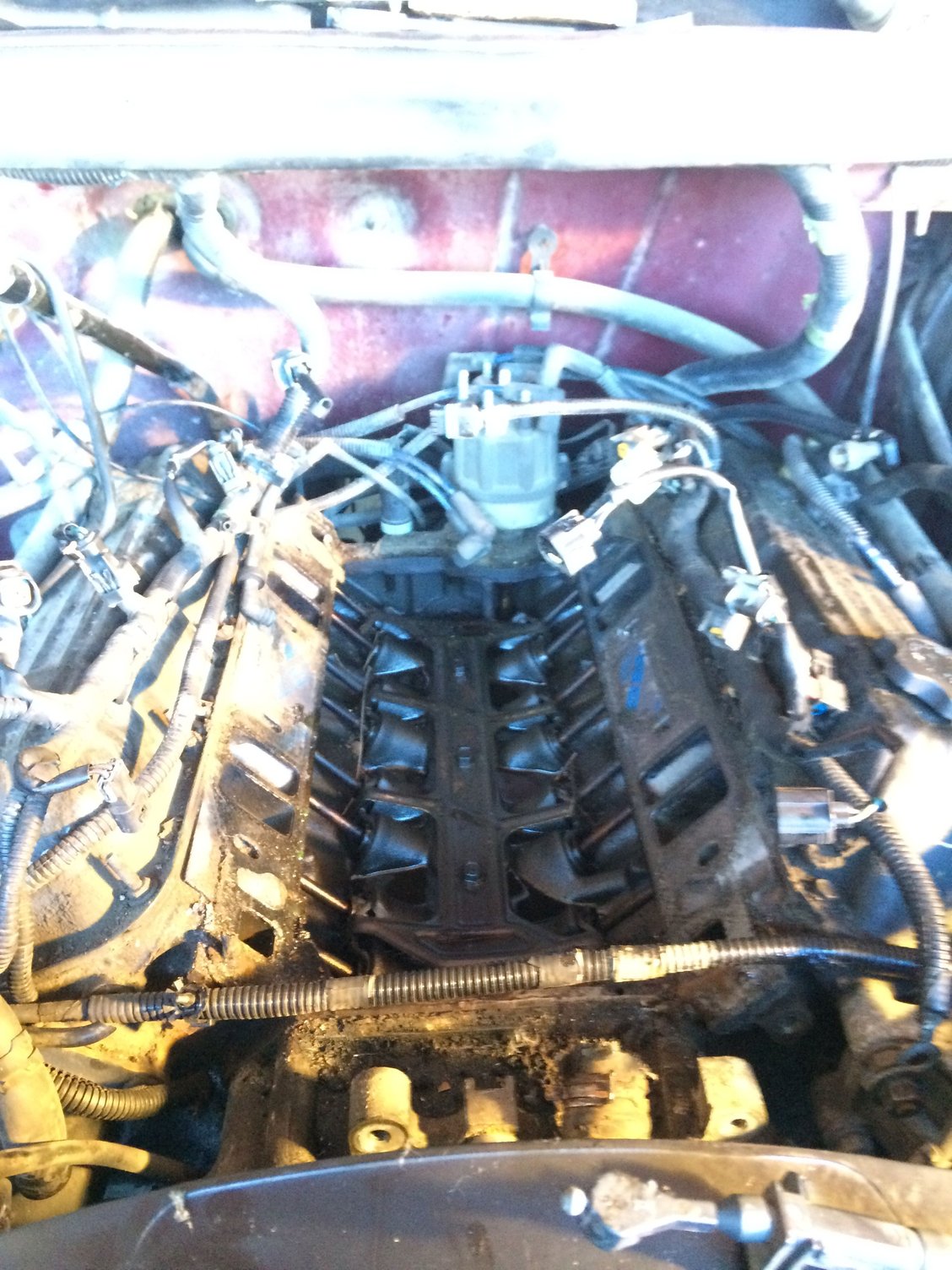

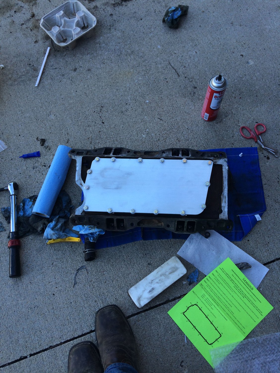

Replaced 2 days ago (1-2-16) with Hughes Kit. Truck had 194,000 and the gasket wasn't blown.
I had to move everything away from the wall and still the truck only cleared the garage door by about 3 inches
I did distributor cap and rotor, spark plugs and plug wires while I was in there
I don't have a picture of the old one but it wasn't blown out or broken anywhere.
