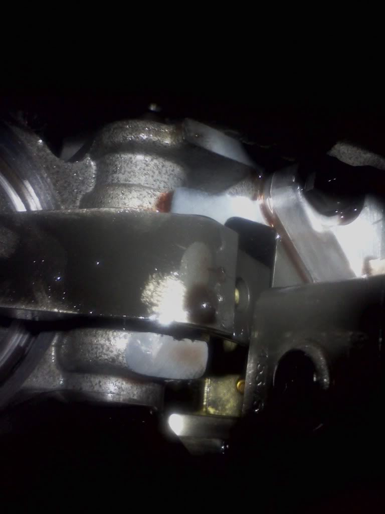

ok, so ive read portions of the service manual, and found out that the vb is not what i thought it was, thats why i didnt know where it was, that **** was right in my face lol. i also googled and googled until i found the piece i believe youre talking about. its kinda dark but i went out with my flash light and took a look i didnt see anything or feel anything. Not too insult you gdstock, but im not too confident in what im doing are you sure the piece you said is moved or missing is truly not where its supposed to be?(i know my video wasnt the greatest) (nor my pic of the vb with the filter off) as i said i dont know too much of what im doing. any ways would it be recomended that i remove the valve body and search for this piece??? in the morning i will get a better look. here is a pic of the piece i believe you are talking referring too
in the mean time im going to take my time and read i big portion that i havent read yet in the service manual, and try to determine where this mysterious strut is supposed to be.

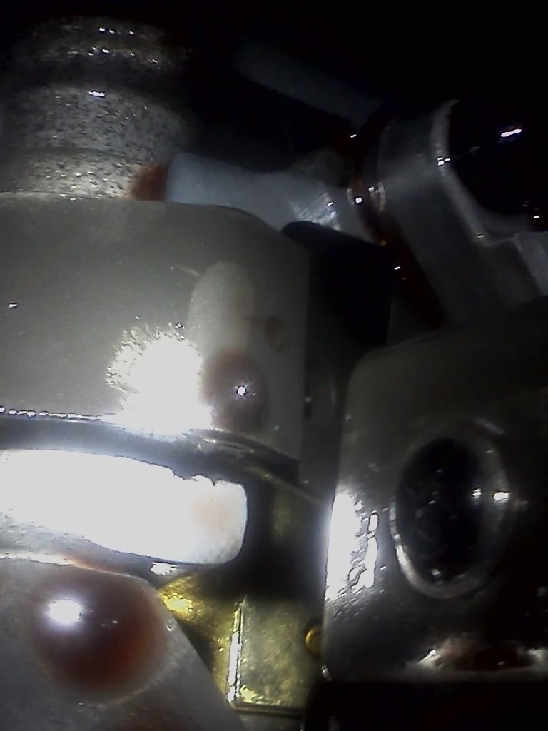

so after a couple mins of reading and searching i went out to my truck with a flashlight to take a look. What i believe is the front band (i know thats the one you adj from the outside of the tranny) has the strut, still not sure of the location of the rear strut
here is a pic of the front band strut

The strut for the rear band that you are looking for is this one:
http://i1096.photobucket.com/albums/...lue/strut2.jpg
IU looked for a photo that I took, but it must be on another computer.
