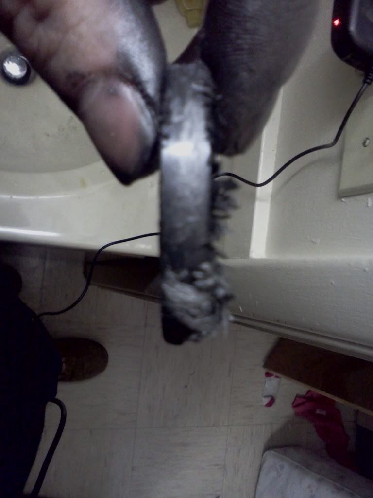

I had warning signs 10,000 miles ago when the gov soluniod plugged and I replaced the sensor and soleniod.... if your soleniod screen if full of shavings but replacing or cleaning it works for you you may want to start saving for a rebuild... when the TC finally lets go it leaves shavings everywhere... thats what happened to me.

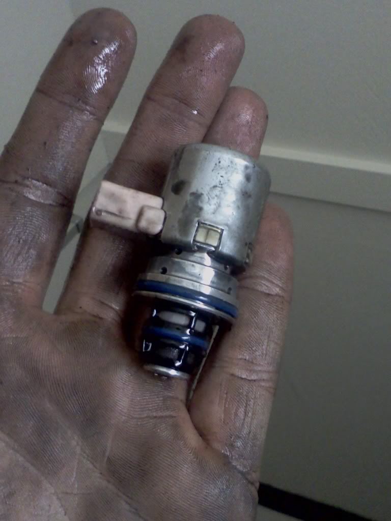

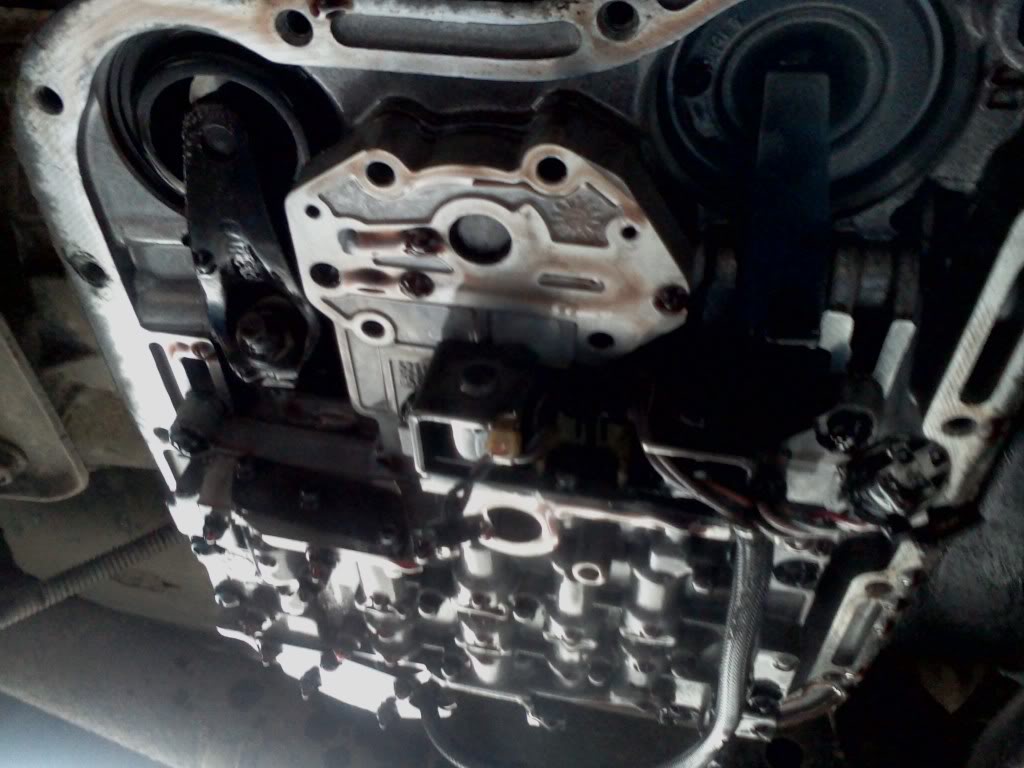

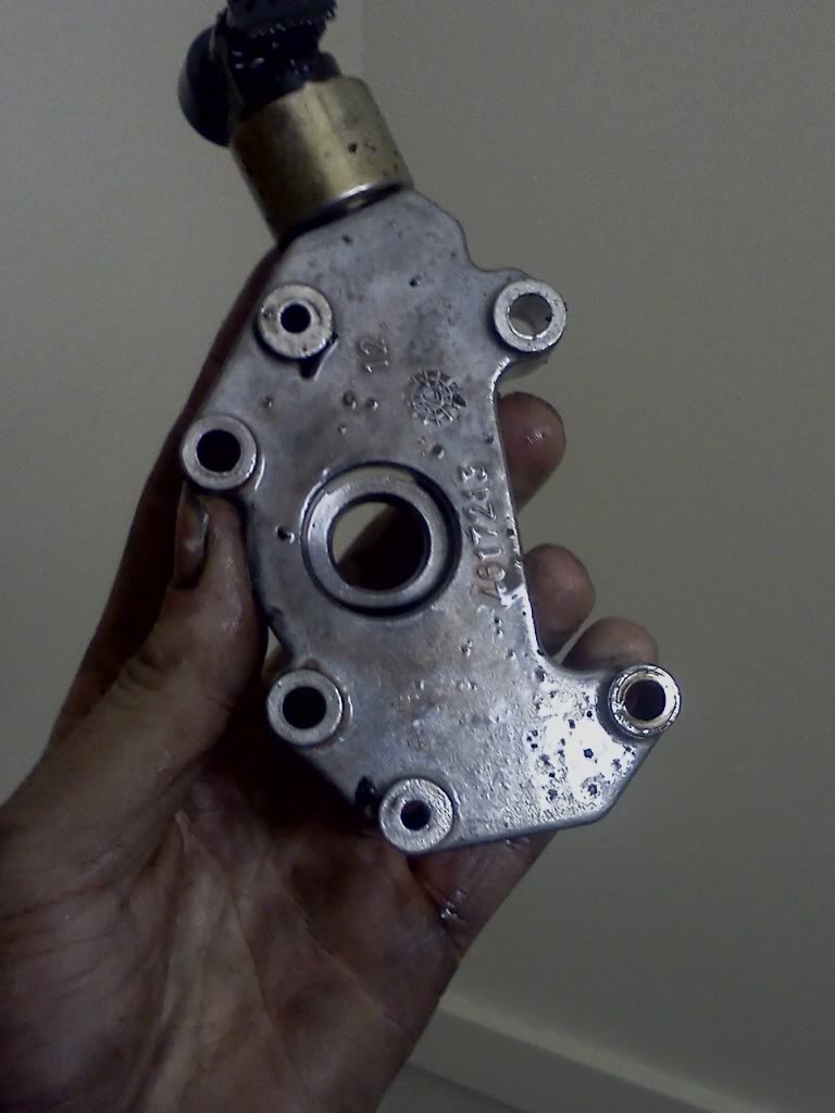

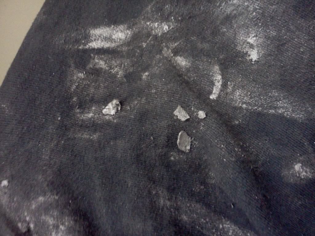

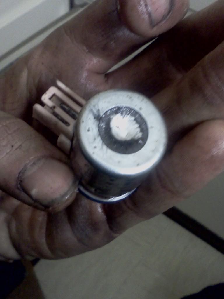

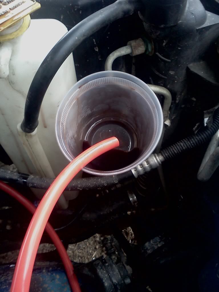

I stuck my transfer pump in my dipstick tunnel and began to pump, the fluid that came out was DARK! after pumping it all out i dropped the pan. The fluid that was left in the pan had swirls of another color it wasnt quite metallic but it was on the silver side (best way to describe it.) after emptying the pan of most of the fluid left i found three small pieces of black chips, it was almost like chips of paint. The pieces were thin and brittle, like i said almost like chips of paint but slightly (emphasis on slightly) thicker than paint. the magnet was covered in crap. keep in mind that not even 5k miles ago i did filter and fluid, the reason i mention that is because i would think that after changing fluid and filter (also cleaning magnet at that time) that there shouldnt be that much on the magnet.
after that i removed the aluminum piece that the solenoid and sensor sit on, then i disconnected the wiring and the sensor and solenoid. that is where i am now.
I took plenty of photos and video just having a problem emailing from my phone to the computer (my phone is a piece of ****) so now im going to hook my SD card to my computer and upload them that way so within the next half hr i will have those up.
i ordered the new solenoid and sensor from napa but didnt have them in stock so this morning before i did that work previously mentioned, i went to drive to the warehouse a couple towns over and pick them up. wasnt going down, right before i got on the highway tranny started acting up. its like when i turn the car on it shifts kind of o.k will shift around 2k to 3k but after a few it starts shifting later or not shifting at all. so i turned around and headed home. as i was heading home i was at 3,500 rpms and only doing 20 miles an hr as the rpms went up my truck only increased speed about 1 mph. i pulled the truck over turned it off, and restarted it. it would shift ok for a couple and start to **** up again, so i got home after continuing that process another two or three times.
