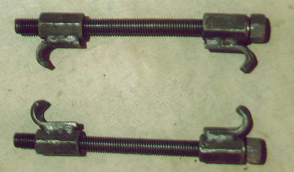

Me and a buddy of mine added a 2.5" too mine. I also added the Bilstein 5100s at the same time. Pretty simple.
I used a set of homemade compressors just the passenger side though, the driver side I got the axle to drop enough for it to go back in on its own.
