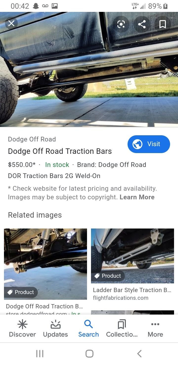

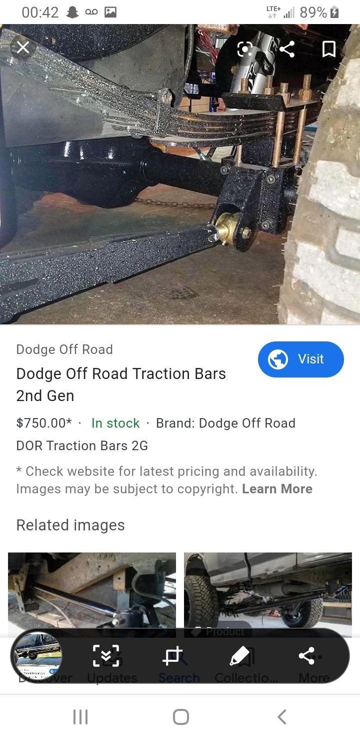

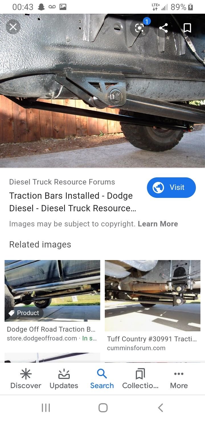

Originally Posted by adukart
My only concern is that doesn't solve my axel wrap issue just the sagging under load. How many people go wheeling with traction bars and are there any good designs that don't kill flex and ride comfort? Also would a shackle flip that eliminates the block work instead of a traction bars? I'm kinda new to all this.
A shackle flip would at least eliminate the lift block. Should improve ride when would help with axle hop. Axle hop happens for two reasons. Stiff suspension or to far away from the axle.
A company makes a reaction bar kit where you weld brackets to the axle and frame. Basically a long arm kit for the rear. Just one bar per side. Shouldn't hurt flex. Search for Cummins traction bars. Something like the following. Stay away from heim joints. They usually suck on road and don't last to long because of dirt and salt getting in them.

Old Feb 18, 2020 | 04:00 PM
  #1159
Posts: 87,554
Likes: 4,230
Shackle flip, and eliminating the lift blocks would most certainly help with axle hop. Not sure how effective those bars would be..... I am sure they would help some.... but, how much?? And would they really be required if the blocks were gone.....
Old Feb 18, 2020 | 08:55 PM
  #1160
MoparFanatic21's Avatar
MoparFanatic21
Veteran: Marine Corps
Joined: Nov 2014
Posts: 8,098
Likes: 318
Building a suspension is trial and error. Usually axle hop the bottom of the axle rolls towards the front of the vehicle. That's what these bars stop. They will eliminate 98% of axle hop
