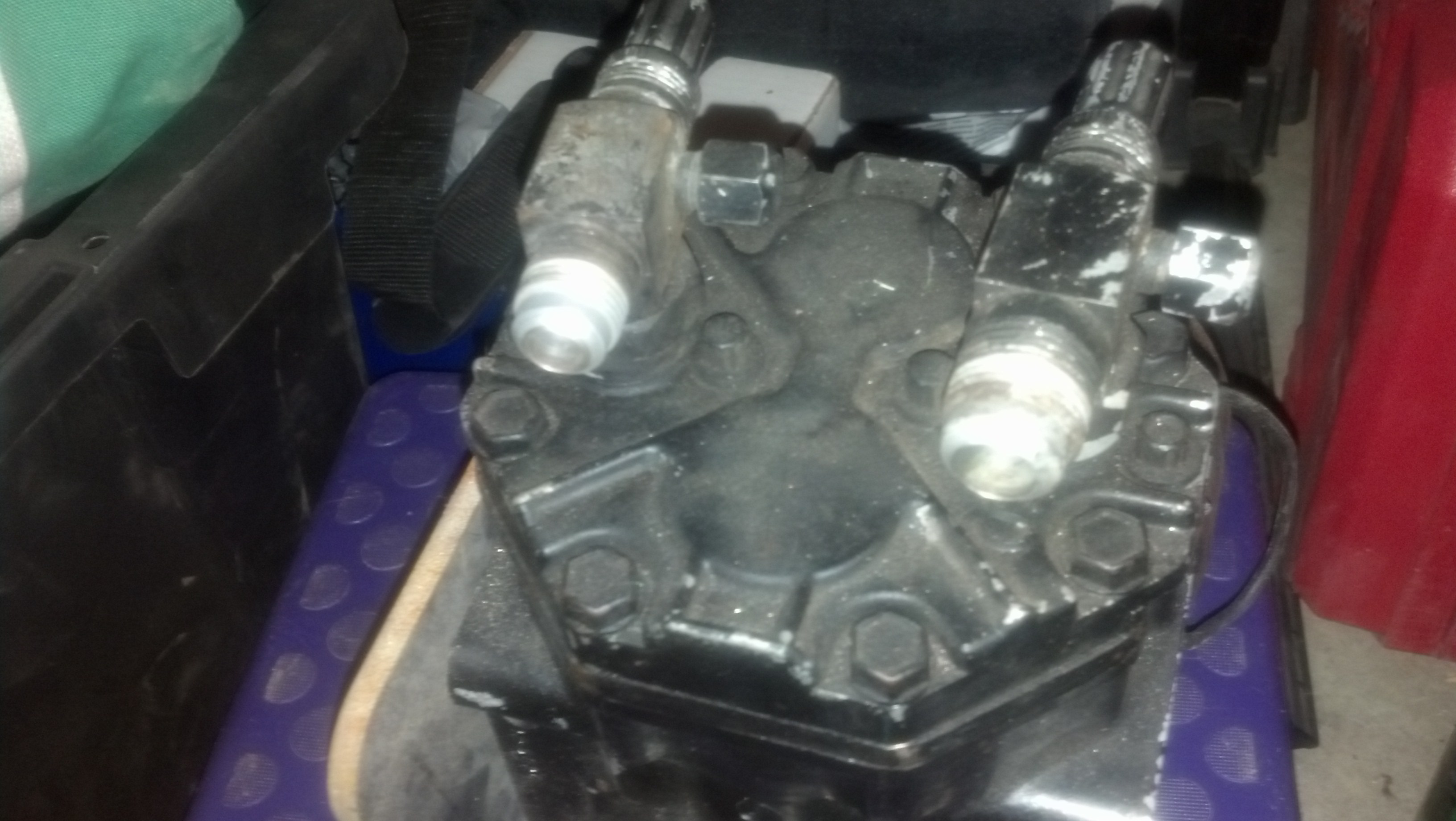

Yes the Goodyear InstaGrip is high temp. Buddy put it in and using on his setup in LJ. It's holding up whereas the cheaper standard hose lines did blow off. The InstaGrip is also the same stuff Kilby has in it's kits.
I've got to get some Lok-on hose barb fittings. Hose just pushes on. Need a coalescing filter. I have water trap, check valves, 5 port manifold, and regulator. Received the Solzberg inlet filter today.
I might be rethinking my pressure switch. Use the porter cable one but its only 105 on and 135 psi off or the hornblaster one that is 150 psi off (iirc). Need a relay too.
I believe the stock fittings on top of the york are JIC or -AN. Will just take to a hose place and find out.
That should be all the main parts to collect. Sheesh!

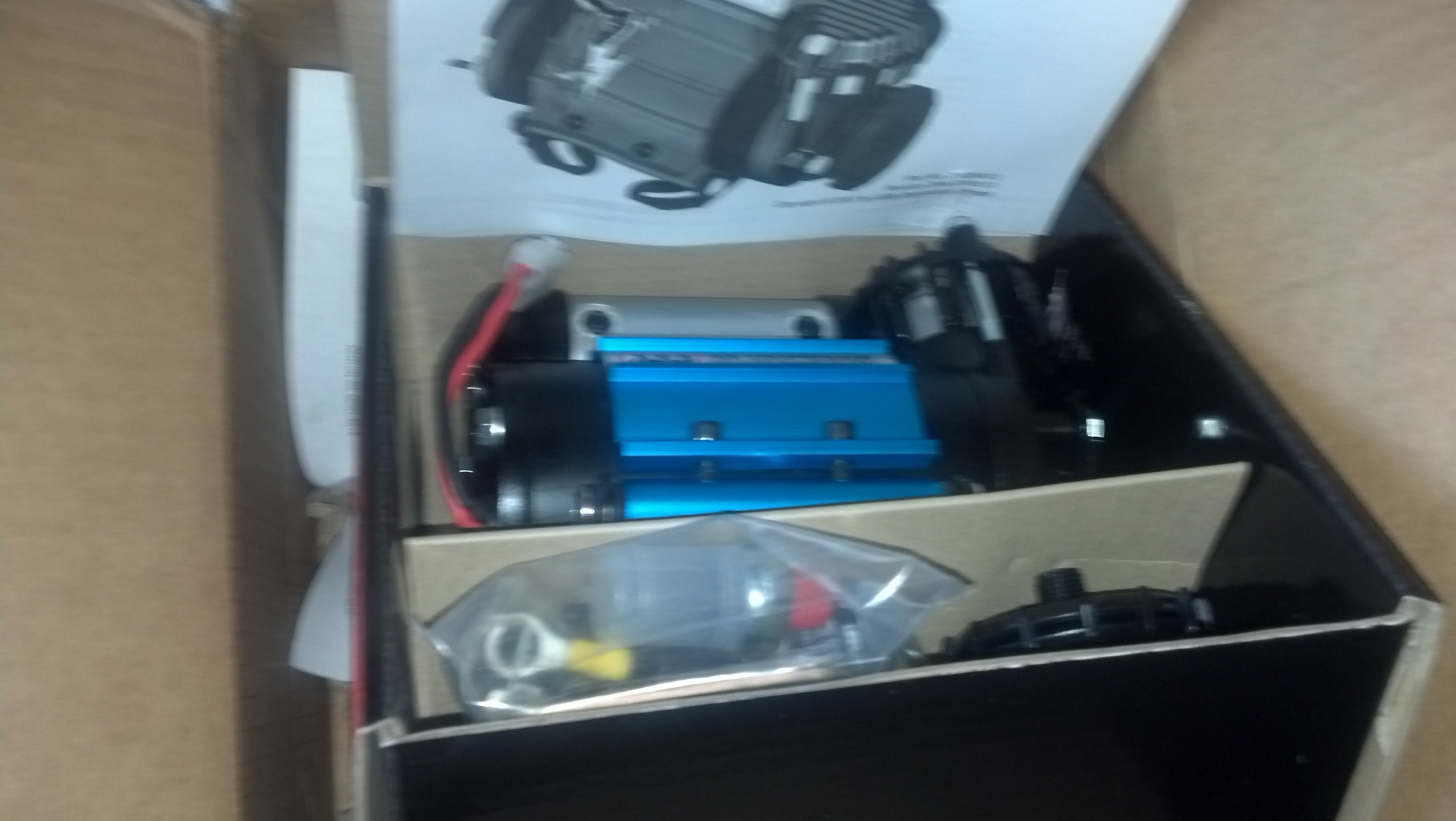

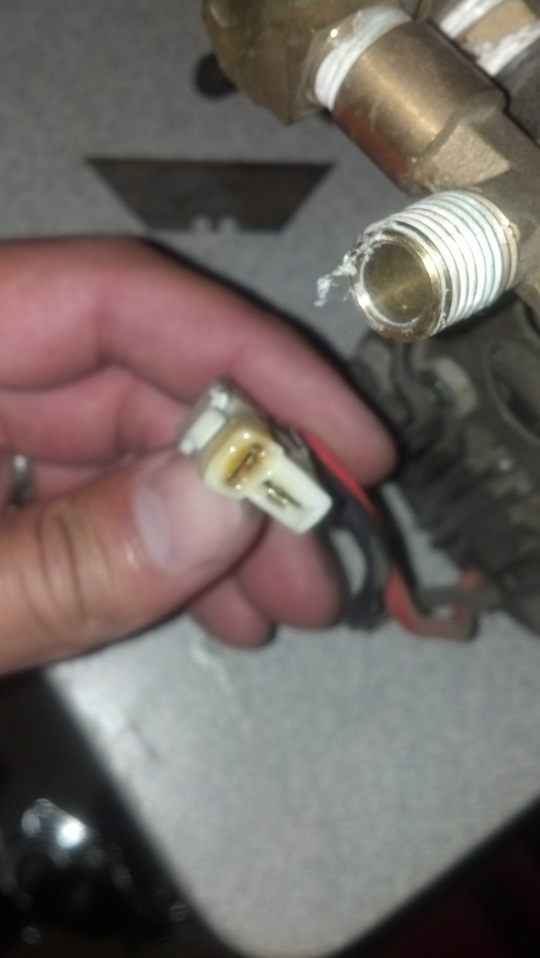

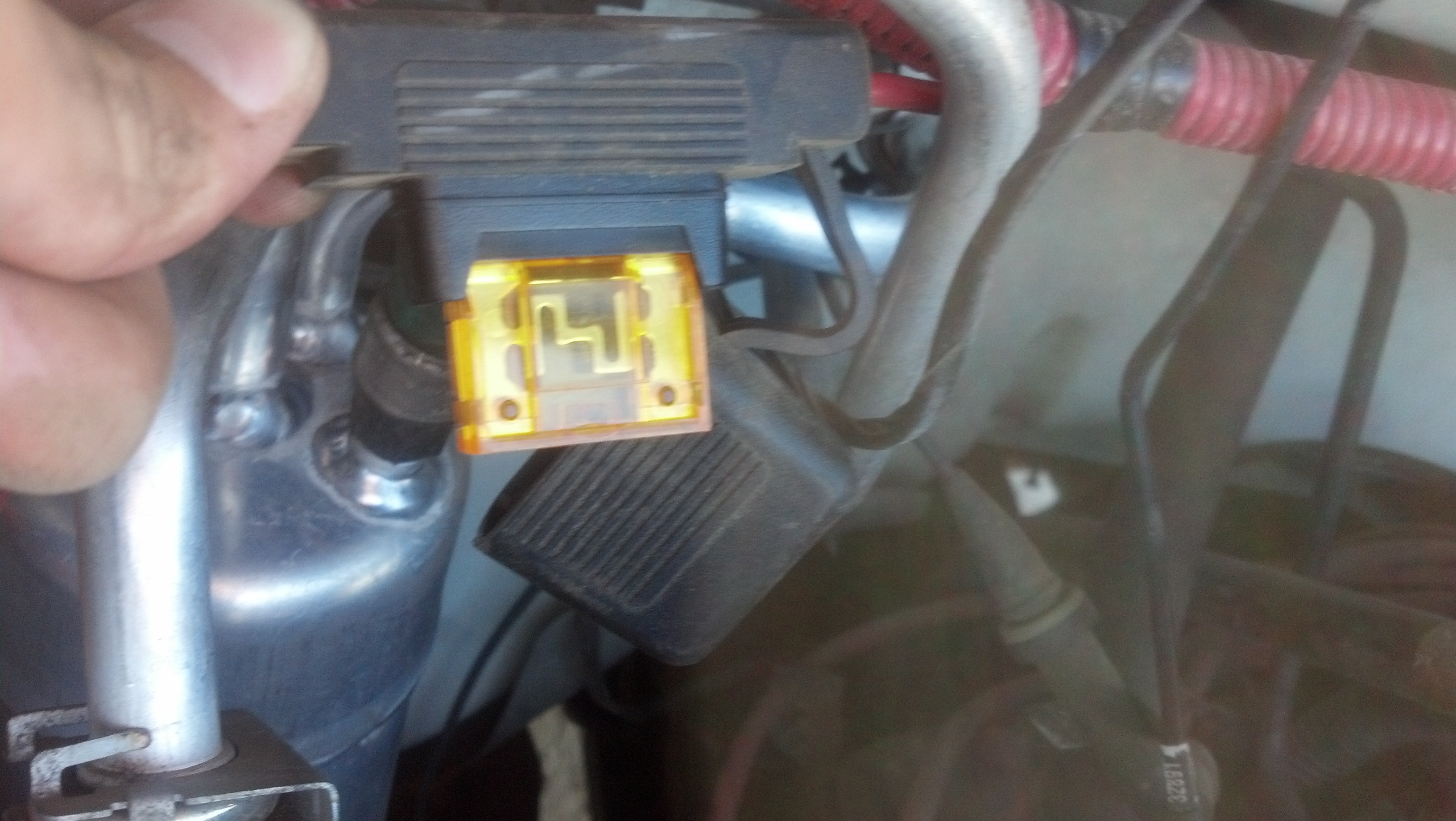

Here's the ARB CKMA12 appearing to have an overload episode....

I'm actually keeping the ARB pump (contacted ARB yesterday and they replied requesting those pics) to be used for the lockers only. It will also be a redundant air source if for some reason the York takes a dump.

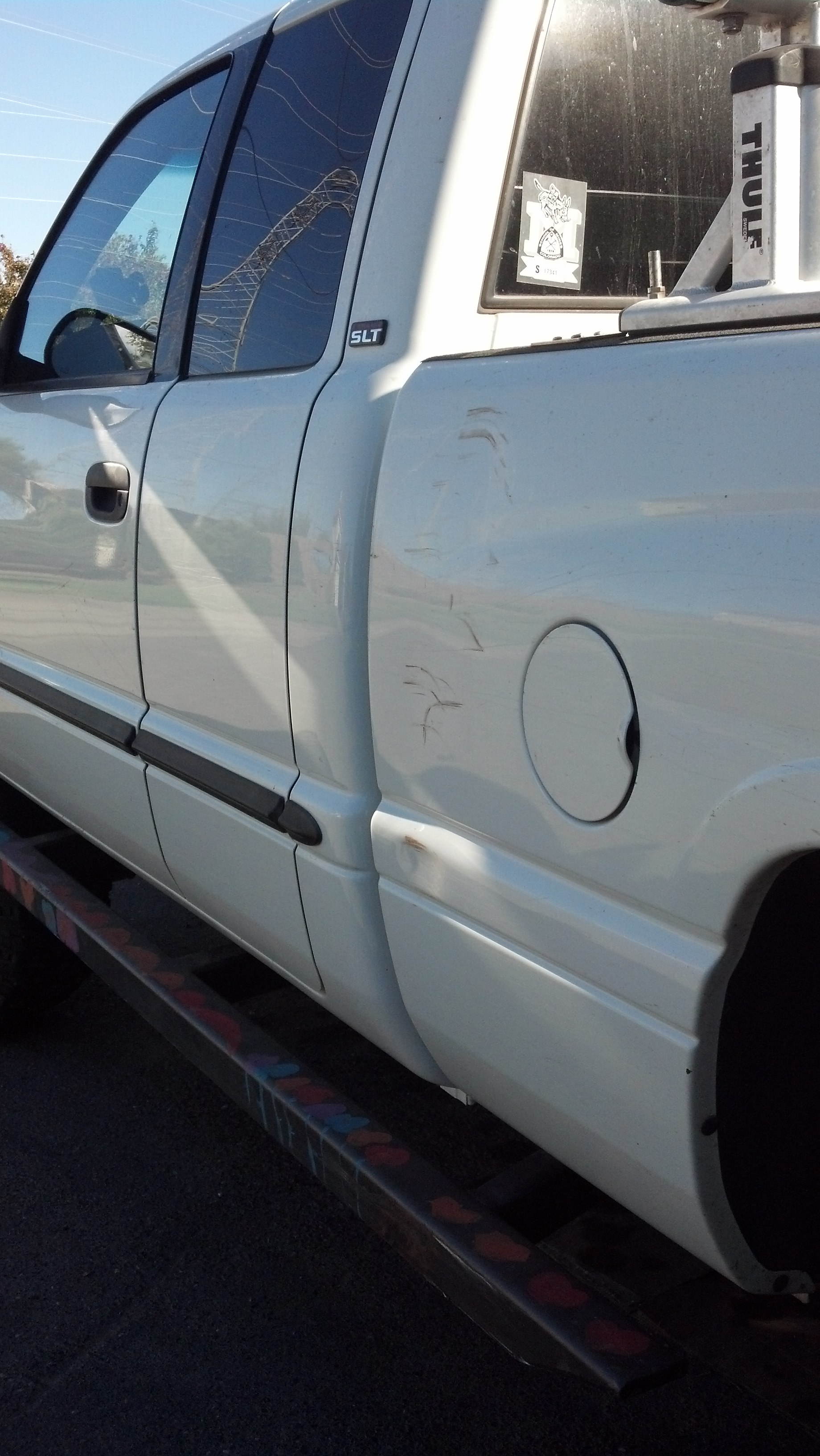

Hauled concrete in on a trail b/c the Enviro ***** were able to force the Forest Service to put a bridge in on a very famous trail. A trail that is only open 2 months out of the year even! wtf....
So, the club that manages this trail, since 1979, requested volunteers to haul 80 lb bags in about 1 mile. I had time to do 2 runs, 12 bags each. Bump stops are your friend. Trail was modified for the crew's excavator to get in. :/ Yet it was still a great challenge as no fullsize has been (reportedly) on this trail. Gate to it is only 83" wide....
As a result, I got 1 new badge of courage.
