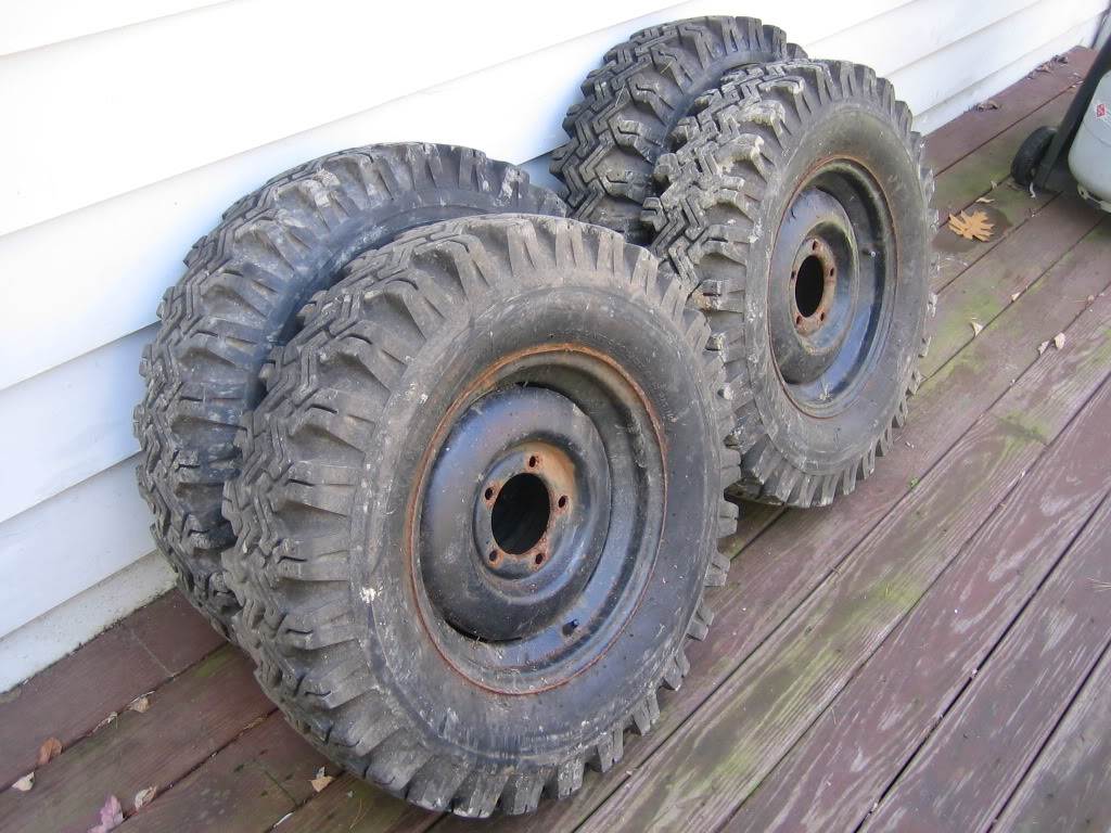

When you say skinny tire, what comes to mind in that kind of discussion are "pizza cutters".
Something like these
I have never run then and don't plan to. I've also not seen anyone run them. In order for them to be beneficial is for them to have a very large sidewall. That would mean a small wheel such that aired down you did get some flotation. However, for some snow conditions where the top is just too soft and there is a firm underlying layer, then I could see them having some benefit.
13.5" tire is not considered "skinny" aired up.

Notice the picture to show the width of those tires. They are basically equal to the width of the wheel. So...you're 10.5 is probably the top end of what would be considered "skinny" tire.
In the described condition example, this would mean NOT airing down a skinny tire. Airing down reduces ground clearance....plow boy time. Again, if we're talking about snow...then they are good only if the break thru depth does not impact ground clearance. If we are talking about mud, then skinny tires are always better.

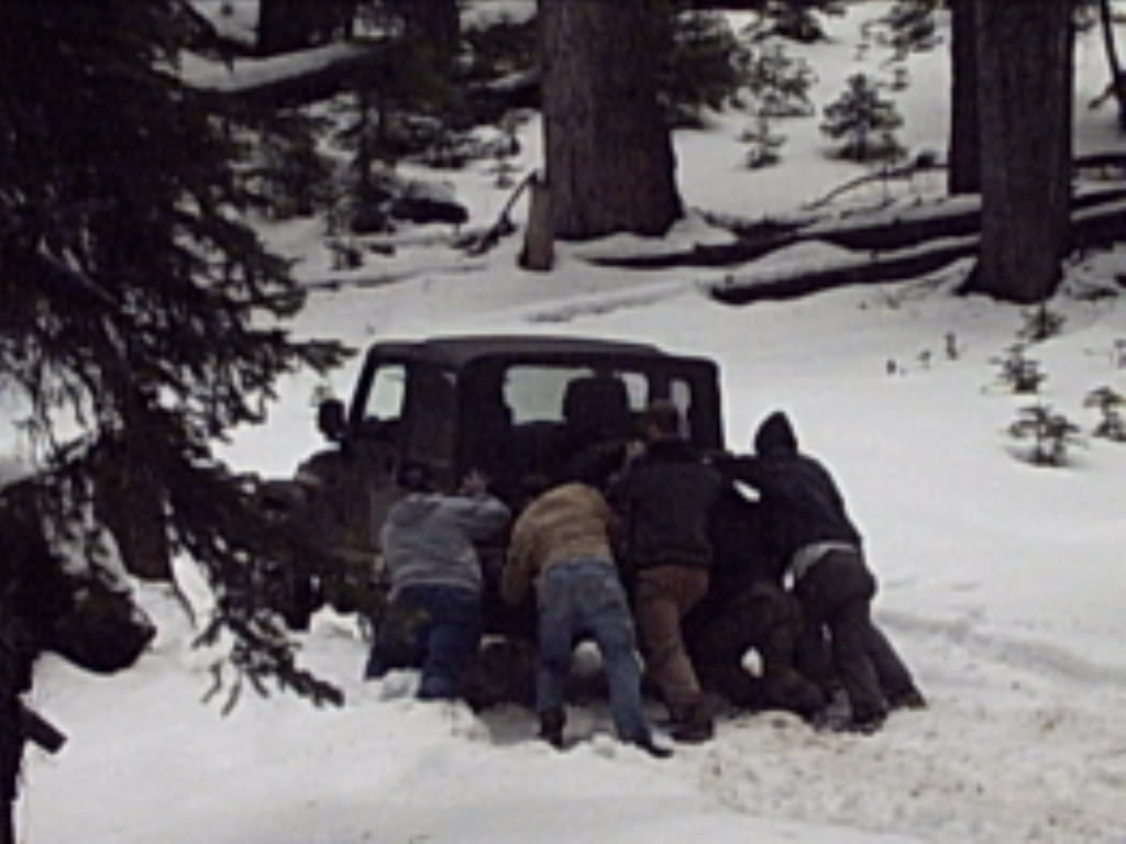

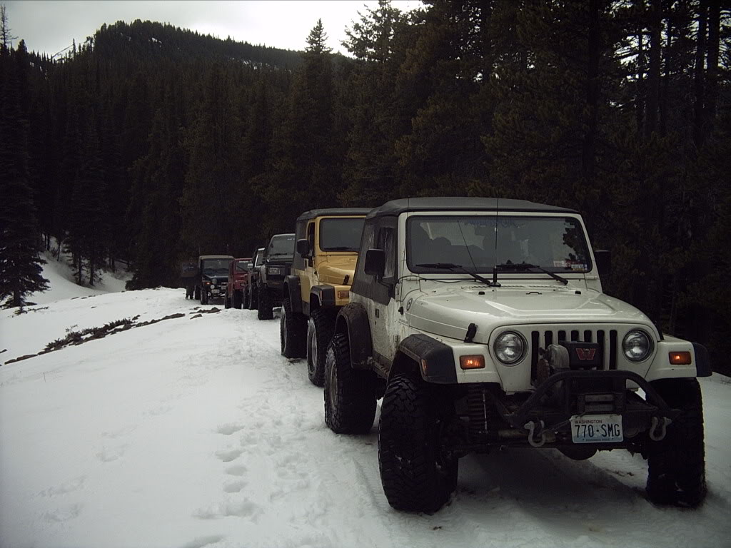

That is my experience with snow. If it isn't that deep skinny works better than wide. But if it is more than about 12-15" deep then you need to be able to get on top and float. Wider tires are the key.

My Jeep on this run was the only one that could get thru the snow. So I would climb the hill, turn around and winch the next rig up then turn around again and go up the trail until I hit a spot I thought people might have issues getting thru. This was suppose to be a 3-4 hour run. Started at 10AM and we got off the mountain on the other side at 3AM and not back into town until almost 5AM. I was still on crutches back then after being shot.

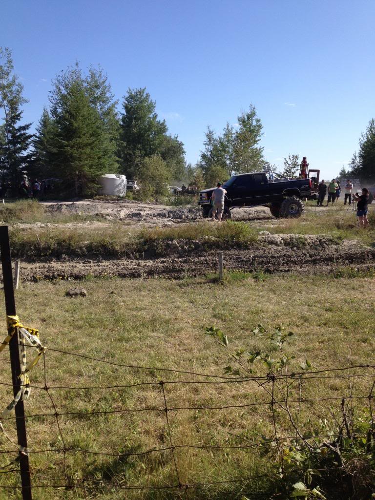

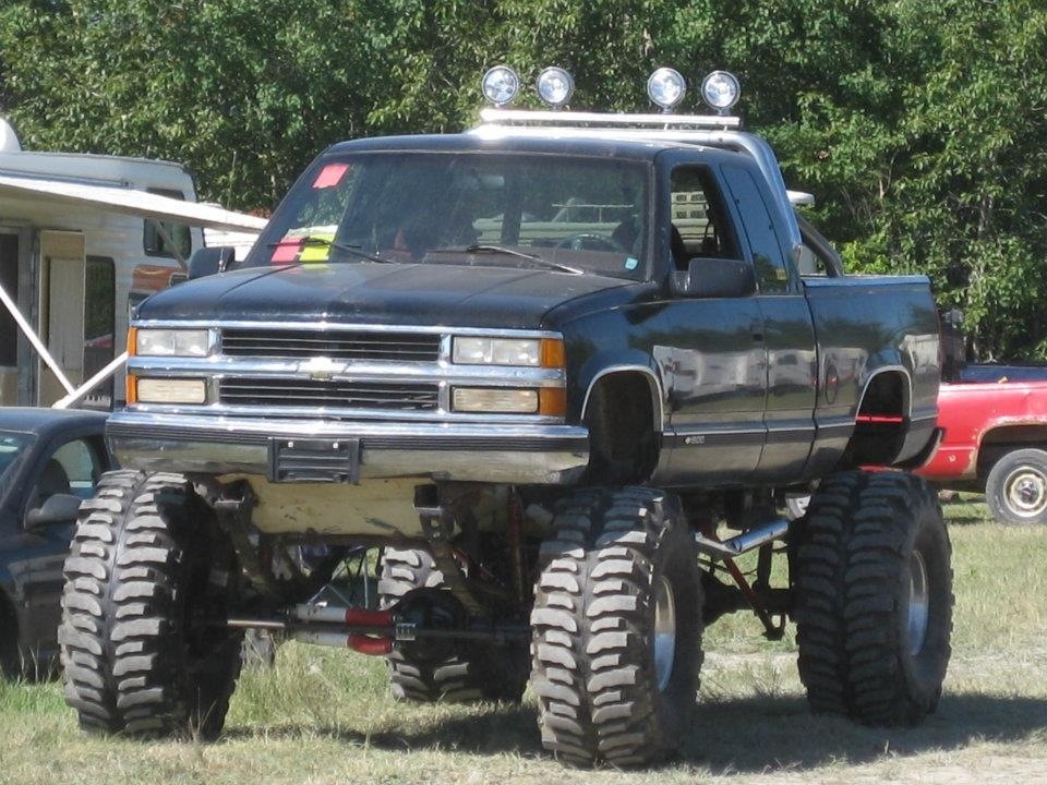

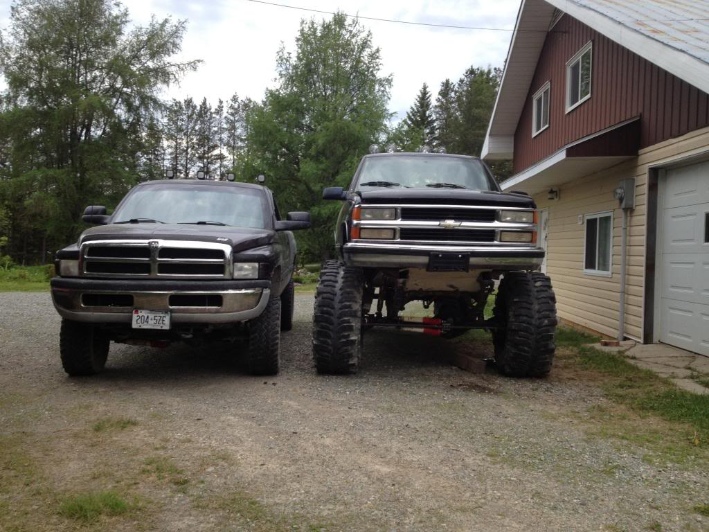

Since I was talking about mud bogging earlier I guess I should post some pics of my rig eh?

And of course I can't find any action shots

Are those the 44's is sporting in the pics? Looks like a beast

Holy Cow Thornloe, what country you plan on slaying with that rig? Auto, right? **smiles**
Nice PICS (love the last one in on the trailer too)!!! K
