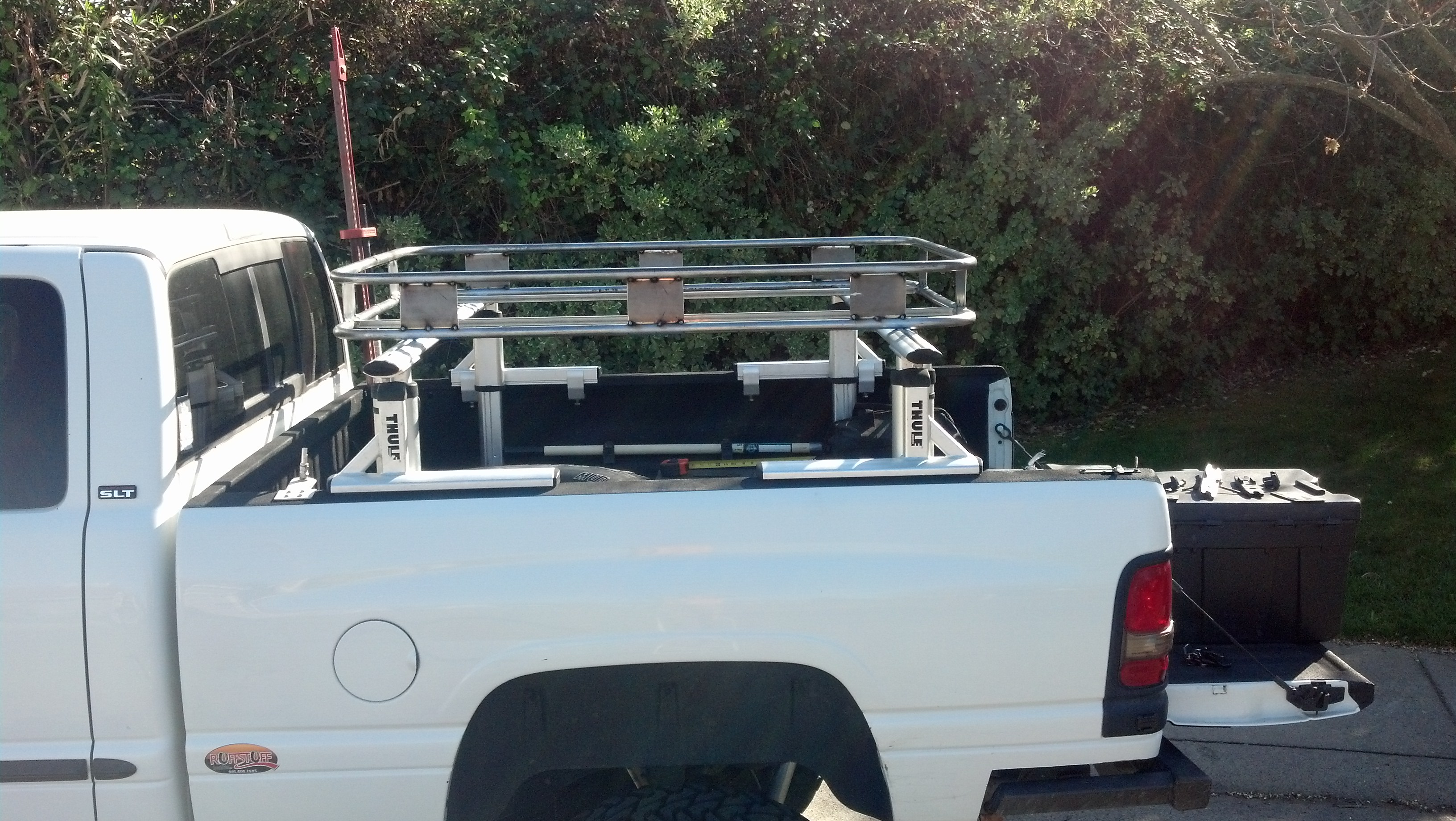

Basket mocked up on rack for the mounting locations. Looking to wrap most of the structural up with floor today.

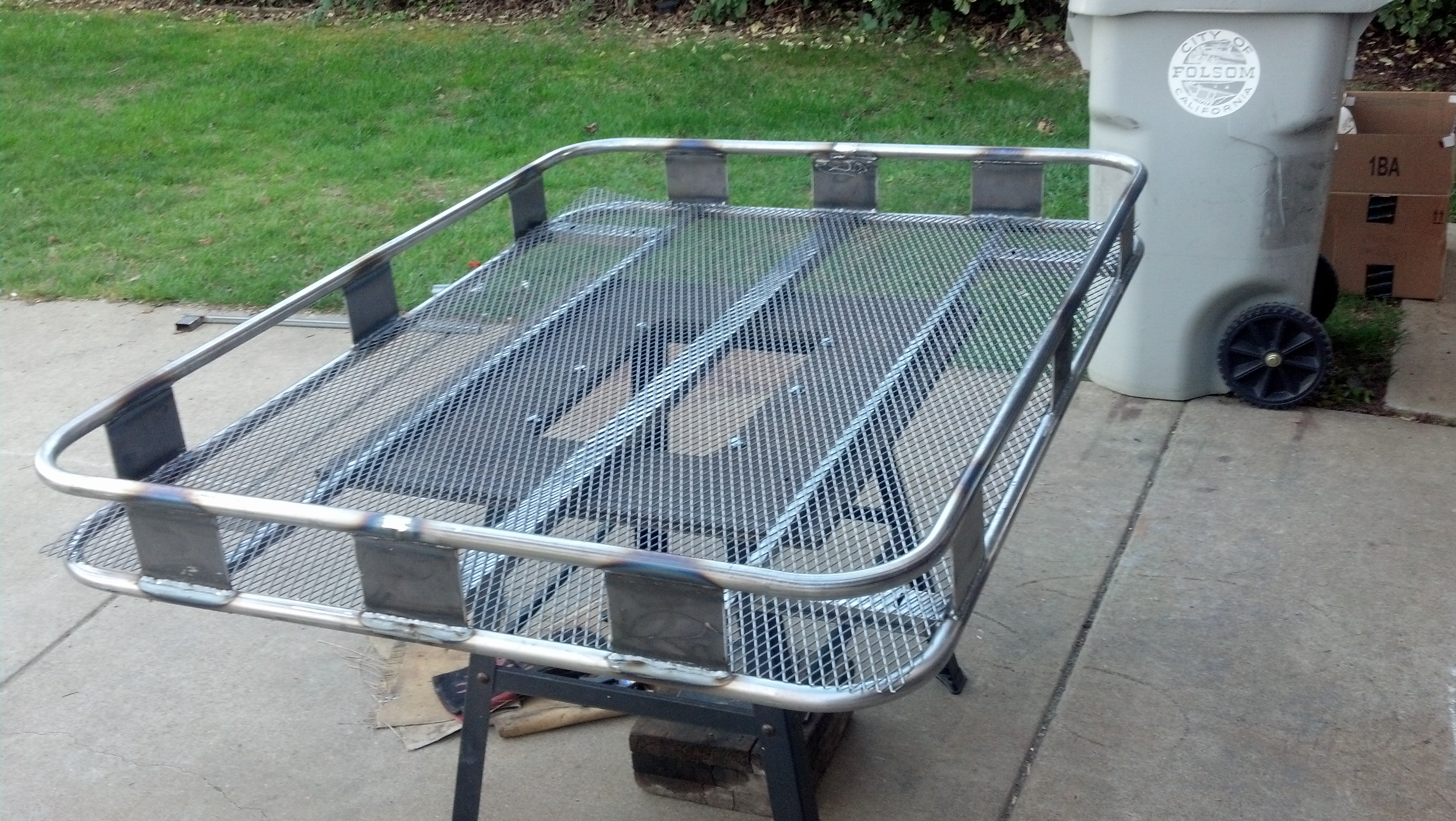

Here is my progress today...which amounted to more than 20 linear feet of beads. Gahhhh, I'm burnt. Literally was wearing shorts and my leg got light burned (sunburned).
Got the mount feet cut and slotted. This allows for further adjustment or even just moving basket forward/aft if need by for clearance bed items.

The setup I have to work with
One of the good welds as joining this thin stuff is tricky!! I was running 0.030" wire and got into a real good rhythm. This after starting bad welds (mainly run too fast) on the inside and the rhythm kicked in for the welds on the outside (the visible ones). hahah About 90% through I run out of wire. Toss in a new roll of 0.035" wire and have to learn that rhythm. bah!
Progress for today
Still need a few more pieces and then weld that mesh to it...
