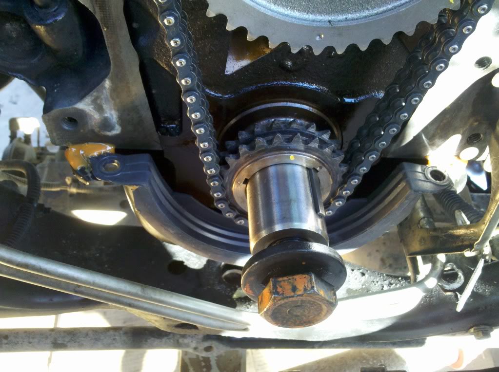

Grabbed this outta the other thread. It's in your best interest to set it to TDC comp stroke before you tear it down.
Agreed!
Merc...we are reminiscing!! lol
Cam gear dot at 6 o-clock and Crank gear at 12 o-clock
Check where the Rotor is and the Cylinder on Exhaust stroke for absolute confirmation.

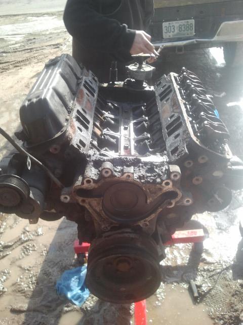

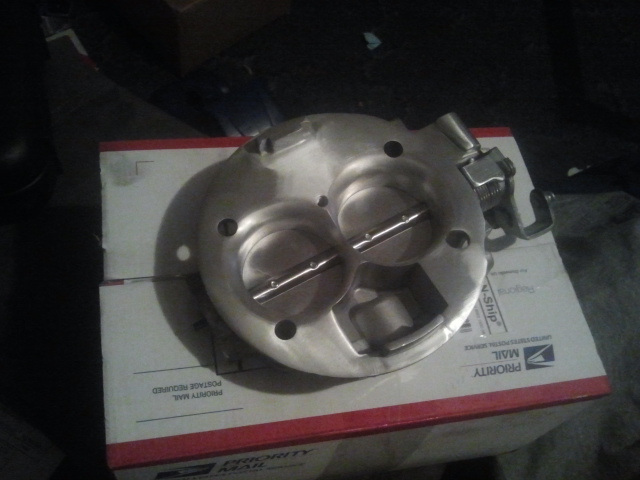

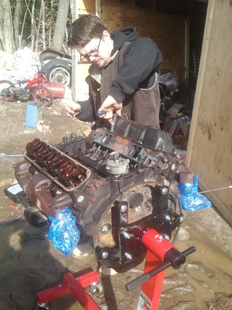

got the motor torn apart. i only got 2 pics so far. been an eventful day to say the least. only broke 1 exhaust stud all the rest came out clean! NONE of the intake bolts broke, not that it matters...
block is down to just the rotating assembly. new cam is going tomorrow, and will be getting the rest of the top end together tomorrow too.
got my 50mm throttle body in the mail today, thanks brian!!
pics
guy in the pics is my buddy thats been helping me all day.
ill get more pics tomorrow hopefully, have a good night everyone!
