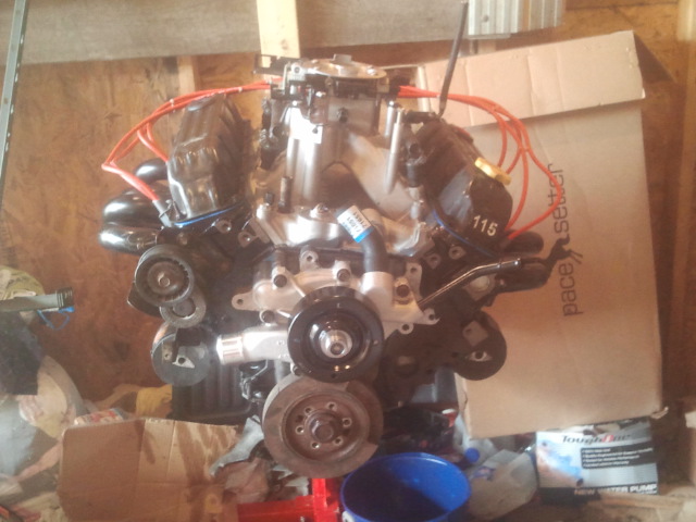

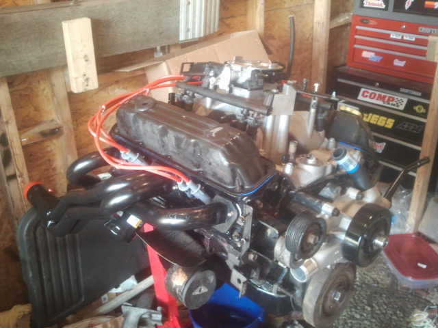

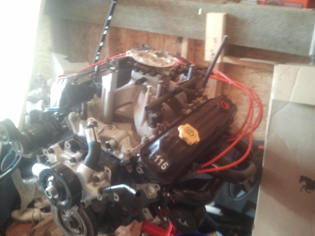

well, got the motor 90% finished up today! just gotta get some small stuff. new crank sensor, oil psi switch, water pump stud kit(somehow lost one of the long bolts), coil, and a thermostat, and gasket.
heres some pics.

also, any recommendations on thread sealant? need to put some on the threads for the oil psi switch, and adapter, also for water jacket plugs for the m1. thanks!

what year is the engine again? did you replace the injector? only reason i ask is cause those injectors look like they might use different injector plugs than your 2001 might currently have hooked up to the injectors.
motor is a 98, injectors look the same.
