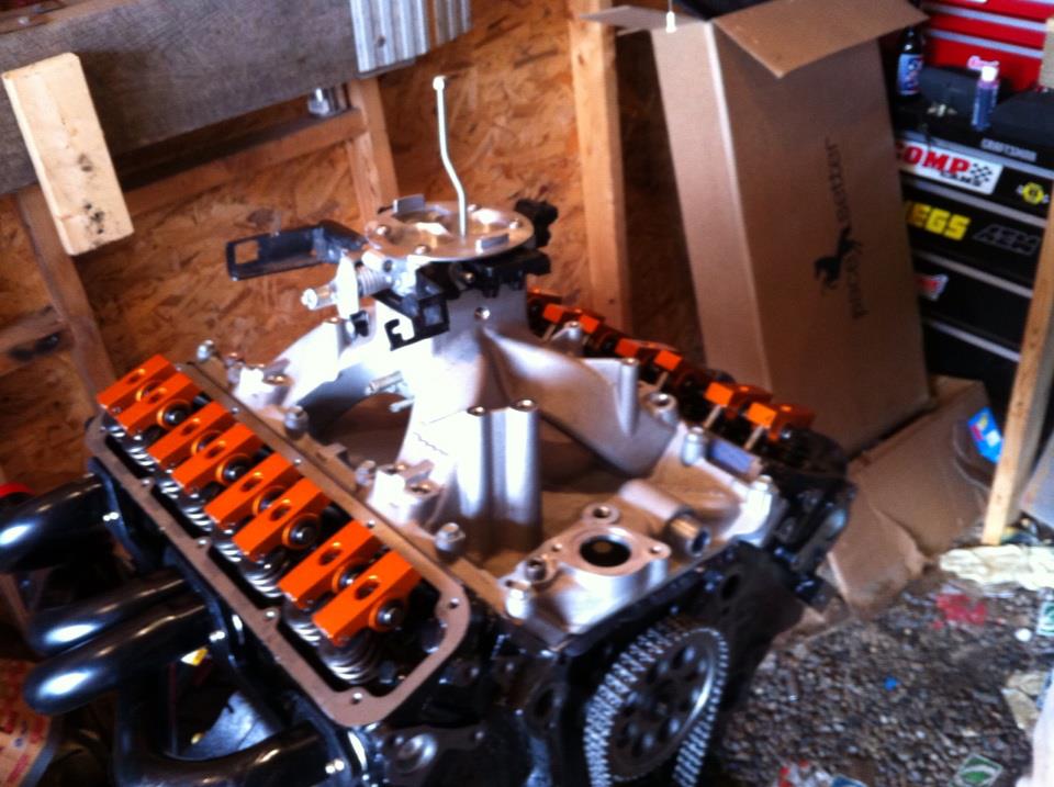

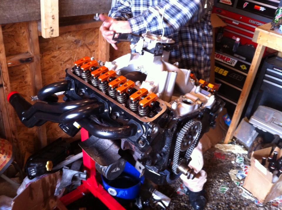

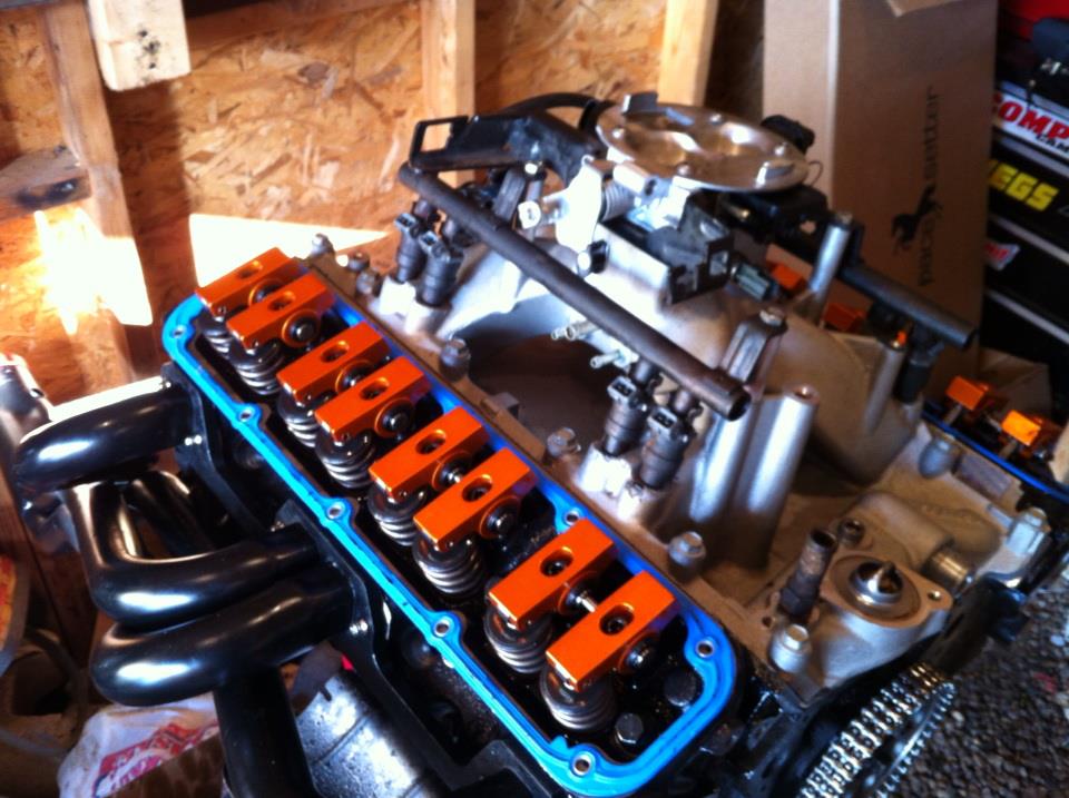

did a little more work on the motor today... headers are not torqued down, yet.
timing cover, HB, and valve covers should be going on tomorrow.

yes, i replaced the o-rings on the injectors!

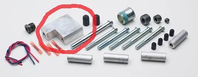

merc, there is an L-shaped block like "attachment" for the m1, what is it, and where does it go(item circled in red)?
