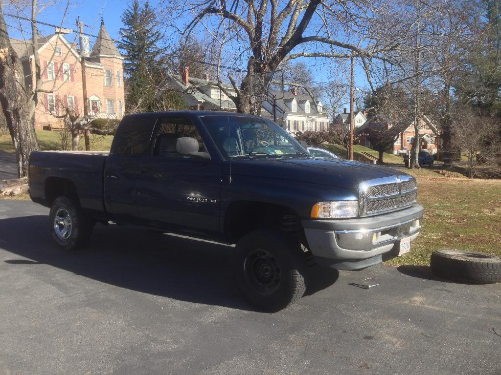

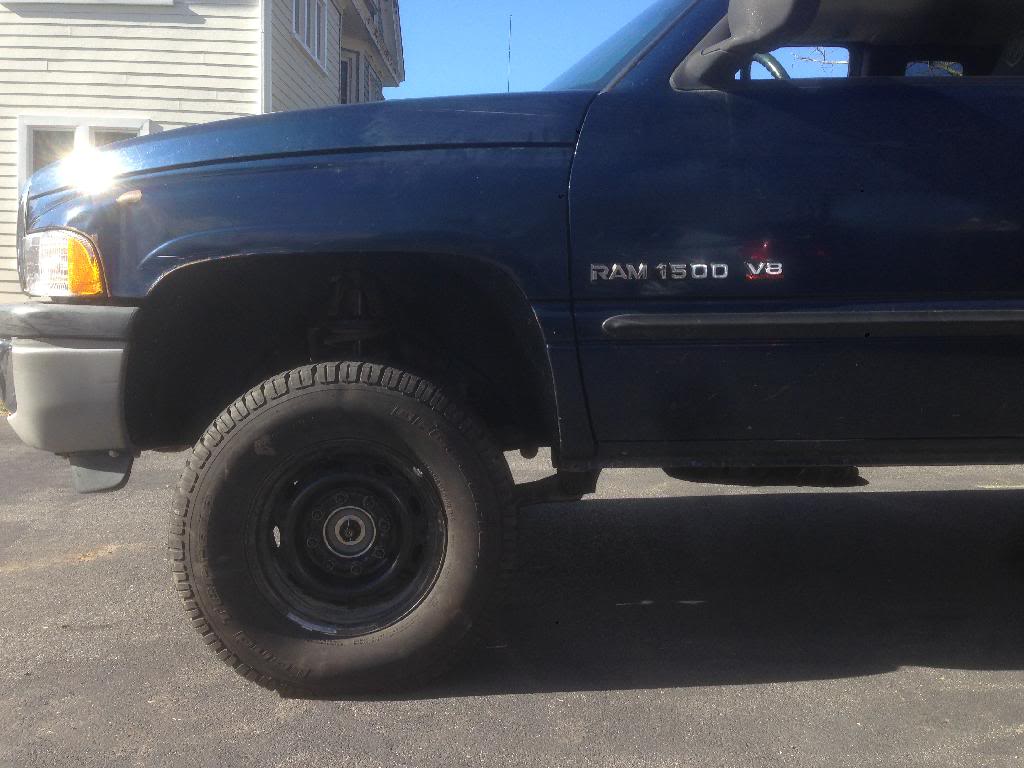

Got her back together. Took her a for a test run. And fang she tracks straight now. I need to center my steering wheel. And go get a professional alignment. I just eye balled it to get it good enough to drive to the shop. Truck actually sits a little taller I think even with the slightly smaller tires. Or at least as high.
I have a MASSIVE clunk in my steering column now. Guess it's time for the Rock solid ram fix.

Forgot to add. She brakes like a champ now! Those 2500 calipers are larger. It will brake even better when I put the big master cylinder on when I do the rear. It has discs too!!!
OOPS I meant to edit that, not quote it. Oh well. I don't have a steering stabilizer right now either.
