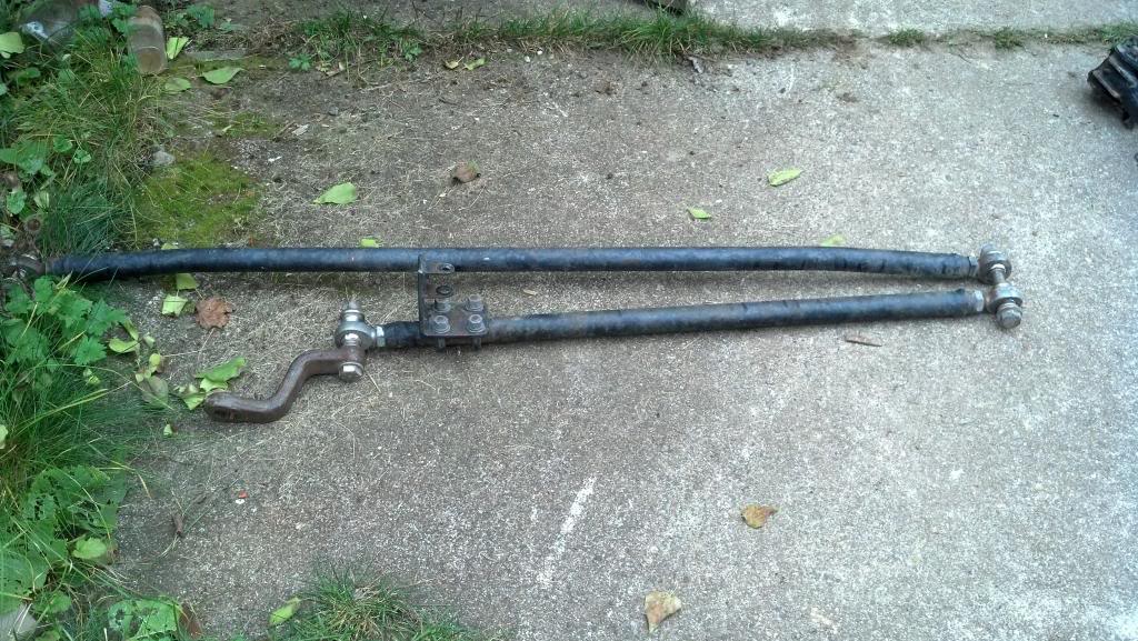

I can't use a Heim ends on the roads out here for steering not copacetic.
So you want this style lol I cut it up for upper control arms and a soon to go in track bar.
