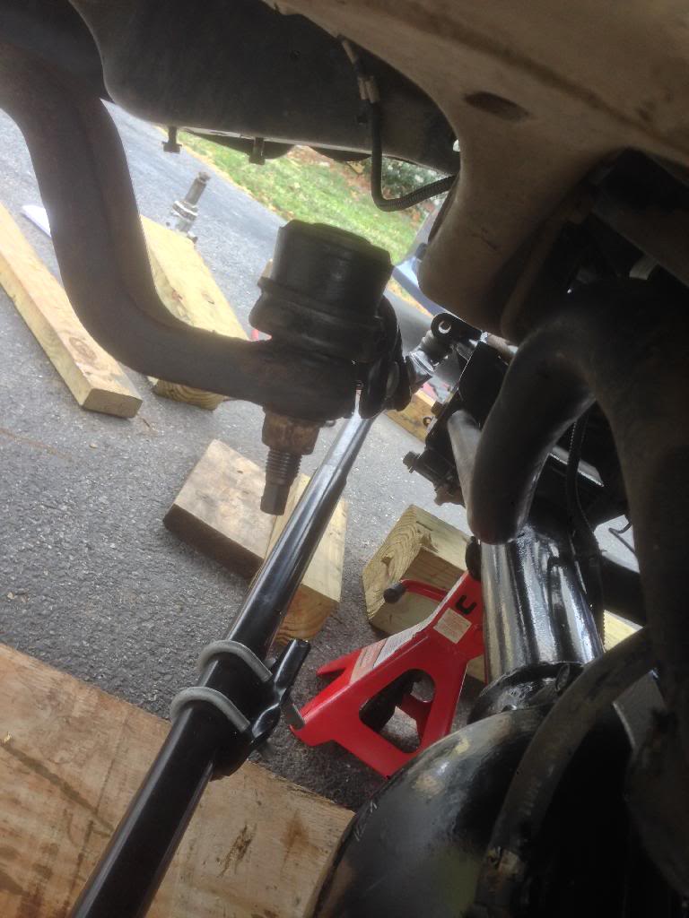

Is that enough clearance?
Old Dec 30, 2013 | 12:55 PM
  #224
Posts: 87,566
Likes: 4,232
Yeah, no problem. The steering box isn't going to move, so, it will never get any closer there. You are golden.
