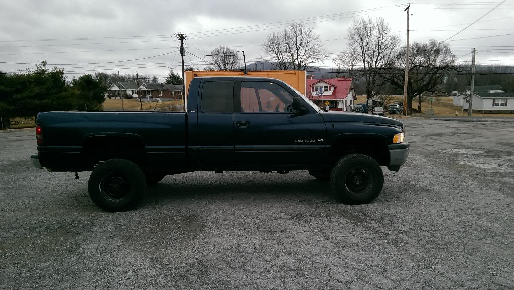

I like the black wheels I think I am just going to paint the hub caps I have black and throw them on and call it done.
Just for reference this is what the truck looked like when I first got it from my dad. Obviously its completely stock

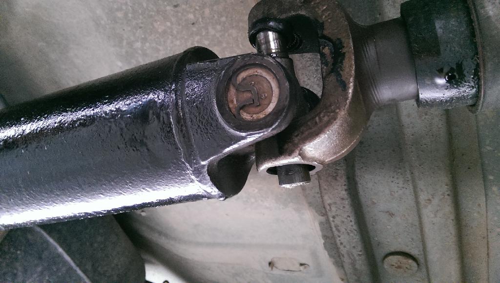

What happened here? Clips fall out?
yep. After I took the yoke off and inspected it there was a bunch of gunk and metal shavings preventing the clip from completely seating.
I cleaned it all out and put it back together. I made double sure to check for proper clip seating this time. Lesson learned no harm done luckily.
Old Feb 10, 2014 | 12:45 PM
  #334
Posts: 87,453
Likes: 4,218
Yeah, tossing your driveshaft is never fun.....

It vibrated like crazy. I pulled over immediately. Glad it didnt trash my rear end right after doing all this work.

I've had front axle U joints like that, the clanking sound when going slow was a dead giveaway. I also got lucky and no damage done, but the potential is there for a bunch of it.

We both had rear DS issues with this swap lol at least you did not have to get towed like I did.
