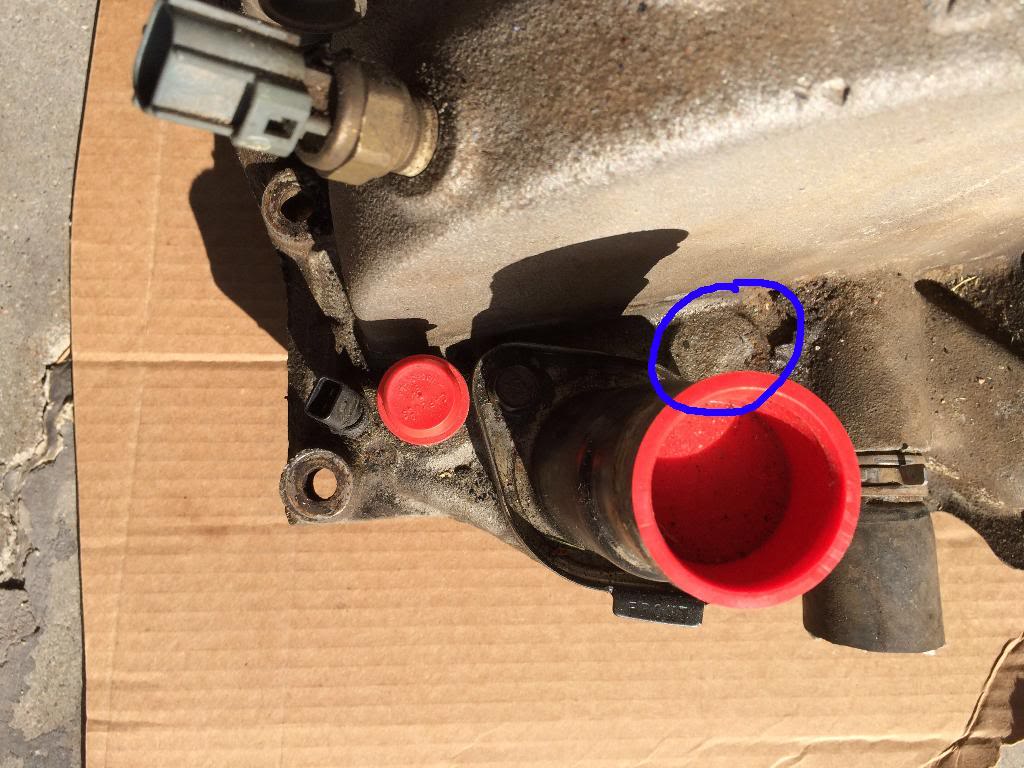

Yep, both on the intake, one just outboard of where the heater hose hits the manifold, and the other just to the drivers side of the thermostat housing.
I ran into a problem. It looks like my durango engine has only 1 coolant sensor on the intake. I looked at my truck and found the other one on the driver side of the thermostat like you said. I looked at that spot and it looks like the durango intake has the boss for that sensor. Should I just drill and tap a hole there for the other sensor?

what year is this? I could be wrong but im pretty sure i dont have a sensor to that side of the thermostat.

The engine is from a 1999 durango.

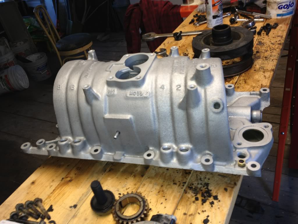

well this is my kegger from my 01
as you can see both of my sensors are on the left side

It looks like your intake only is made for 1 sensor like my 99 durango's. They must have went to 1 sensor somewhere along the line. I also like how you painted that. I want to do that to mine.
