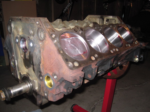

Originally Posted by snowboundrmk
Well I got all the pistons in but when I torque the #8 rod cap to the 45lb spec the engine locks up and becomes impossible to turn over. The clearance is in spec so I'm gona mess with it some more tomorrow and try to figure it out.
I will guess you've got some caps & rods mixed up. Ask me how I know this? Because I did the some thing not too long ago. I would have sworn I had done a awesome job not getting the caps & rods mixed up but sure enough I did. As merc said make sure you've got the chamfered side going the correct direction and also look to make sure you've got the caps & rods with the correct one.
Old Sep 25, 2013 | 11:53 AM
  #74
snowboundrmk's Avatar
snowboundrmk
Joined: Mar 2013
Posts: 835
From: Fargo, ND
Sounds like a good idea. I never did check the rods with the caps. I just put the numbered caps on the right journal and figured the machine shop put them with the right rods.
Old Sep 25, 2013 | 12:50 PM
  #75
merc225hp's Avatar
merc225hp
Joined: Oct 2009
Posts: 4,717
Likes: 10
From: N/A
Left it to the machine shop.... not good. One should always mark the cap and rod on the side with a corresponding number before taking it apart, this keeps them as a matched set. You match the numbers up to the same side and then install the pistons/rods/caps.
Old Oct 1, 2013 | 05:44 PM
  #76
snowboundrmk
Joined: Mar 2013
Posts: 835
From: Fargo, ND
Ive been messing with it for a while and I think the the caps are mixed up. I used a micrometer and the journal was good so I looked at the rod and the cap hangs over the rod on the side the journal is on. So it's not a perfect circle. I wonder why no other rod would lock up when I torqued it then?

Old Oct 3, 2013 | 11:41 PM
  #78
snowboundrmk
Joined: Mar 2013
Posts: 835
From: Fargo, ND
Caps 6 and 8 were switched around. I did originally mark everything with a sharpie and the machinist punched it for me. He must have read it wrong, but anyways it spins great now.
