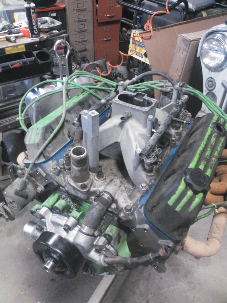

Well I guess my friend already took the old sensor out. The wires were pinched/cut. So I have to fork out $50 to get the new sensor and "should" get it in Saturday! But here are some pictures of the install for you pic ******! I'm terrible at taking constant progress pics because once my friends start working, it doesn't stop haha.

New motor all bundled up! I know it isn't clean, I cleaned all of the gasket surfaces that I needed. My theory behind it is that this motor will not stay clean. It goes off, over, under and through the road. Didn't want to spend time making it pretty.
