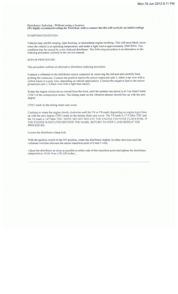

The standard post I put up about fuel sync. In your case I would not mess with the meter way use a scanner. As you can see it will cause a miss if not set right.

I talked to a friend who has a scanner that can do a fuel sync, he just needs to know what I need to set it to. Considering that I have no idea what this means, I'm hoping you guys could help me out!

You want to set the fuel sync to "0" or as close to it as you can. You turn the distributor to adjust the fuel sync. On our engines timing is taken care of by the ECU so turning the dizzy doesn't have any affect on timing. Kind of throws us old school guys off a little. The dizzy controls the fuel sync.
The fuel sync tells the computer when to fire the injector. From my understanding you want to set it as close to 0 as you can for a factory motor. Then depending on mods sometimes the vehicle performs better to have it fire before or after the piston is at its TDC. Its one of those items you set it at zero and try it out, depending on the size of the cam you may want it to be higher on the plus side. Most of the dakota guys with cams try theirs somewhere around +4.
