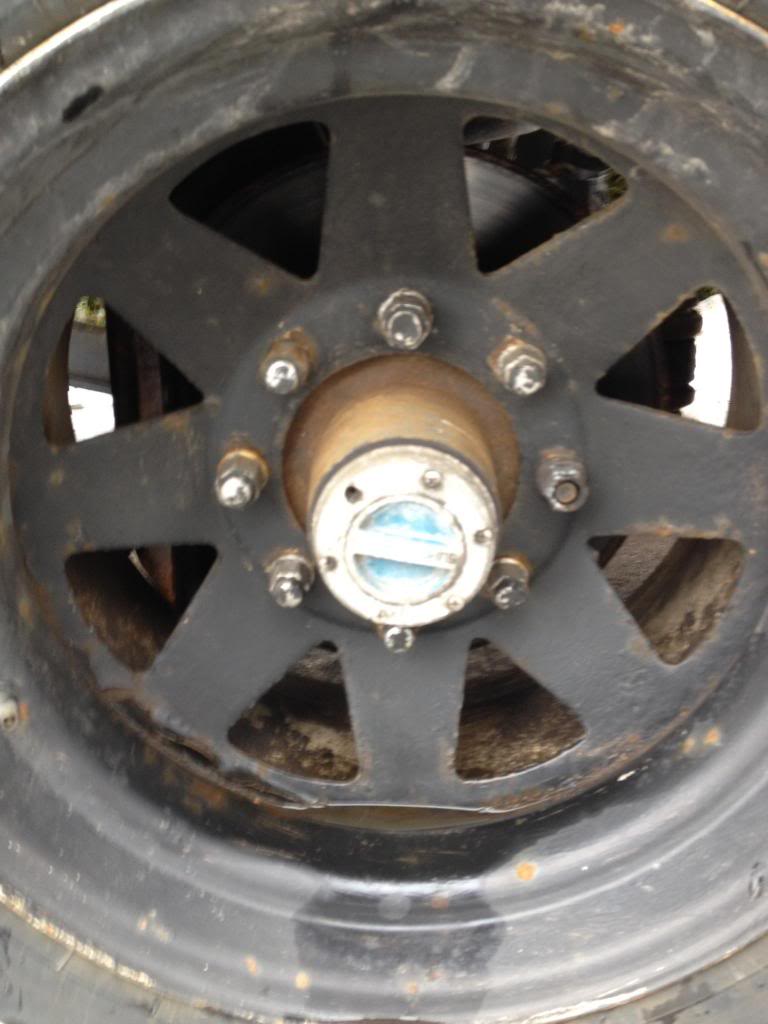

Lockers on the hubs probably mean locking hubs. Dodge hasn't had locking hubs for awhile, and for sure not in the 2nd gen ram. Similar year fords did, my dad's 97 f350 power stroke had locking hubs. Or he mean locking differentials. Either way, it mean it has had serious work done on it. Or he has absolutely no clue what is going on with it.
Old Jan 12, 2014 | 11:47 AM
  #52
Posts: 87,482
There are locking hub conversions available out there in the world. They ain't cheap either. Easy to see if it has them or not though. Just look at the front hubs. If there is a **** you can turn there.... locking hubs. If not.... well, then it is something else. have to go digging to see exactly what.

Someone most likely installed Ford Knuckles and the part time hubs. This is a good upgrade well worth it in my books. I have plans to do this on my 60 as well.

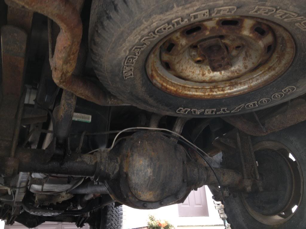

Okay got some pics of the axles.
It's a little rusty under there but I'm okay with that. Any truck I get is getting the sandblast and paint treatment on the frame anyways. Can anyone help me figure out what these are? The front almost looks to me like a 44

Pass just walk no just run away. I see all kinds of iffy things going on, one is the bent pitman arm, next it has heim joint steering big no no for the street, missing part time hub allen screws, then stacked blocks, mickey mouse rear shock brackets, messed up brake lines and thats just whats in the pix. So much money has to go into it my offer would be $1000-$1500

And thats why I love getting your guys opinion on these things.. Will do. Thanks. The body was a little iffy anyways. Are these axles even from a 2nd gen ram?

The front diff is, but someone has done the Ford knuckle conversion on it, the rear I have to go look at pix of diff covers to see what it is, it might be a Dana 80 "might" that is.
