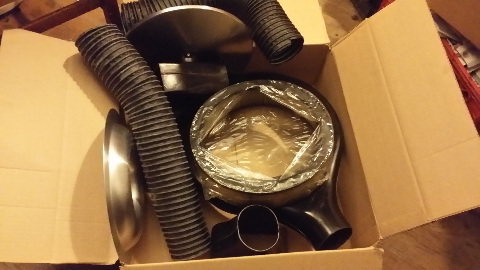

It has arrived.

Default It has arrived.
Probably won't install until the weekend. I've never purchased a cold air kit for any of my vehicles prior to this kit. The website makes some pretty strong claims about what this thing will do for me. Can't wait to find out how true the claims are!!!

By the way...in case it isn't obvious...this is a Ramair kit made by Ramair.
