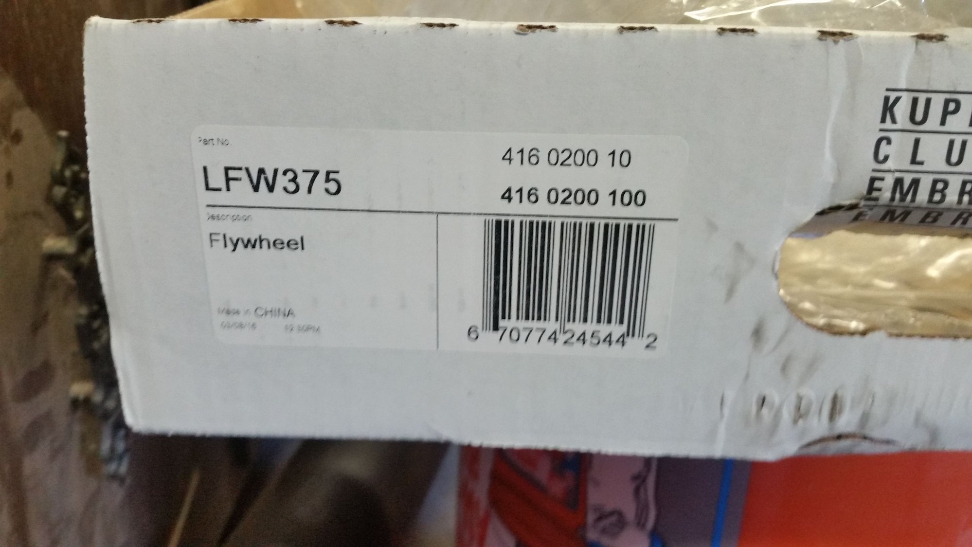

Woo-hoo!!! Flywheel showed up today, and it's even the right one thankfully. $140 total through Amazon. It wasn't scheduled to arrive until friday, but it showed up about 20 minutes before I got home tonight. Here are a few pictures:
Little different than the last one
Full view of side panel in case someone wants the qr code.
Close up of part number for easier reading.
Thank you for the help on this thing. I was going nuts trying to find the right part. Hopefully I'll get it stuffed this week. Might be fun since it looks like a couple 14 hour days at work this week.
