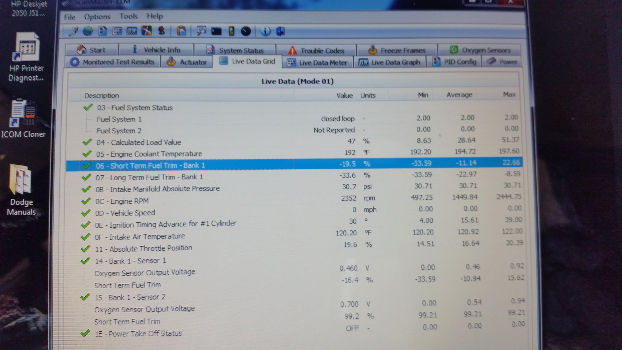

These are all napa echlin sensors.
The cam sensor was the culprit for the 3000 rpm cutoff. The MAP sensor not being plugged in might have had something to do with it too, along with the MIL code. Oops
I've been trying to load the video I got before I found the MAP sensor, but either my phone is being slow, or my Internet is really dragging. 3+ hours to load a 5 minute video just isn't cutting it.
Took a picture of the info my laptop was giving me. I think this was after changing the cam sensor, and before I found the MAP sensor unplugged.

Yeah, that seems to be pulling a LOT of fuel....... What dod the numbers look like now?

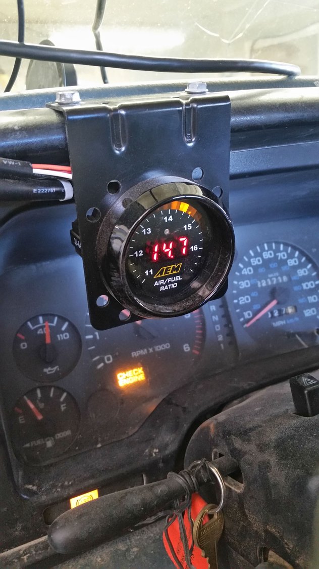

Finally got the video to load. I tried to catch the sound of the exhaust, but it didn't work.
It sounds even better now with about 100 miles on it... and all of the sensors working. You'll notice the A/F ratio running around 11-1. After I stopped recording it was around 14.6. By product of the sensor I guess.
This still without Ryans tune.
Little better
I also noticed that the manifold absolute pressure reads as a psi, guess that's just how the computer translates it. The psi reading there is truly in/hg (inches/mercury for those not use to that code) and is accurate according to my old vacuum gauge.
