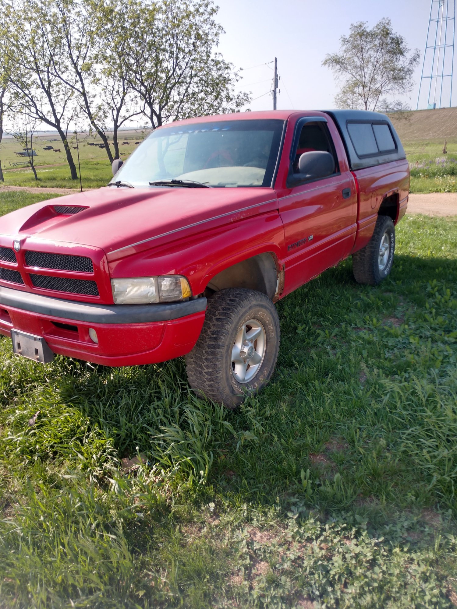

Well just picked up this truck last week, finally giving it some attention this weekend. Its a 98 1500 Sport 189k 318 Auto 4x4 Regular Cab shorty, which I've always wanted one for a build/toy instead of have a sxs or something. PO states it was burning oil and when the water pump started leaking he just parked it and bought a different truck. Been sitting probably 3 years he said, which is the last time it was licensed. Surprisingly i dropped a battery in and it fire up like it ran yesterday. With a signature blue huff out the exhaust so no lie about burning oil, suspecting valve guide seals and/or plenum plate.
Pictures to come, has a nice aftermarket functioning ram air hood, somehow a mint perfect dash ( probably until i try and wipe it off) decent seats. Relatively nice interior besides being really dirty and smoked in. He threw in a nice cam he had and a new rear bumper

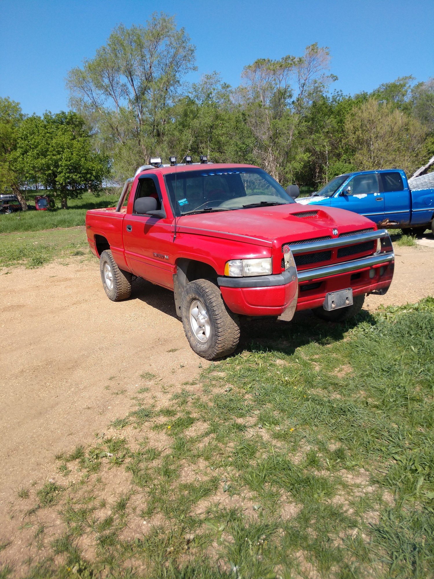

Started some aesthetical mods, roll bar push bar, tried adjusting the hood but looks like its just gonna be a poor fitting fiberglass hood, got the new sport bumper to put on yet also

Also in the works will be rims and tires, eventually paint after i decide on a rust repair plan of attack, rebuild the steering and deciding if i want any more lift, its got 33s on it now with a front spacer, was kinda leaning towards 35s, kinda waiting to see if my 15s can clear the brakes on these, they fit my 94 ok

Sounds like a solid plan. Just be aware that depending on how mild that can is you will need another tune. I am jealous of that bull bar though lol
