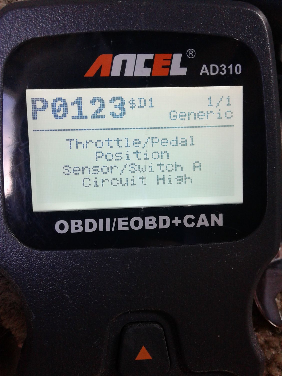

I checked all the pulleys they seem ok, I did get this code today, any ideas?

Posts: 87,483
Can you read live data? If so, see what TPS has to say for itself.

Posts: 61
14.9 - 77.6 this was engine off, the engine light is on again I tried reading the code and it gone, it says no pending codes stored or pending with the engine light on

Posts: 87,483
Some codes will reset if the conditions that set them initially don't happen again for X number of key cycles.
