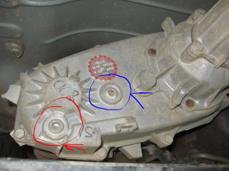

When it's cold you don't want it at the top of that line. You want it in the middle. Thats what I was always told. When you check it and it's hot it will be towards the top. Well, anywhere in the safe zone even the top will probably be fine but whe cold don't you want it in the middle? Anyway mine only takes 5 quarts. Anymore and I'd have overfilled it.
BTW for the transfer case I thought I'd just post this picture for you since when I did mine the Haynes manual was the most worthless POS I've spent money on. Well, actually that has been the case everytime I've tried to use it. I hate that thing and wish I'd never spent the money on it.
Anywhere the red here is the drain plug and the blue is the fill plug. Just thought I'd post it so you knew where the stuff was.
