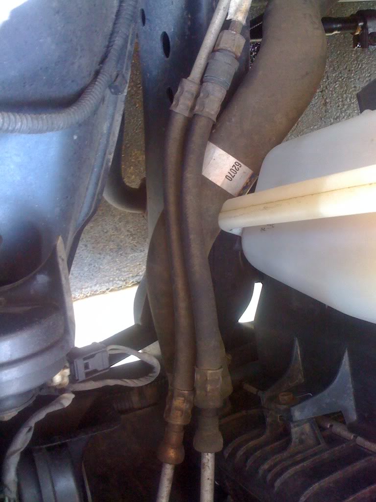

hey just had a question about this valve. i took a pic today and noctied mine wasn't matching your pic from page1. i see your end runs directly into the radiator. mine however does not and it looks like it runs into the condensor. am i looking at the wrong hose?
from this pic, do yall understand what i meant above^? tia

Can't see pics on my phone but ill wager you're referring to the aux cooler. Do you have 2 parallel metal lines that run up at about a 30* slope on the passenger side when you look at the truck from the front with the hood popped?
I changed the flow of the trams fluid to go into the rad first, then the cooler. That is not the stock configuration.

yeah those two metal parallel lines are what im talking about.
dang that sucks that its not a stock config. well, your number one pic anyway. i don't even want to mess with drilling into the side of the radiator but its a smart idea that you have set up

From the sound of it you have the tow package with the aux trans cooler. Squirrels added the extra cooler for added cooling capability. Nothing wrong with what you have from the factory. That's my opinion.
well if thats the case then im squared away. didnt know what aux cooler was for

Ok, so that means you should have a radiator, a A/C condensor and the aux trans. cooler. Not sure of the order but those should be the three you have up front???
With the tow package, yes. But, not necessarily in that order.
