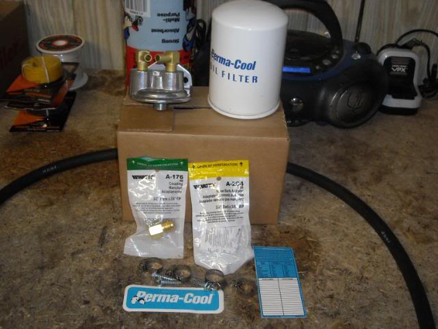

im new on here, and got the lowes fittings purple mentioned, and now what, dont really see how these two fittings are going to work.....any pics.

yes it is full of pics, but if you will read my reply it is purpldodge's 2 fitting method in question, not aim4squirrles, all the pic are of aim4squirrles. thanks for the reply though.
heres the post:
I dont have to put it in neutral.
Here are the fittings I used, so I don't have as many parts.
Fittings A-176 and A-204 from my local LOWES.
