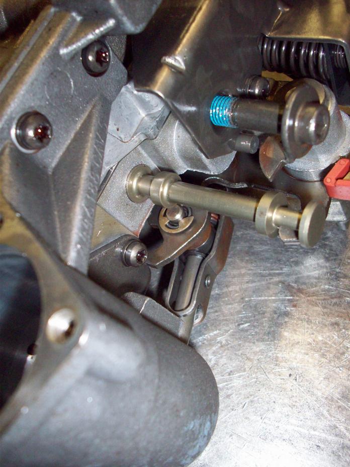

Here is a pic of the E clip that holds the rod.

ahh, a picture's worth a 1000 words.
The sonnax kit comes with a replacement e-clip in case you loose or break the one you had.
I take it by the pic you should remove the manual valve and then pull the clip out. reverse on install.
