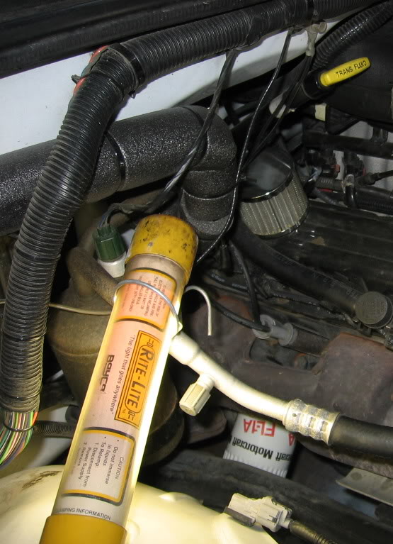

Something just doesn't feel right about this. But it fits.
And my hard core Ford friend had a jaw dropping experience when he saw it.
