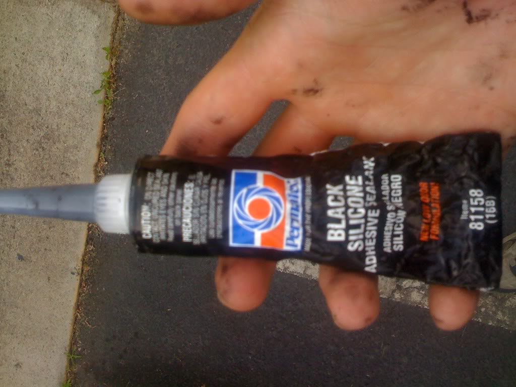

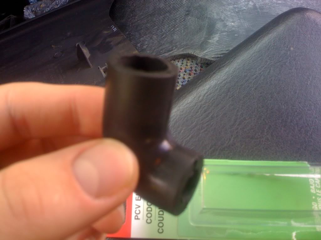

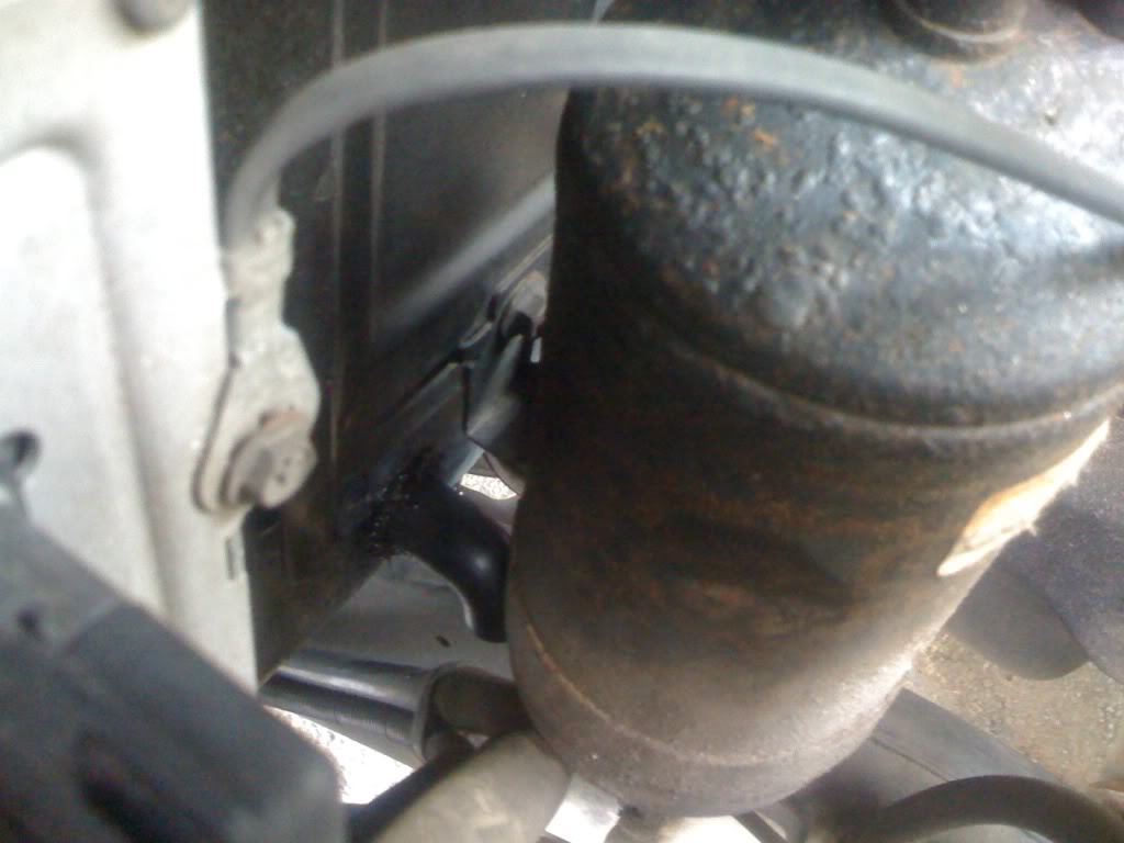

well i was wiggling it bc i THOUGHT i had to remove the piece and put in the turn down. i think i figured it out. got pics...simple pics but everyone loves a pic
went back to AZ and looked all over. found this PCV rubber 90* vavle in the OEM section. i didn't know if i needed a hard plastic or what...it seems like it should work

the sealant i used on the firewall...

here is the firewall after all...looks like it should work, hoping it will

perfect. now use the water hose and soak down the door and 3rd brake light and cowl area and make sure its not still getting wet inside.

There you go! Yeup, definitely keep hosing everything (except a/c drain hose) to see if your getting any water.
